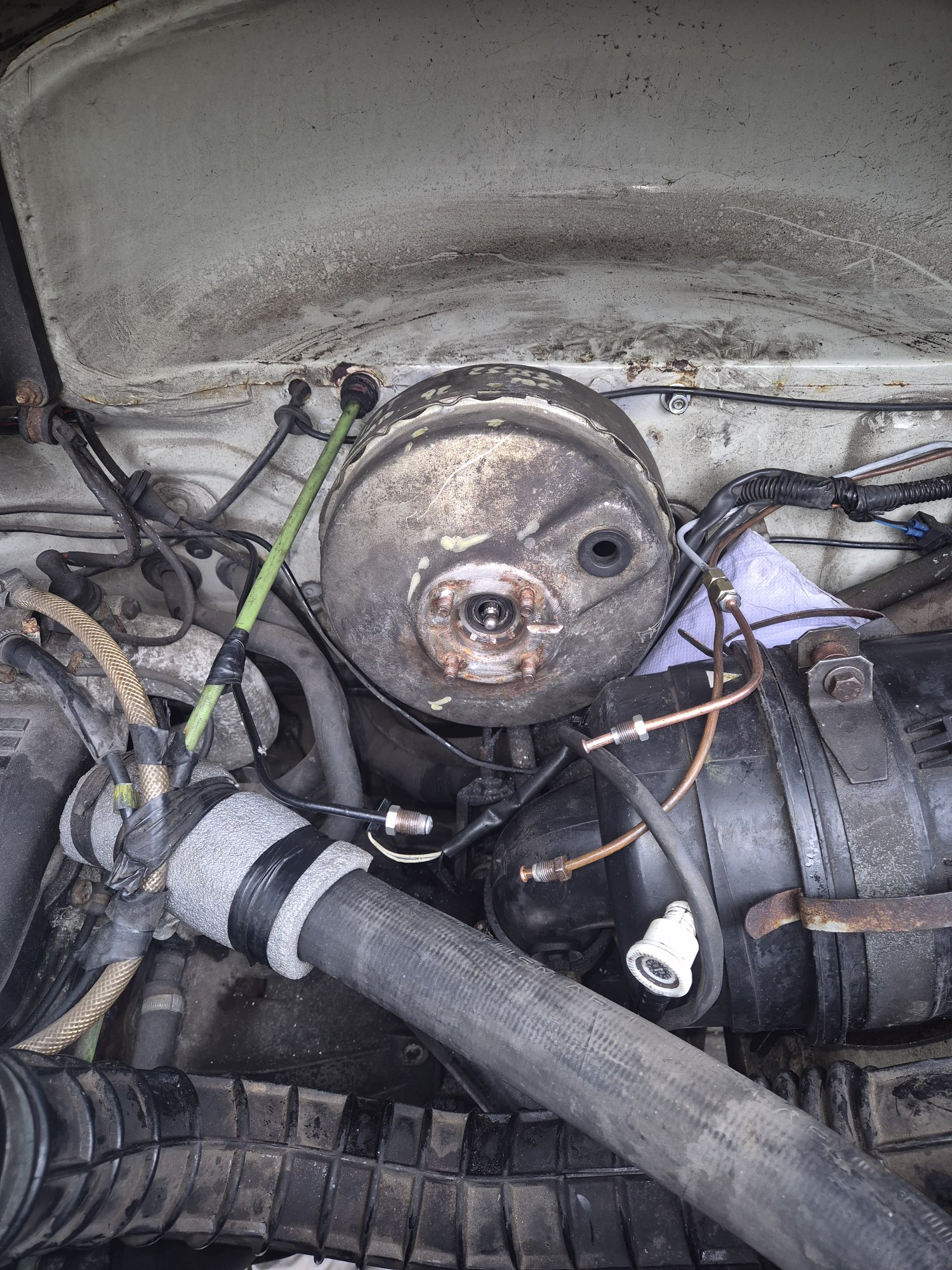

long time since I messed with one but I think it does comeout easily.

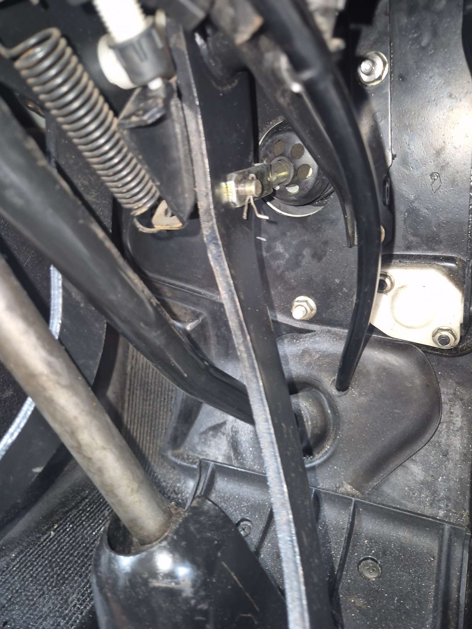

The bolts went though the bulkhead and intonthr pedal bracket .I didnt realise it also had nuts on thr bokts behind the pedal bracket .as videos of all the other boosters just had 4 nuts holding ithem on by pedals..trouble is apparently you can't get the parts to service them .I fail to see how a motorhome can be scrap due to a faulty brake booster .?

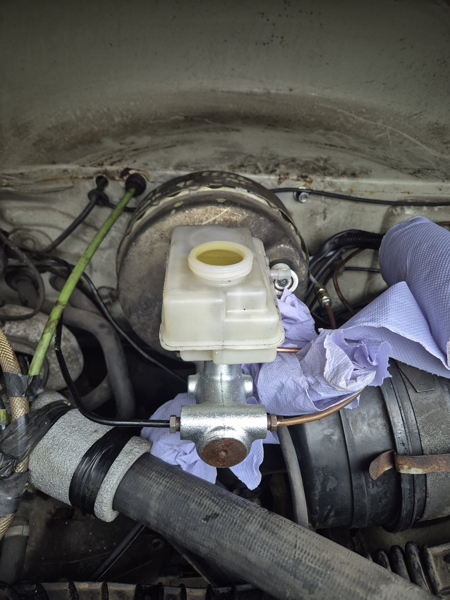

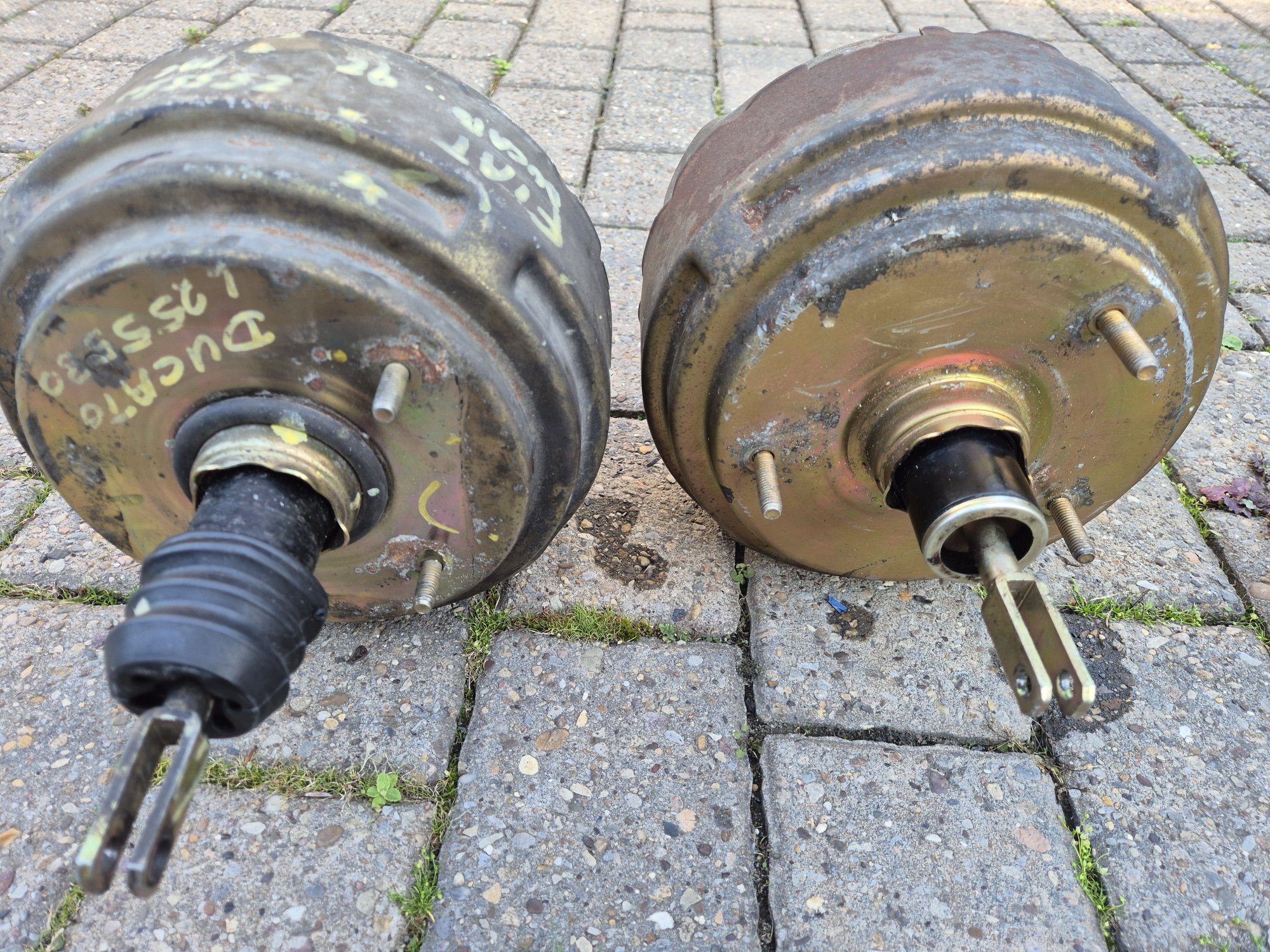

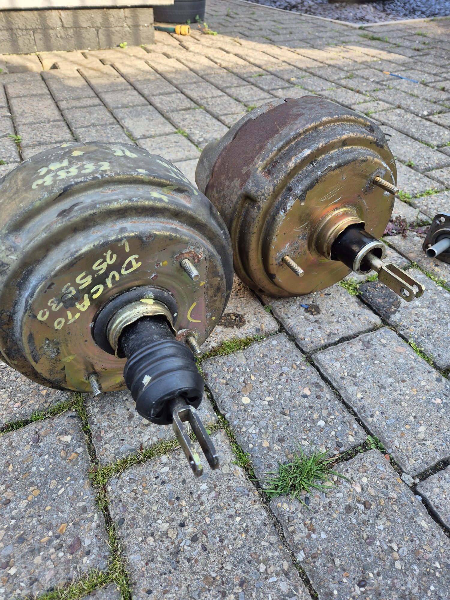

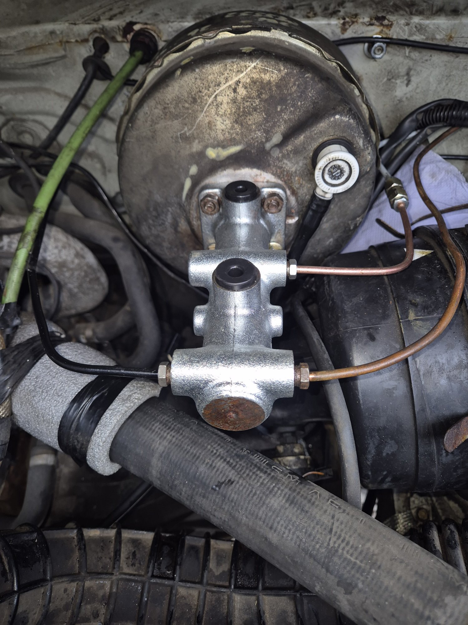

Update managed to find one in Italy. Its arrived but bolt patterns different. looks like it used to be a four bolt one but someone grinded a bolt off .unfortunately the one they cut off was the one I needed
So tomorrow I will try still another hole through bulkhead and pedal plate
No guarantee its any better than one I removed .but times running out for hols

Do.i drill another hole.or.extend the bolts and space off bulkhead the same difference new ones longer
It's not very often I'm wrong, but I'm right this time ;) ;)
If yours is the shorter one, then not a problem, or if I recall, they just pull out.

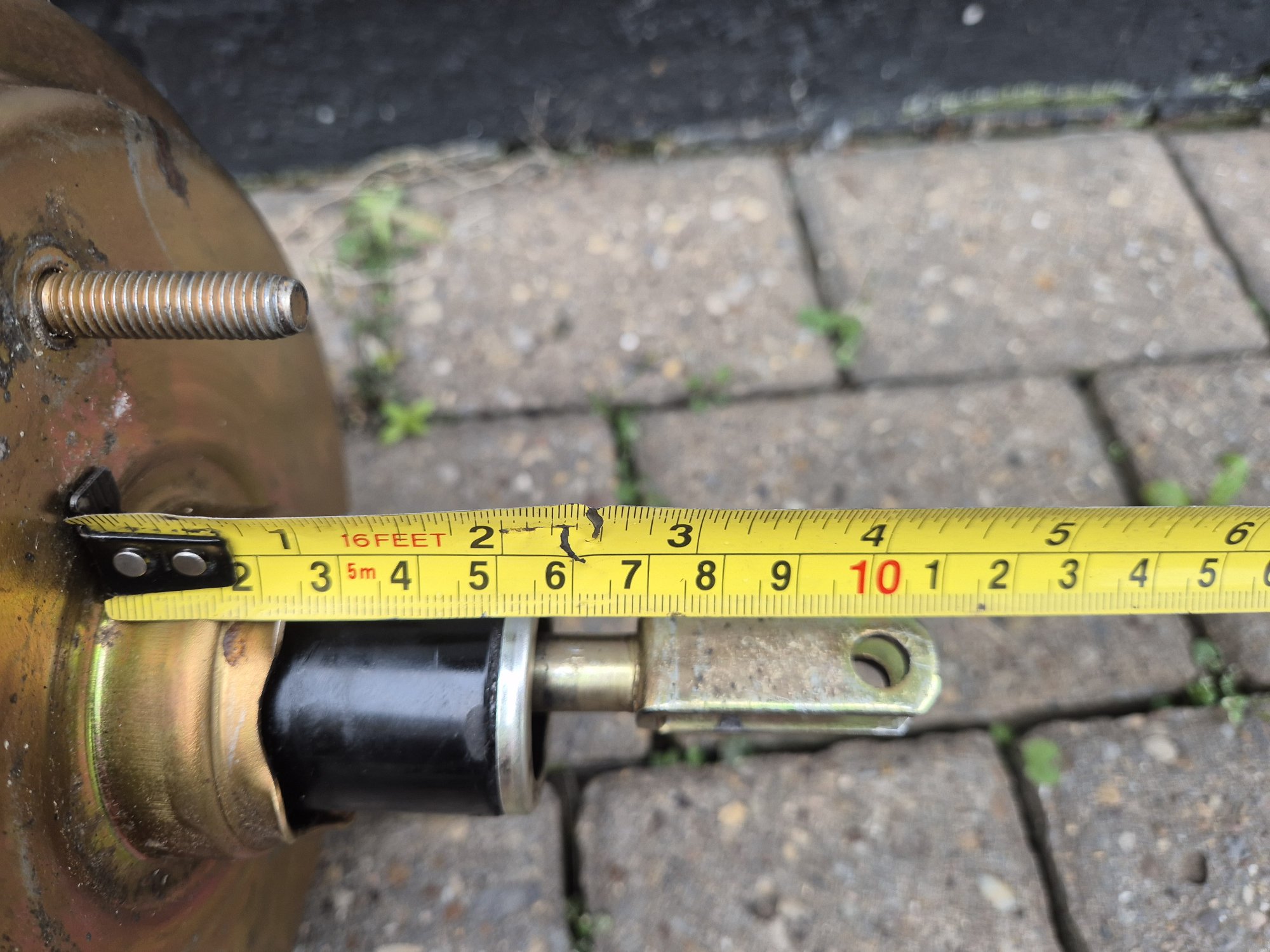

New ones longer old one i took out is shorter so i guess if I left it as us the brake pedal will sit the difference in height ?
Can you swap, or shorten it? or get someone to do that.
Is the lack of the stud a problem?

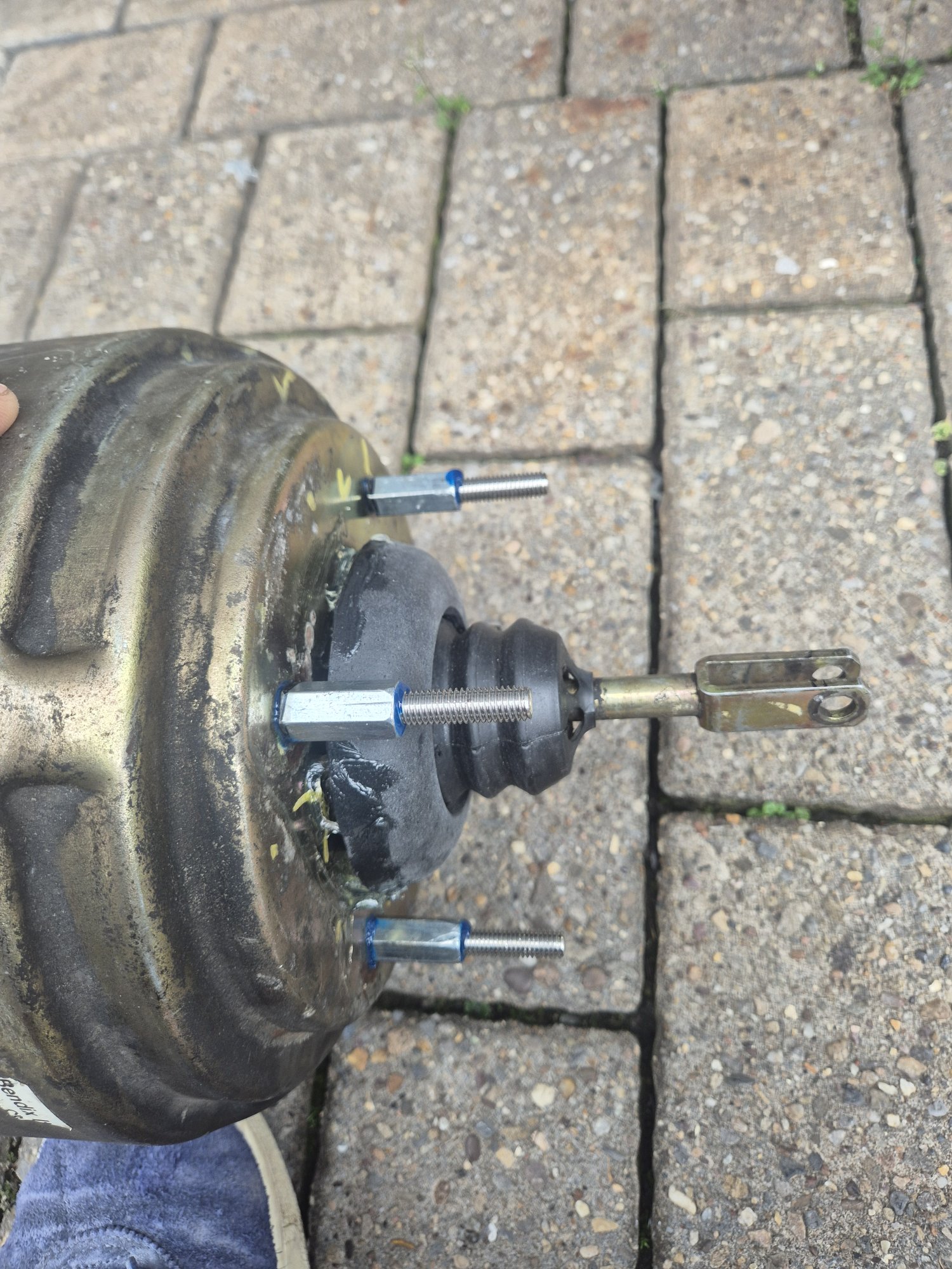

So when the servo arrived from Italy it had a different bolt pattern so some mods were required .the shaft to the brake pedal was 25 mm longer also..extra holes drilled through bulkhead and brake pedal for different bolt pattern
So I had ro cut the threads shorter .I then used bokt extensiond cur down to 25 mm ( the difference on the shaft. ) i them pit some longer studs into the extensuons ..I also uses a 25 mm doughnut seal off a toilet on .tonteplqcw the tninner gasket ...the hole in the shaft lined up perfect to the hoke in pedal..job sorted .unfortunately the part from Italy was worse than the servo I took off ( alot of work for nothing )..back to the drawing board ...not through lack of effort
