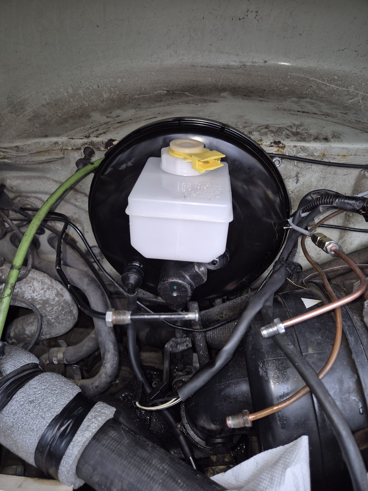

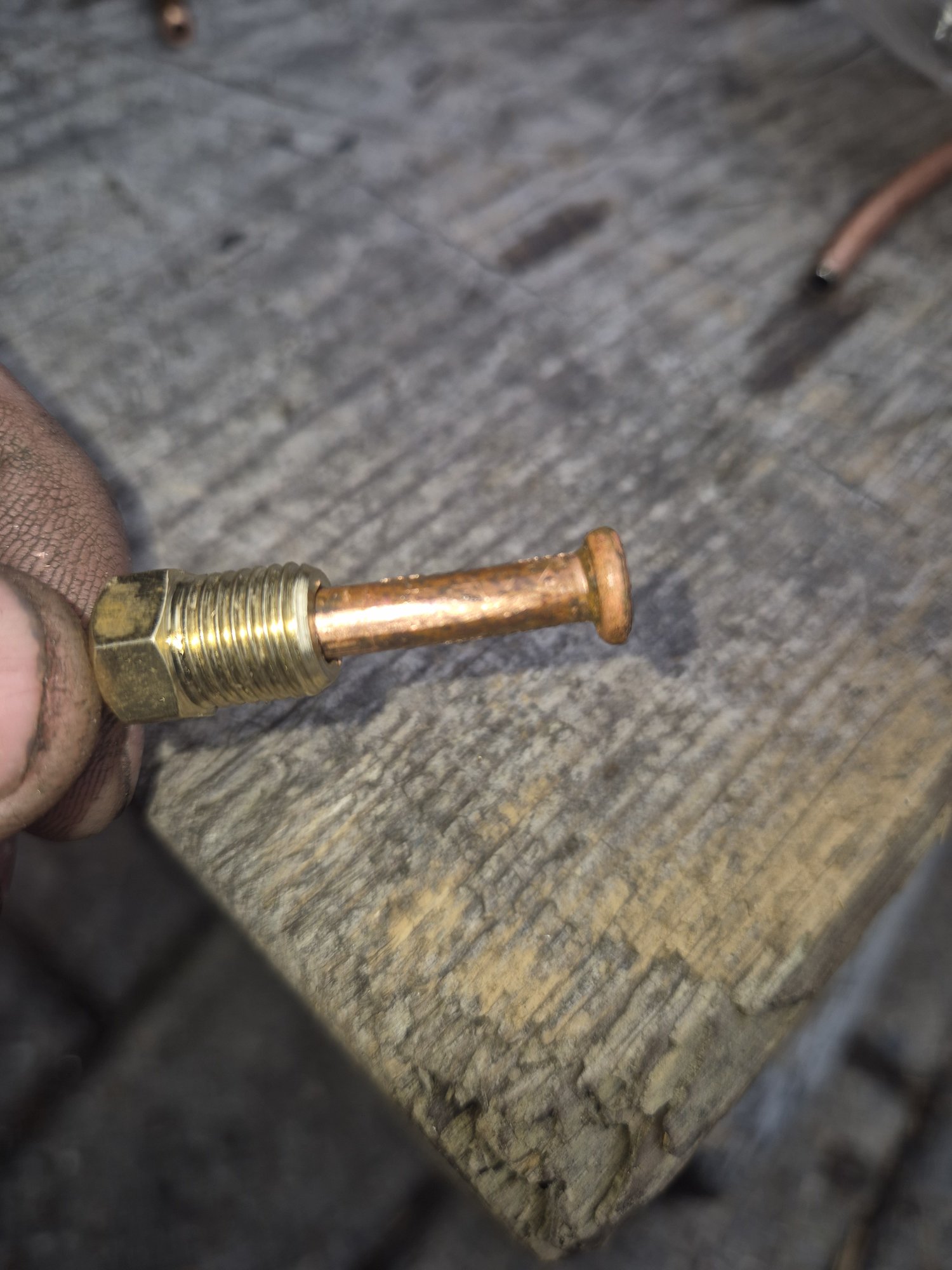

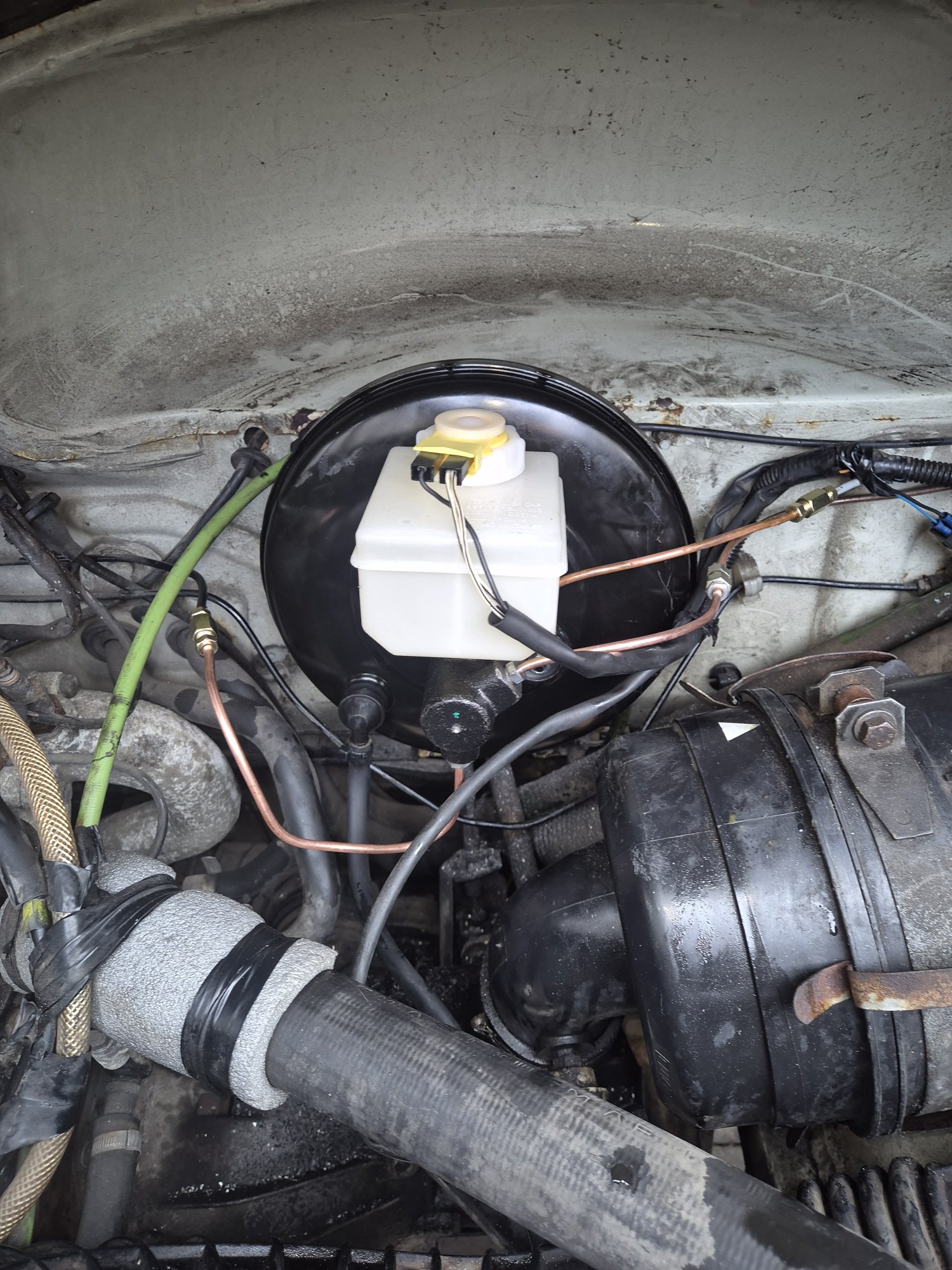

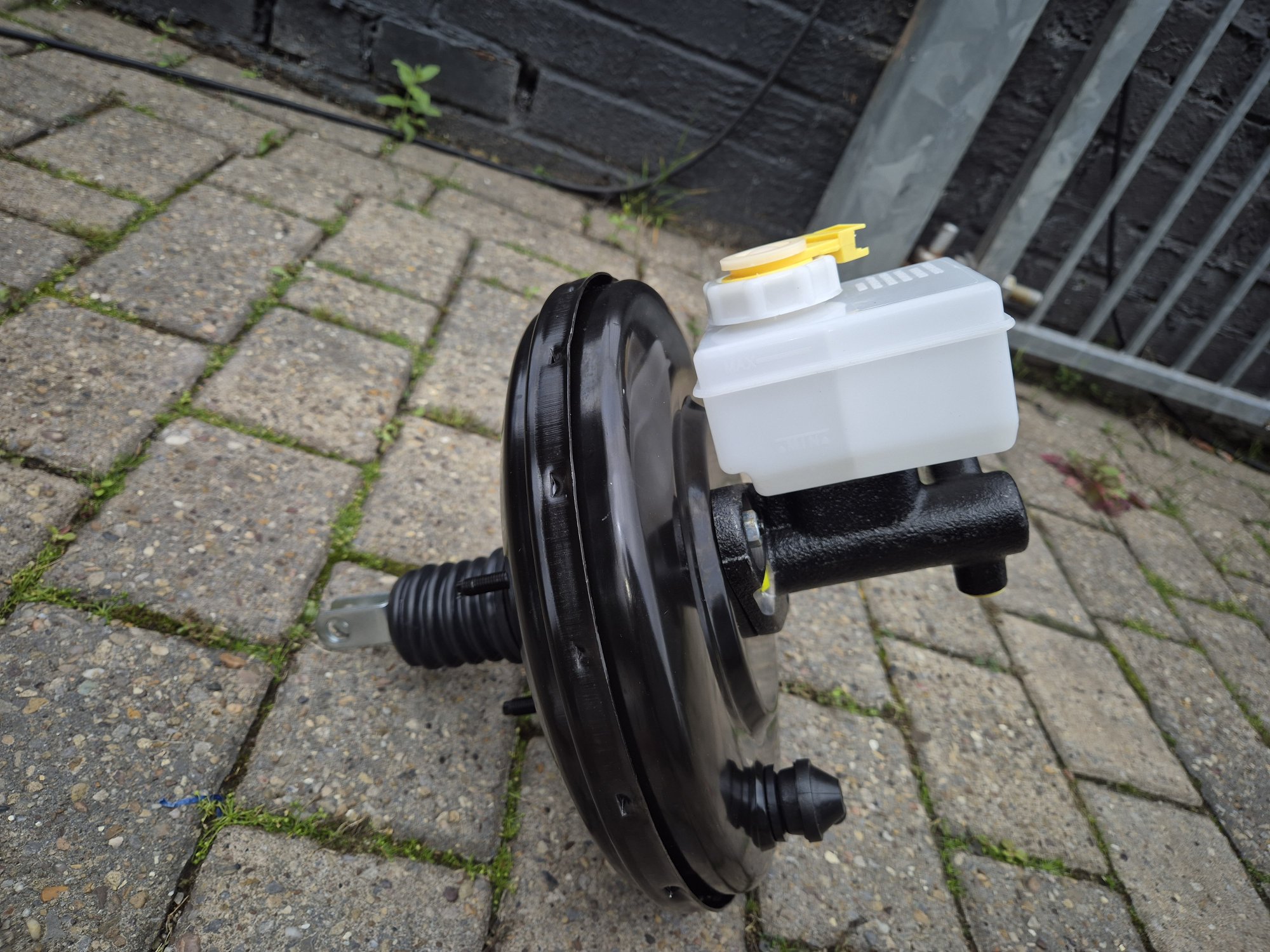

Update!!the holidays back on...installed a landrover 300 tdi servo and master cylinder
Just took o. A 30 mins test drive .all works well .had to drill the brake peddle hole out bigger and
Re drill bulkhead .I cut the threads shorter then put some extender on and longer bolts .alterd the brake lines into.new master cylinder .jobs a good un .she stops well.👍👍👍

I knew there was a cure, not that much between the in operation just the fitment.
Well done Cock.
Well sorted, there is always a work around, finding it is the problem unless someone has done it before and passes on the info.
So the holidays back on ..i ended up using a landrover 300 tdi pre abs .brake servo and master cylinder..i drilled the brake pedal for the larger pin clevis .re drilled bulkhead .extended the bolts on the servo and re piped the brake lines .all good and working great thanks for everyone's help with this .much apteciated
