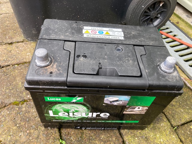

Went to bed tonight and a short while ago became aware of this unusual, very, very faint and muffled, intermittent beeping.
Started to try and track the sound down. Checked all the house alarms, smoke alarms, clocks, phones, kitchen timers, you name it.... no joy. 🤷‍♀️
Finally realised it was coming from outside the house and eventually I tracked it down to the camper.
Dragged a reluctant Neil away from the football(!!) and opened the hab door to an overpowering smell of rotten eggs and a (now pretty loud!) carbon monoxide/gas alarm.
Turns out it was from the duff leisure battery which Neil has had on charge (unbeknownst to me!) for gawd knows how many days since I got back from Harrogate a week Saturday. It was red hot!!! 🔥🫣😬 👿
Neil had now disconnected it and removed it from the van entirely.
He went straight back to the football - as all you folk who are obsessed with such things do 😝 - while I recovered from the shock of what could have been a close shave....? 🫨🥴
I'm pretty ignorant on the subject of batteries generally, so I googled "rotten egg smell" and "batteries" straight away:-
"When a battery is overcharged, it can cause gases that escape, and the sulfur in the battery emits a rotten egg smell. An overcharged battery is not only smelly but can also be dangerous due to the risk of leaking acid, not to mention the risk of explosion from hydrogen gas."
One positive is that at least we know the gas detector in the van works effectively!
A second positive is that I actually heard the alarm and possibly avoided a nasty outcome...?
A third positive is that now this duff battery is definitely fried he can't object to me replacing it ! 😊👍

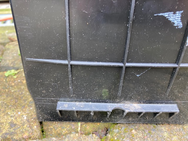

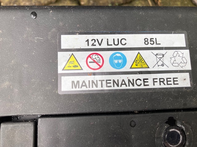

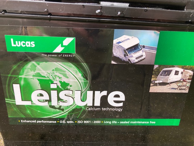

The current burnt out leisure battery seems to be smallish lengthwise? 🤔 🤷‍♀️
It also has some "lugs" near the bottom at either end where the metal plate it sits on clamps onto.
Measurements:-
255mm long
170mm wide
198mm high
Measurements:-
255mm long
170mm wide
198mm high
Photos:-
You are going to struggle to get anything larger than an 85 in at that size. It did look to me like there was possibly a bit more space though if you could change the mounting plate.
Alphas site lists all the measurements below each battery.
