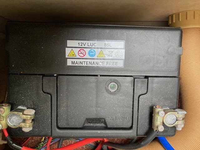

Existing (fubard!) battery.
Neil tested the charge when I got back home last Saturday night. Was reading 13v.
Sunday it had gone down to 12v and today it is reading 10v, so definitely losing charge.
Neil's disconnected it earlier this morning to see if it continues to flatten.
He'll check it again when he gets back home this afternoon.

There is space, I think?
But the battery sits on a metal plate which is bolted to the floor.
Is this is a standard sort of setup?
Guessing the current restriction for a replacement battery would be the size of the metal base plate it sits on? 🤔🤷‍♀️
You definately have a size limit there with the heating hose.
The battery also looks fairly small. Be worth measuring the length and the depth(width) of the current battery and also from sides to hose in both directions to see what could be possible, AND the height of the enclosure as well to see what limit you have there.
