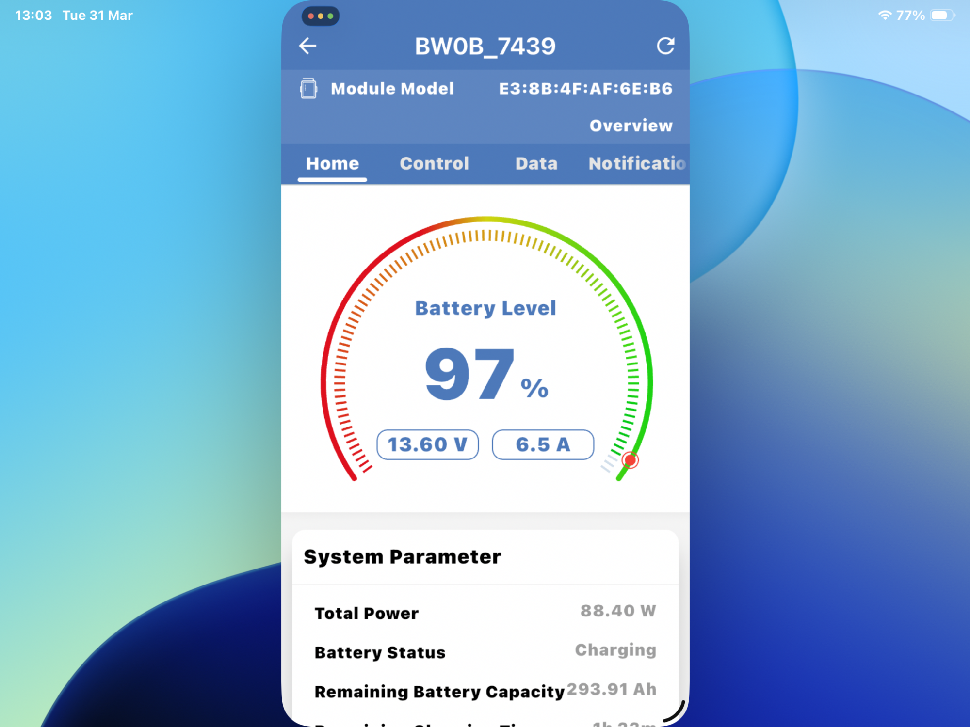

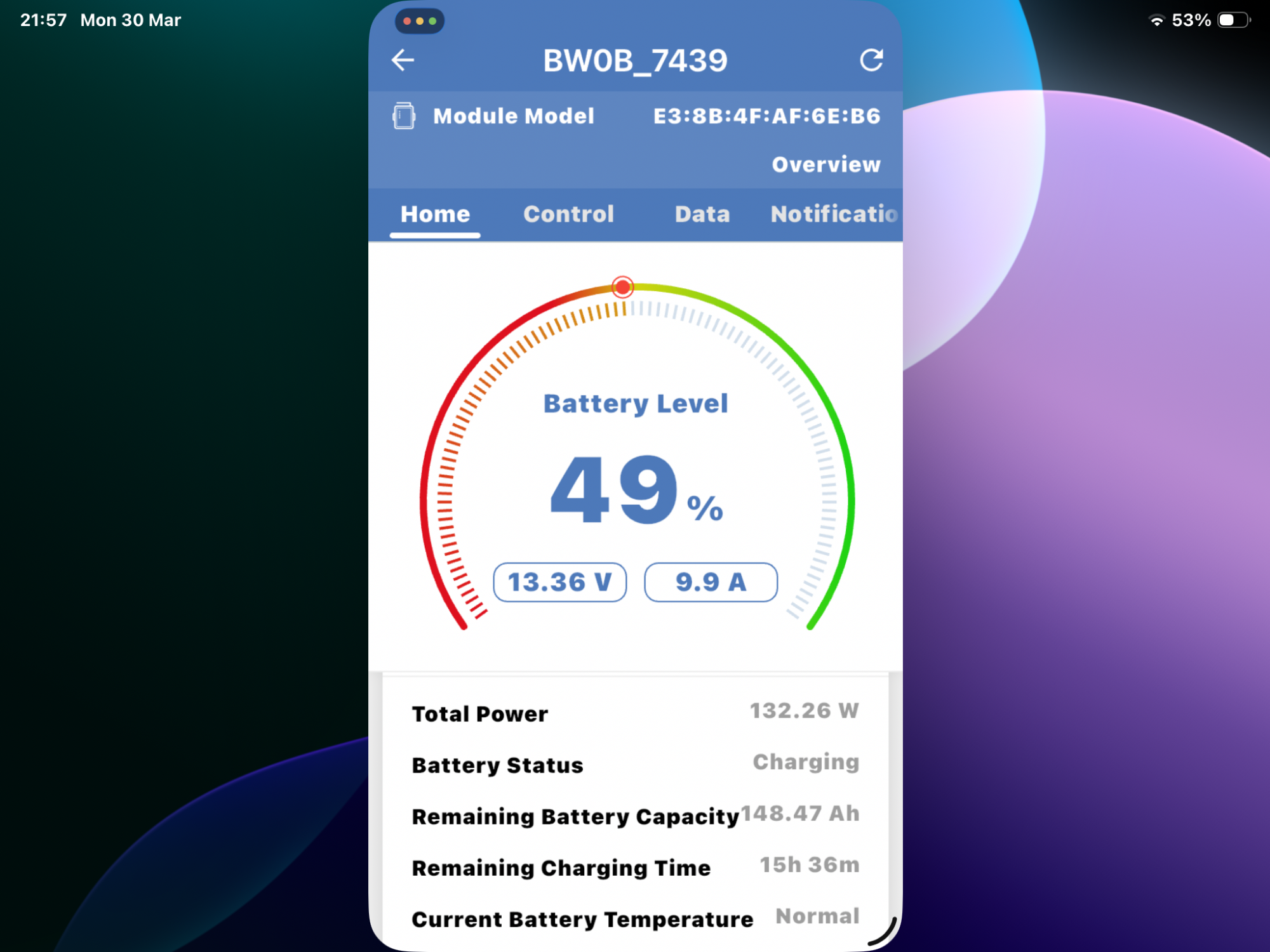

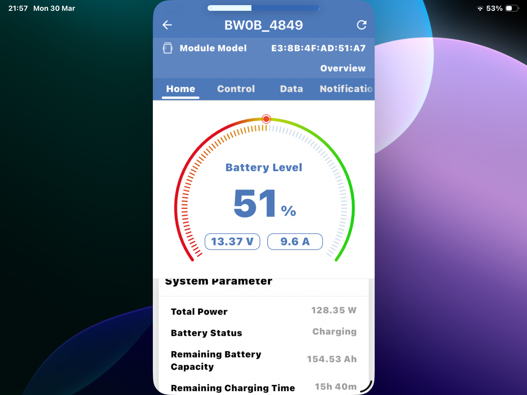

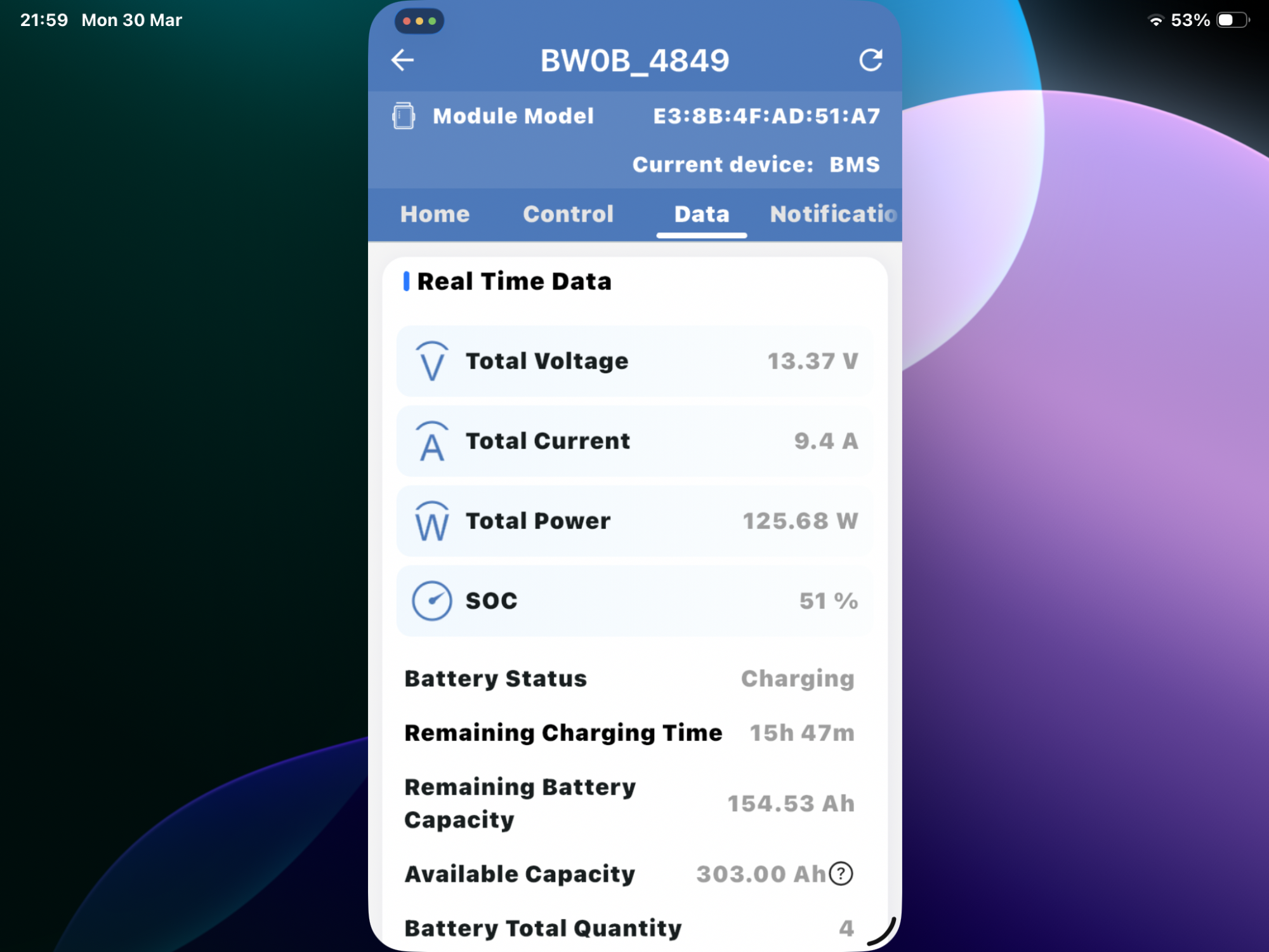

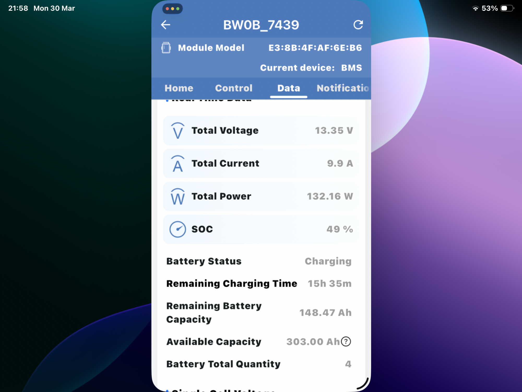

Right I fitted the batteries today two 300amp eco-worthy lithiums. I think I done alright getting them in and wiring up
Now they came with a 25% charge. I have the van plugged in to the house on a 13 amp socket. It’s taking forever to charge these is this normal for the way I’m charging and just down to the large capacity of the batteries. Do I need to upgrade the battery charger or is this down to the supply from the mains being low.
Charging current seems low to me Wully if it's at 9Amps.
But I'm probably the last person to ask so wait until Merl or David come along! :)
Now they came with a 25% charge. I have the van plugged in to the house on a 13 amp socket. It’s taking forever to charge these is this normal for the way I’m charging and just down to the large capacity of the batteries. Do I need to upgrade the battery charger or is this down to the supply from the mains being low.View attachment 150891View attachment 150892View attachment 150893View attachment 150894
It'll have nothing to do with the mains supply Wully.
What mains charger do you have? Looks like a 10A charger? Or maybe it's a more powerful charger and somehow it's been turned down? If it is and your 600Ah batteries came 25% charged then you've got to get 450Ah into the batteries at just 10A means you're looking at 45 hours to achieve that and a larger charger would be sensible.

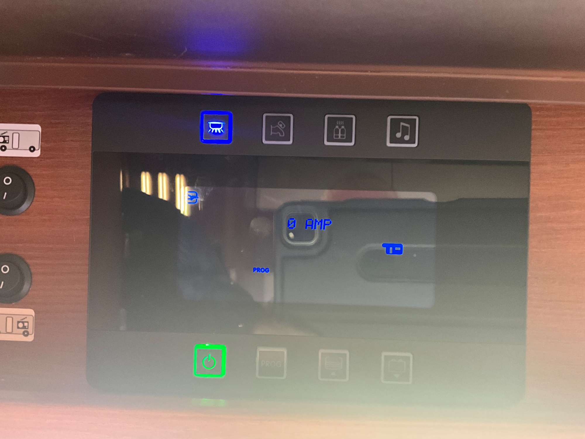

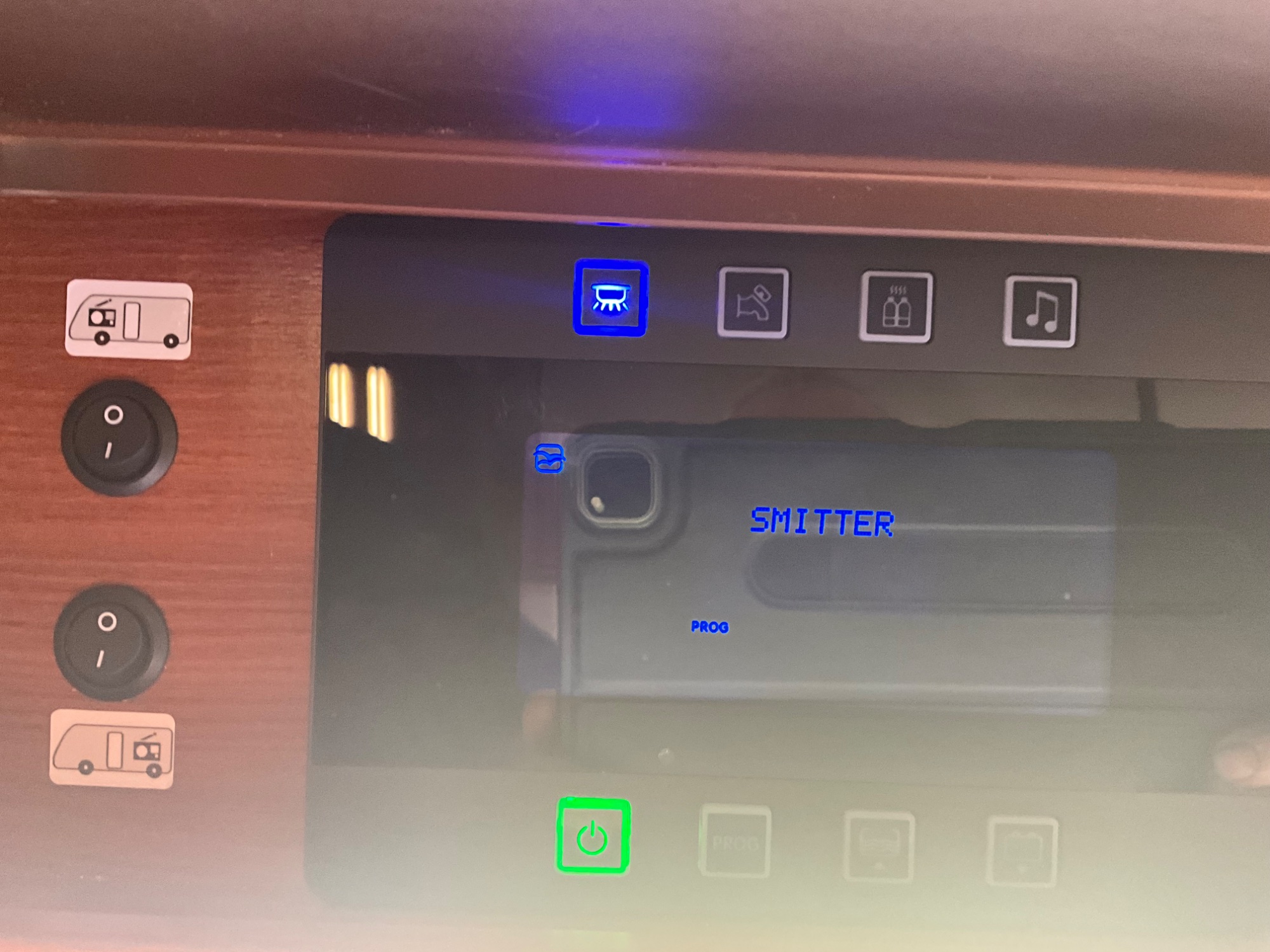

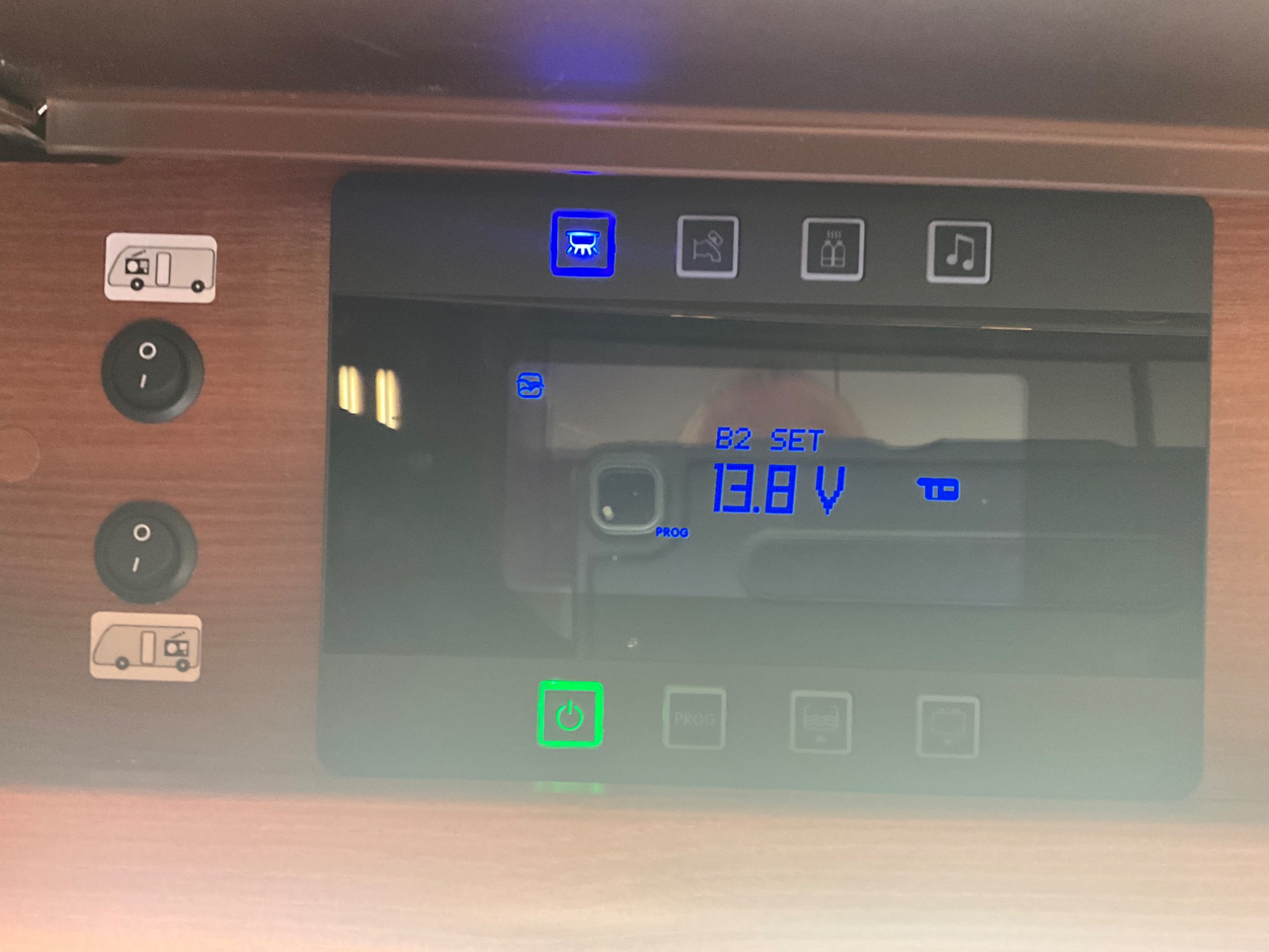

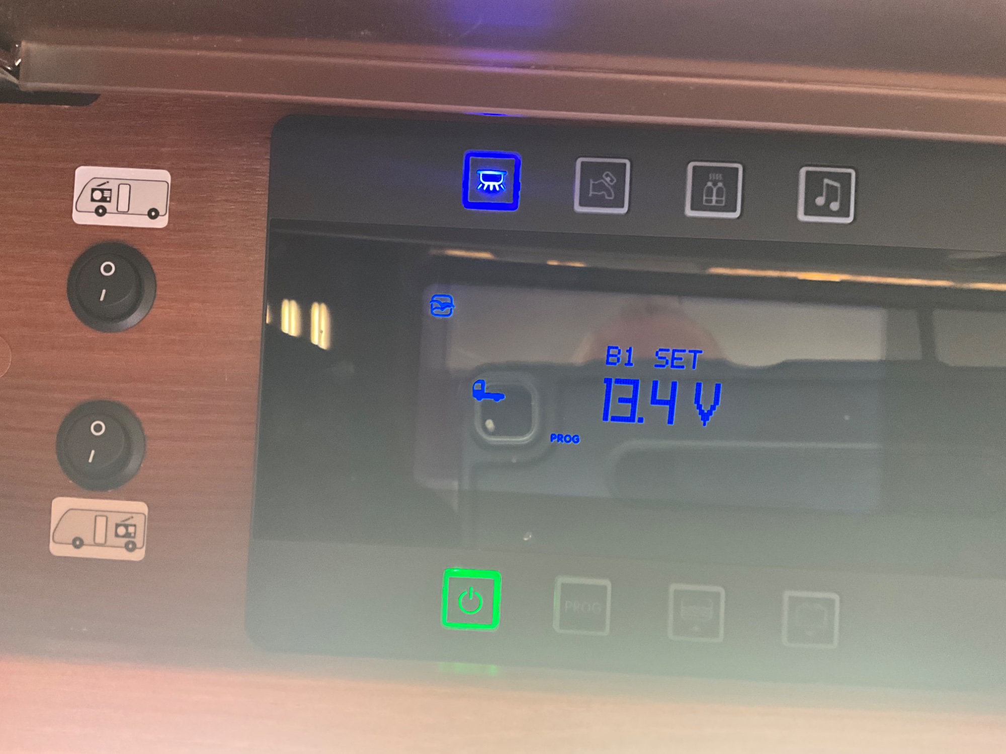

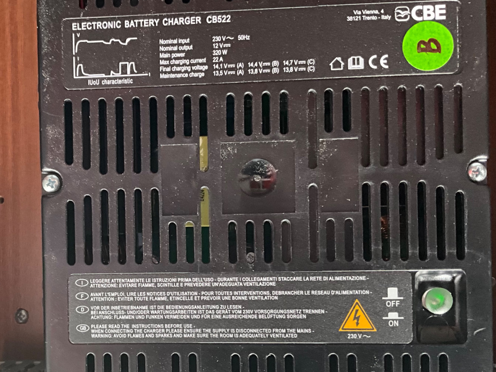

Hi Merl here’s a photo of my vans charger. Looking at the electronic panel above my door it looks like there’s a sub menu for charging settings . I’ll take a photo of what they are at. I plugged it in yesterday at about 4pm it’s now at 97%
Here’s some photos of control panel and what it’s set at these can be changed from board.
Without a poke around and taking measurements with a DC clamp meter it's hard to say what's going on Wully.
The charger is supposed to deliver 22 Amps BUT according to the manual it goes into 'standby' mode after ten hours. Not sure what standby mode entails but it could equate to the 10 Amps that was being displayed on the images of the App?
You'll have to make a judgement as to whether your existing mains charger is up to your requirements and get it swapped out for a higher power model if need be.
Someone will be along soon to tell you that the charger is intended for lead acid batteries and you shouldn't be using it for lithium.... don't worry it'll be fine. Set the battery type switch to the upper setting (PB) and don't leave it running for days on end once the batteries are charged and you'll be fine.
