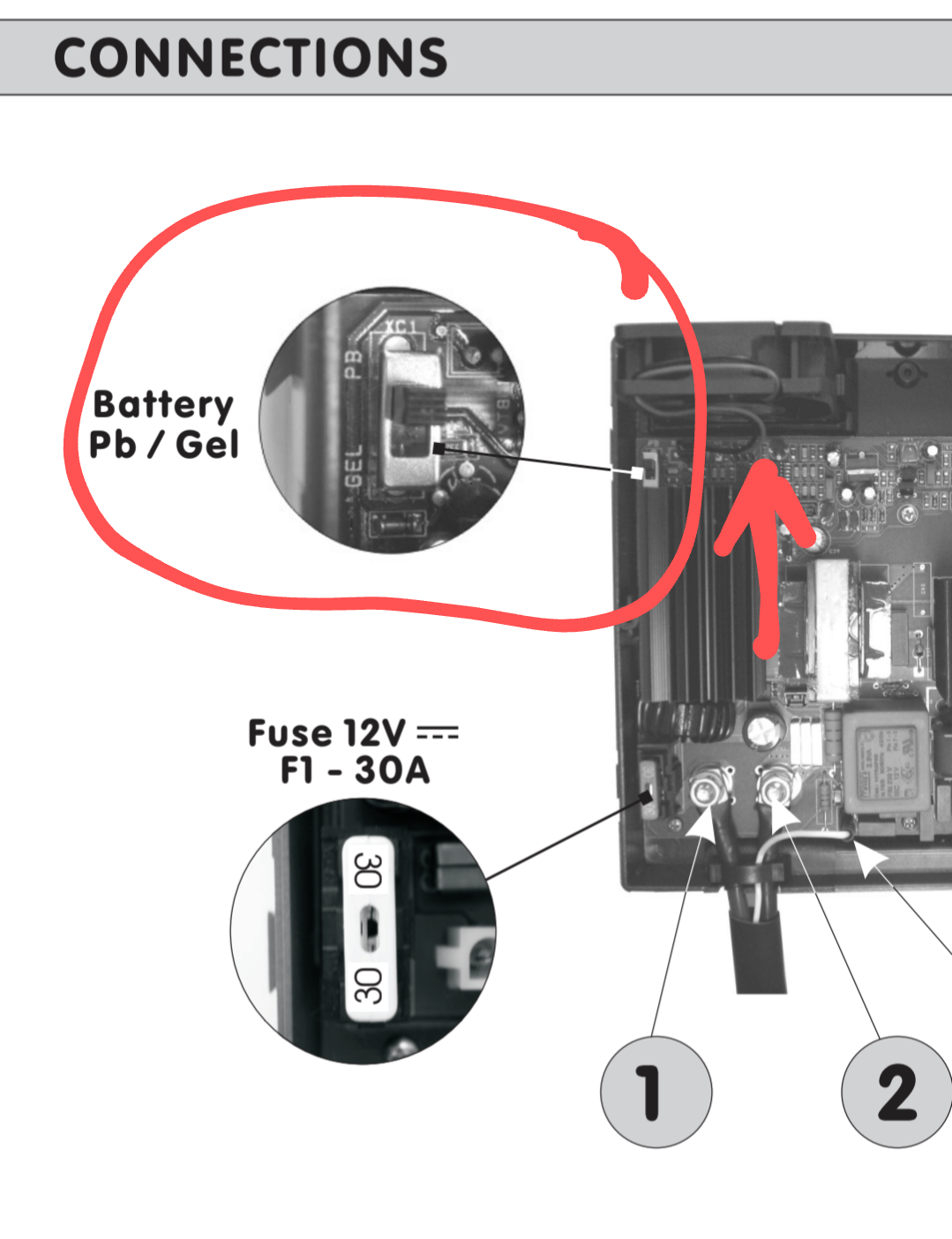

Someone will be along soon to tell you that the charger is intended for lead acid batteries and you shouldn't be using it for lithium.... don't worry it'll be fine. Set the battery type switch to the upper setting (PB) and don't leave it running for days on end once the batteries are charged and you'll be fine. View attachment 150906
Cheers Merl done as you said. I’m just running a test put everything on in van to deplete the batteries down below 90% before I plug the mains back in. I’m just wondering these batteries hook up to the Bluetooth app individually and seem to be running as two separate entities on charging and discharging with a bit of electronics. I wonder if that 10amp on each battery would double up. Sorry if this sounds daft but I’m as thick as chit when it comes to this. Van had two 100amp gel batteries I just ran all cable as they were attached to these. I have a victron shunt and the BMV battery monitor should I connect this for a better reading of the overall state of batteries. I’ll get you a big pint when I see you next. Promise 😁

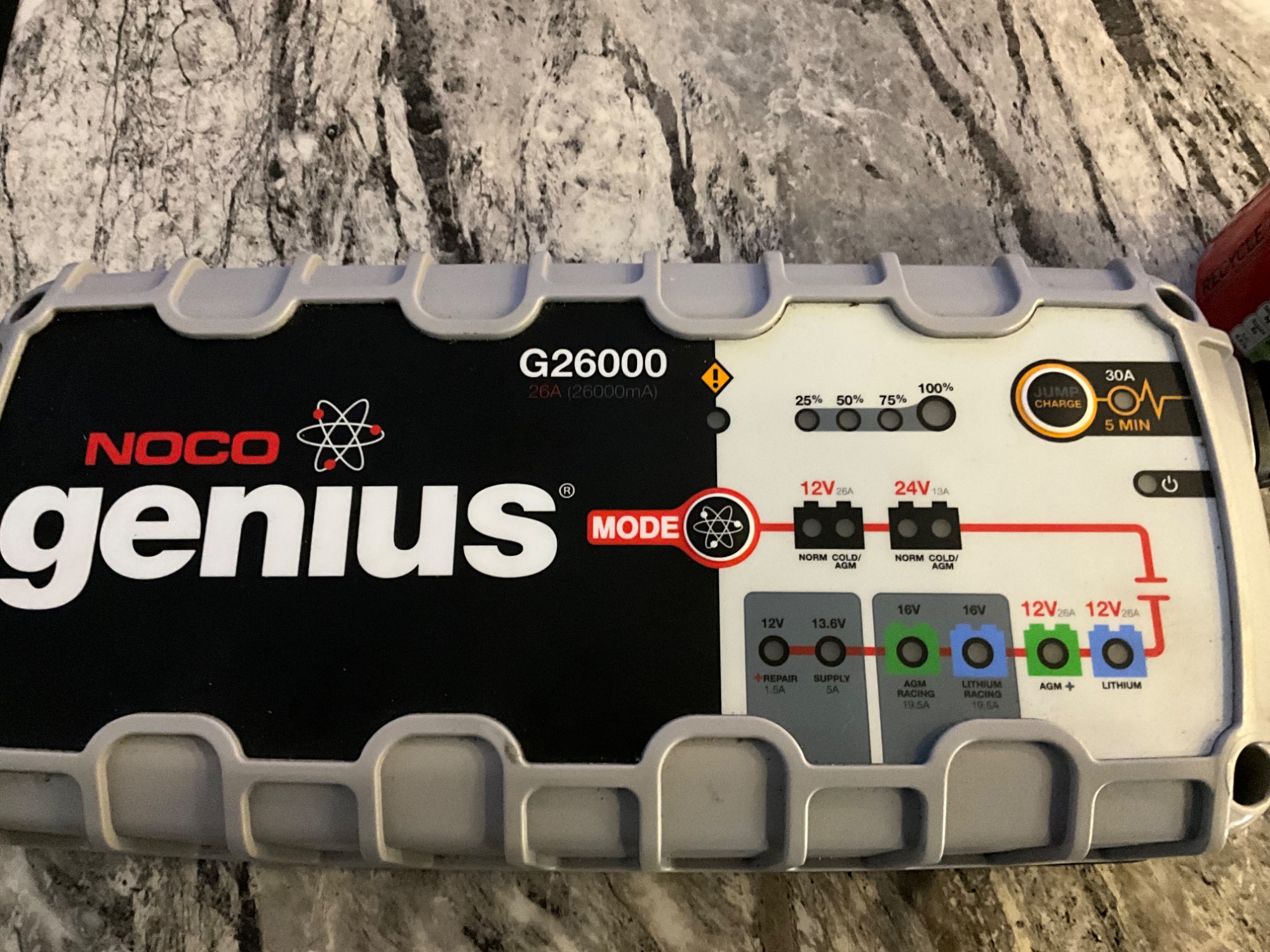

I noticed that too merl and wasn’t sure which one was right so I set it in middle I’ll change it tomorrow. I also had this bad boy charger in the loft after you mentioned another charger I went amd found it. I’m a bit of a hoarder and bought this from another member who had it for a large truck. It’s a bit of a monster.
Took a look at the spec briefly and it has multiple battery settings including charging 16V lead acid batteries??? The chosen setting is selected by toggling a selection button and being a bench charger you may have to go through the selection process every time you use it and probably not convenient.
