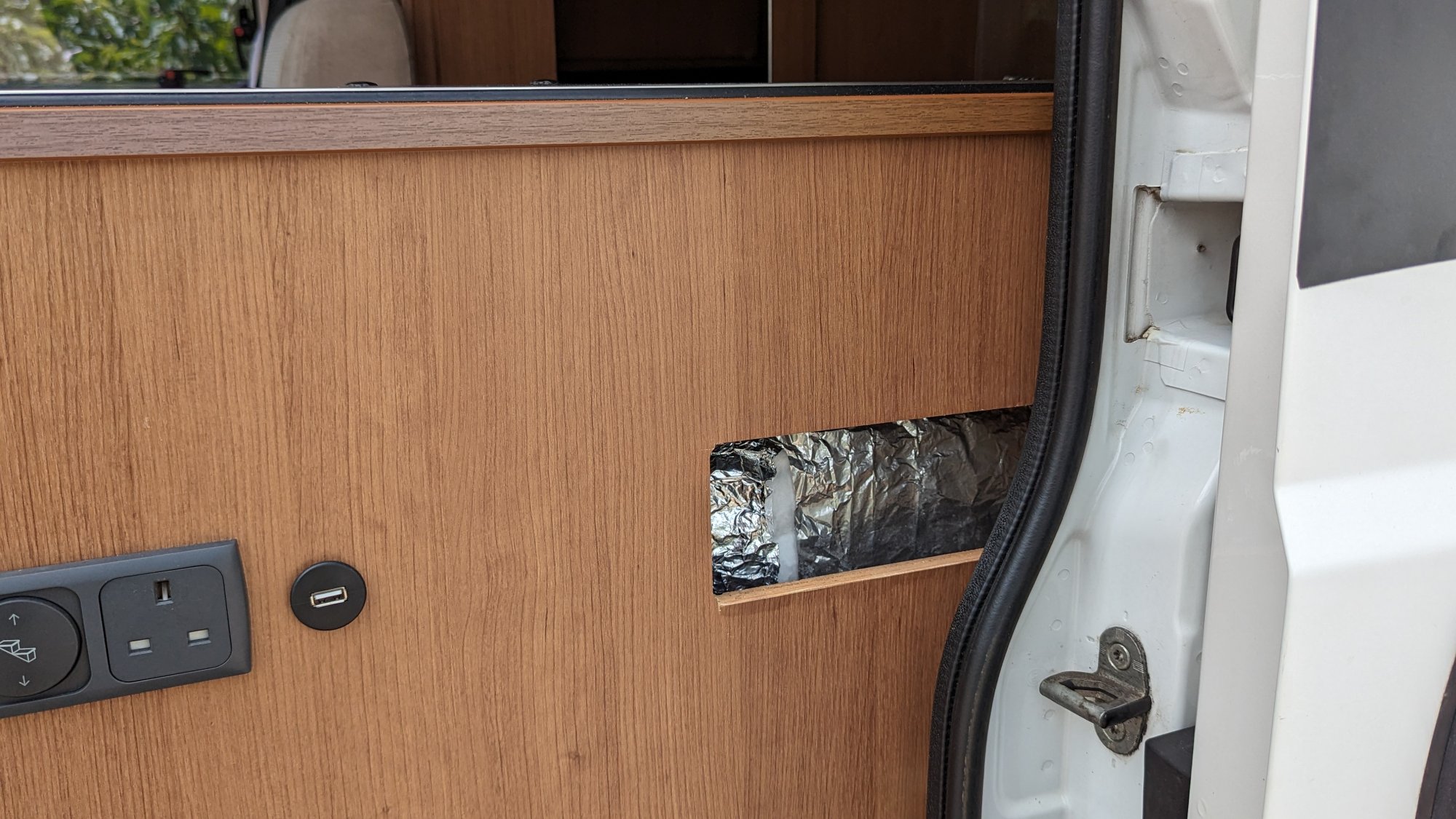

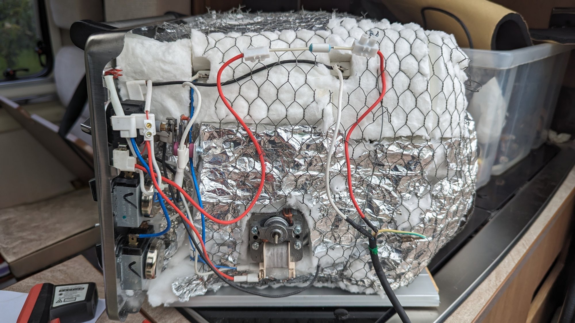

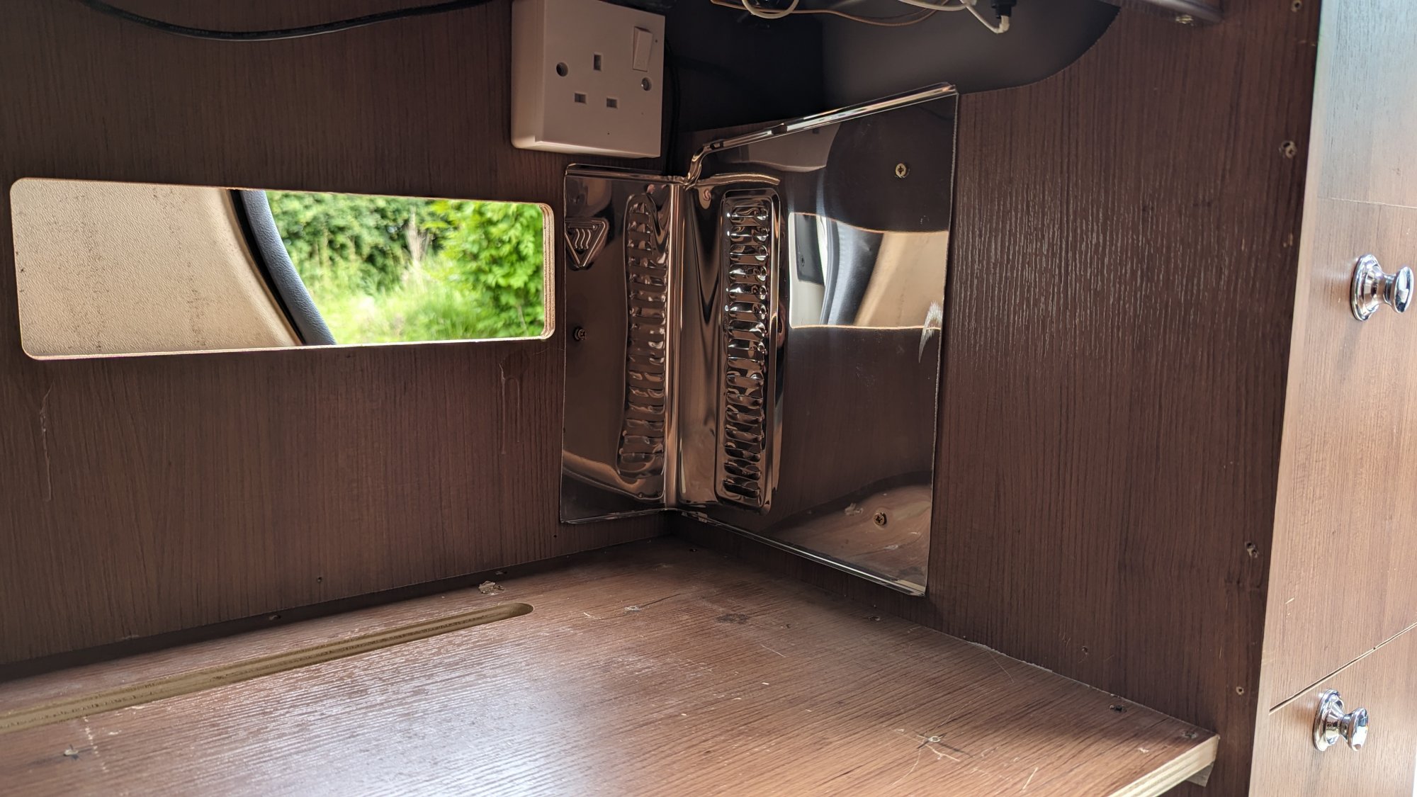

Yes, that vent is original. There's also a vent slot in the shelf supporting the oven and a small floor vent to outside in the cupboard below. The gas oven was wrapped in insulation top, bottom and sides but the rear was left uninsulated, probably because there is a practical limit to just how low you can reliably have a gas flame go so they found it easier to bleed some heat away so they could have a higher 'minimum' flame. It was definitely needed in our case, the hob above used to get quite warm.Looks very nice. I'd be interested in a review a few months down the line to how it is performing.
PS. is that an external vent to the outside from the original oven? Is it typical to have that? I don't have any kind of venting on my gas cooker at all that I am aware off (and I am sure it could benefit from one!)

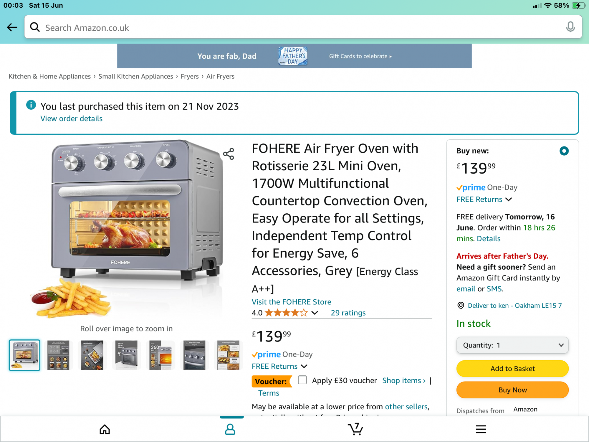

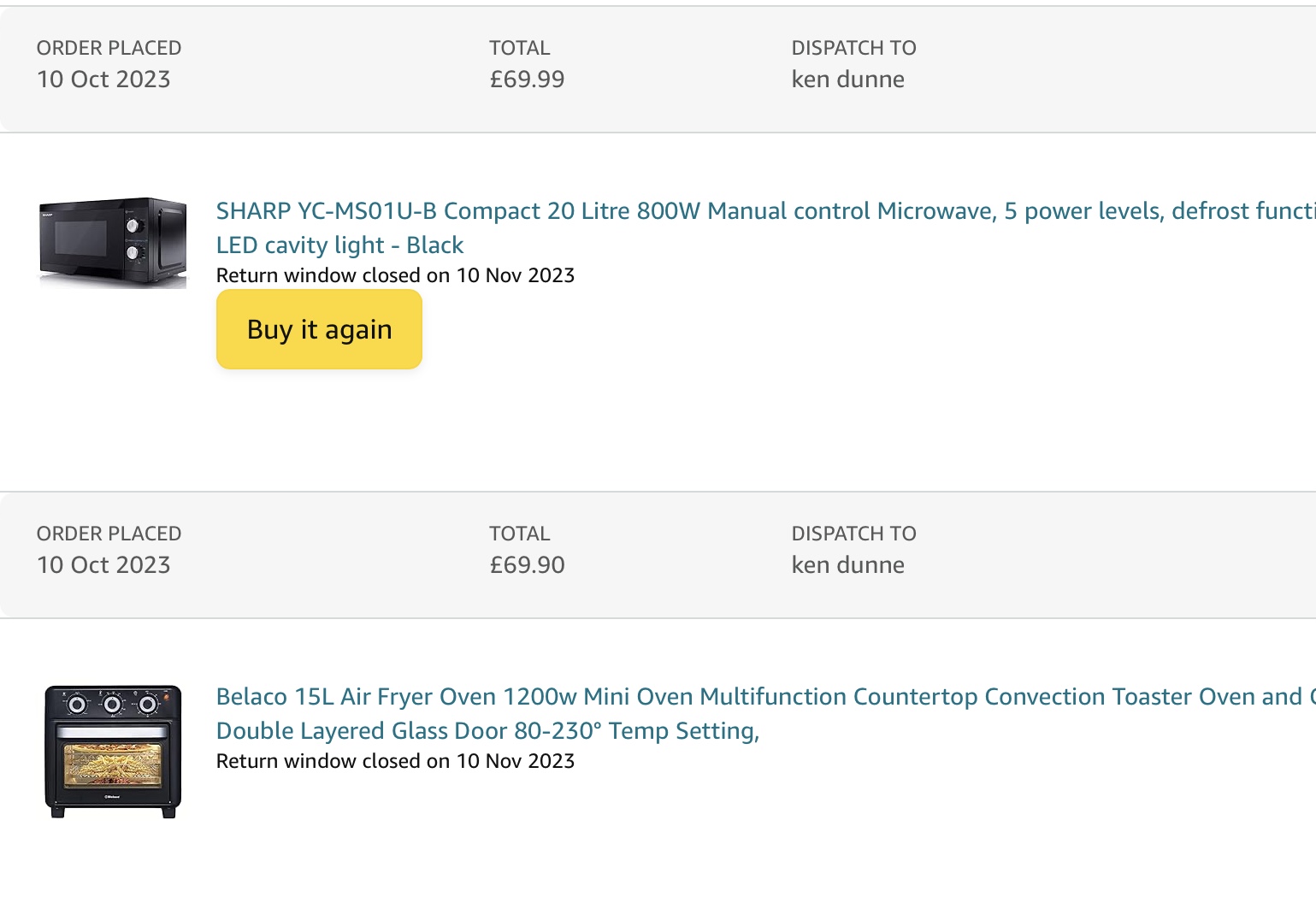

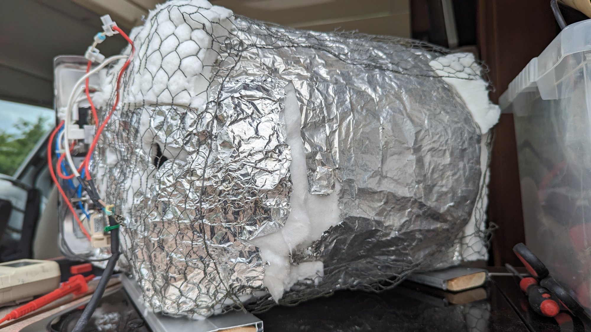

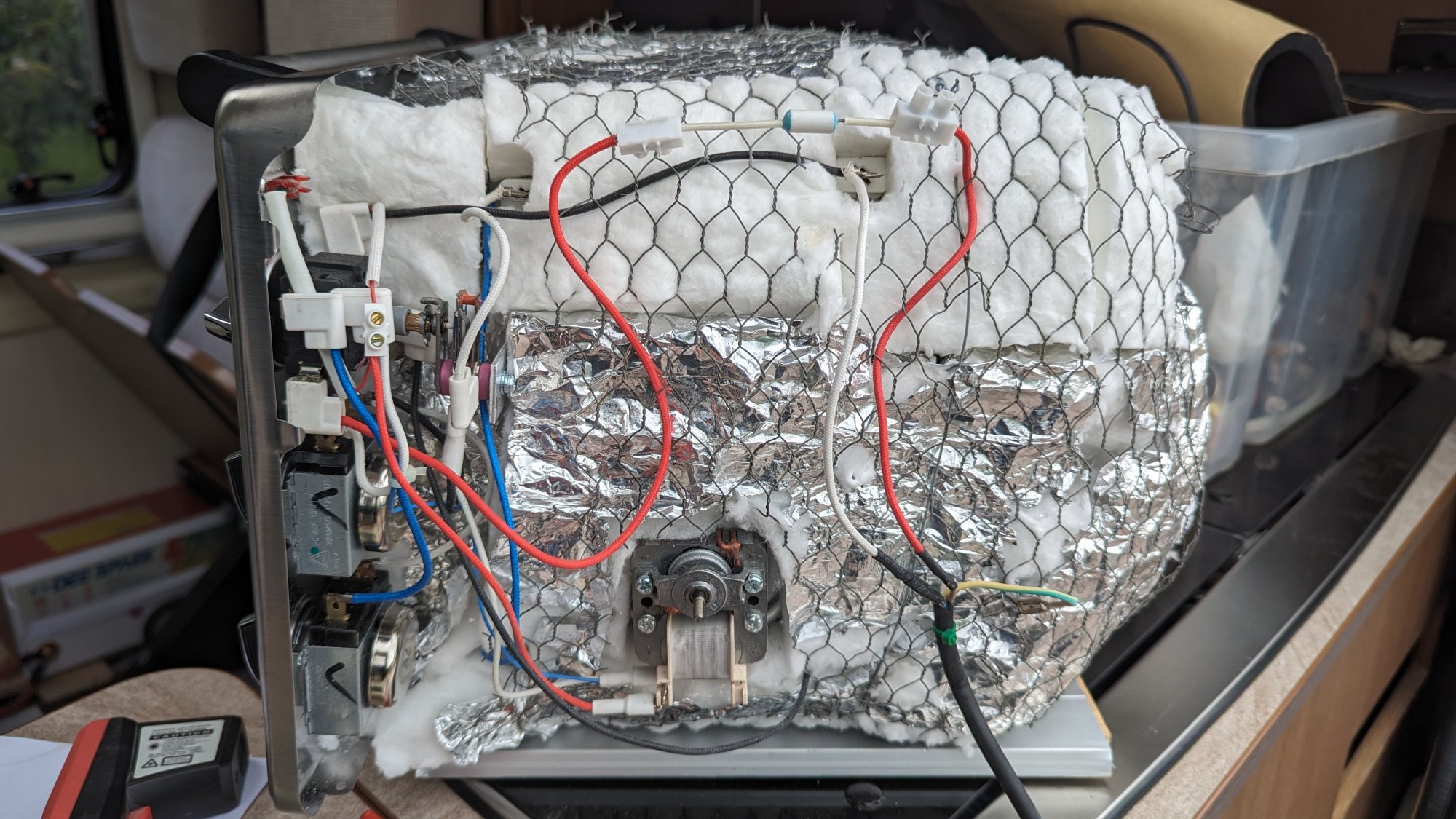

The way your oven works sound pretty similar to the Russell Hobbs.(I've actually tweaked the wiring on mine so that I can have control of the oven temperature AND have the fan running at the same time.david asked for a review of merls fabrication so i thought i’d update my experience these are the microwave i installed in place of the original oven/grill above the fridge freezer and the multi function air fryer oven , firstly the microwave has been good but the oven has been fantastic when i first bought it i used it at home for a couple of weeks it was that good i bought the larger version for use at home and then took the smaller version in the van , it has a pair of elements at the bottom and another pair at the top plus a fan the program allows you to set various combinations to bake you use the bottom elements then air fry uses top two and the fan, but there is a program named toast that has all four elements running and the fan this will halve normal oven cooking times,
this is the one i bought for home it’s 1700w got a rotisserie etc the one i have in the van is only 1200W on toast setting uses about 1% a minute out of my 460 fogstar

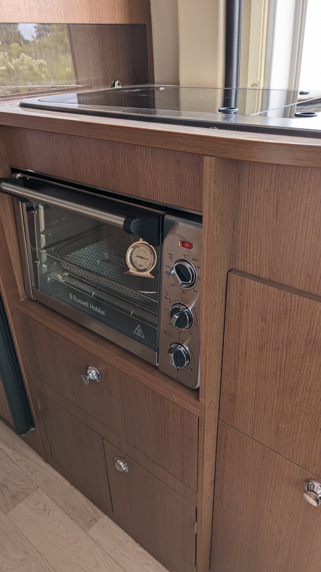

Be interested to know of this is any good, I’m thinking of swapping our grill/oven combo out.Soooo, after much searching it seems a microwave with an air fryer function isn't easy to achieve, Toshiba used to do 3 models but they no longer class 2 of them as 'air fryer' and now call them 'grill' oven, must be something to do with the trades description act! The only Toshiba model left is a whopping 2700W so too much for off grid.
After talking to Bigshug I decided to get the same as him, Russel Hobbs combi oven, it claims the air fryer function and the cooking times and reviews seem to reflect that, it can be used as an ordinary oven/grill (I guess without the fan?)
Managed to pick one up cheap on Ebay via auction for just over £45
I'll add some piccies when I've got the old crappy gas oven out and the new one installed.![]()

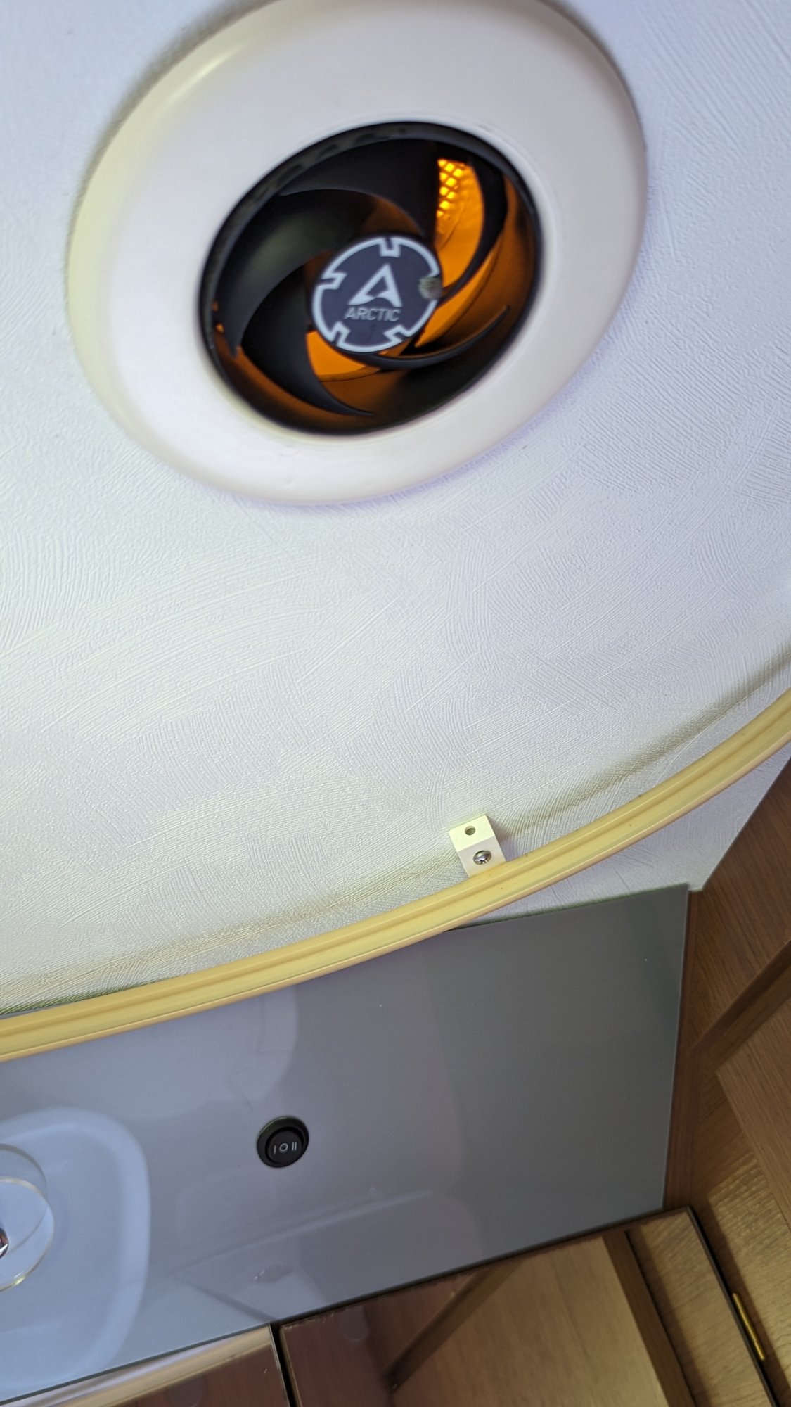

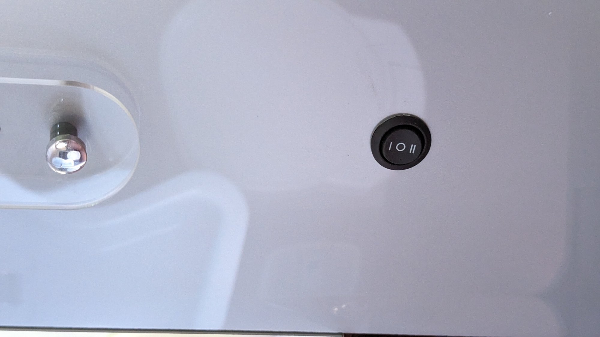

I'm thinking of doing the same at the moment I just have a hole to a roof vent which does nothing. Was it very hard.Fitted a 80mm computer fan into the MH ceiling toilet vent to make an extractor fan, used a 555 to make a 1/2 speed option. Just a couple of months back.View attachment 130706View attachment 130707
