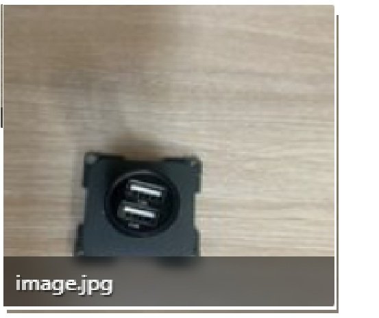

For a few quid you can buy a plug in device that shows the output at a 12V socket. If the socket works then it is your charger that is faulty.
The OP socket is 12dc input, 5v dc out put. (post #7). So this will not help.
he needs a USB volt tester (post #10).
The socket you have shown is 12v DC input and using technical magic it changes thie to 5v on the output side.
You say that the socket is 13,4 volts DC across the input terminals so there are 3 possibilities,
a) The socket is broken and isn't outputting 5v
Get 5v usb voltage tester (under £5)

b) The wire is broken or is data only
Try again using a wire that you know charges a device.
I have done this but no change.
c) The device (phone) is broken,
The device is not broken as it works in other sockets as does the USB plug that the iPhone plugs into.
either the socket is brocken or one of your test results is wrong.

It is a 12 volt socket with a plug-in 5V adaptor (well, that is how I see it). My gizmo will prove the socket is working or not. If it is OK then the adaptor is faulty.
Disagree. It is a socket that inputs 12v and outputs 5 volts, not a 12v cigar lighter socket with a 5v adaptor. Look again at the phot in post #7.

Time to go modern with these, your ph is 5v and these convert from 12 to 5, take your pick on ebay.
Not all usb is 5v.
A good usb phone charger will offer 5v, 9v, 12v, maybe 20v to the phone. Though you'll not get 20v out of one that runs off a 12v socket.
Fixing a faulty 12v socket is far easier than replacing it with a big board of stuff.
