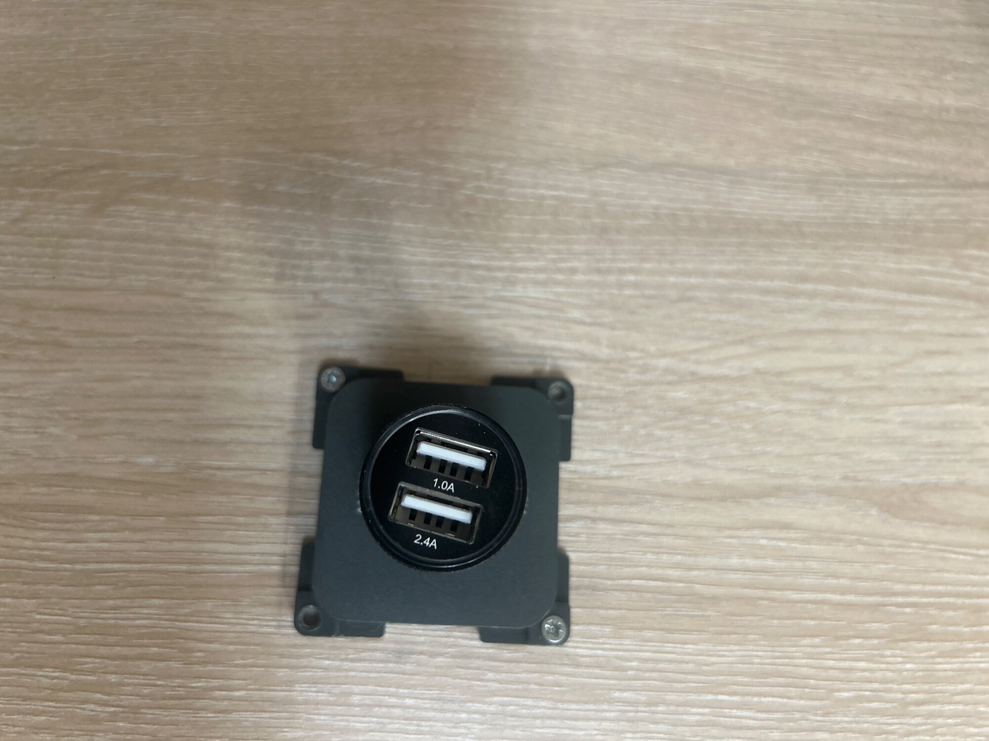

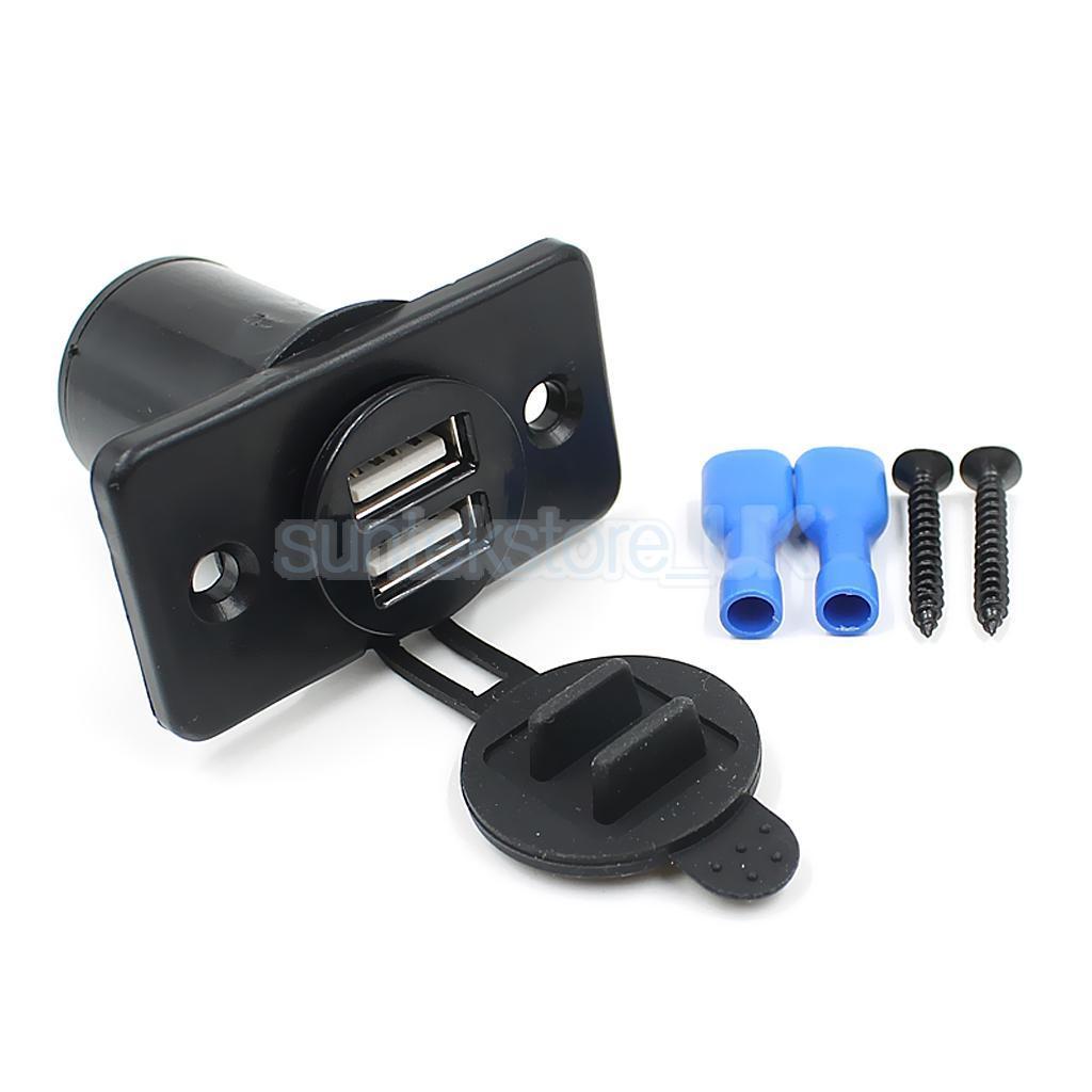

Not clear if you are talking about a 12v socket or a 5v socket, photo please,
The socket you have shown is 12v DC input and using technical magic it changes thie to 5v on the output side.
You say that the socket is 13,4 volts DC across the input terminals so there are 3 possibilities,
a) The socket is broken and isn't outputting 5v
Get 5v usb voltage tester (under £5)

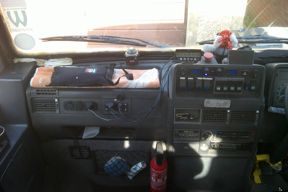

There’s nothing like a nice tidy dashboard, and that’s nothing like a nice tidy dashboard.
Problem is the dash is very thick in places and for camera and speed units there was the only place it could be fitted, all other rear usb and things are nice fit, i can control all the stuff from a switch bank beside the wheel when driving, some of the switches i had to make cover plates and mount hiding large holes cut by the van builders and the last clampet i bought the van from after he gave up but managed to fook every corner inside it, thing is it works now and tidied up somewhat.
