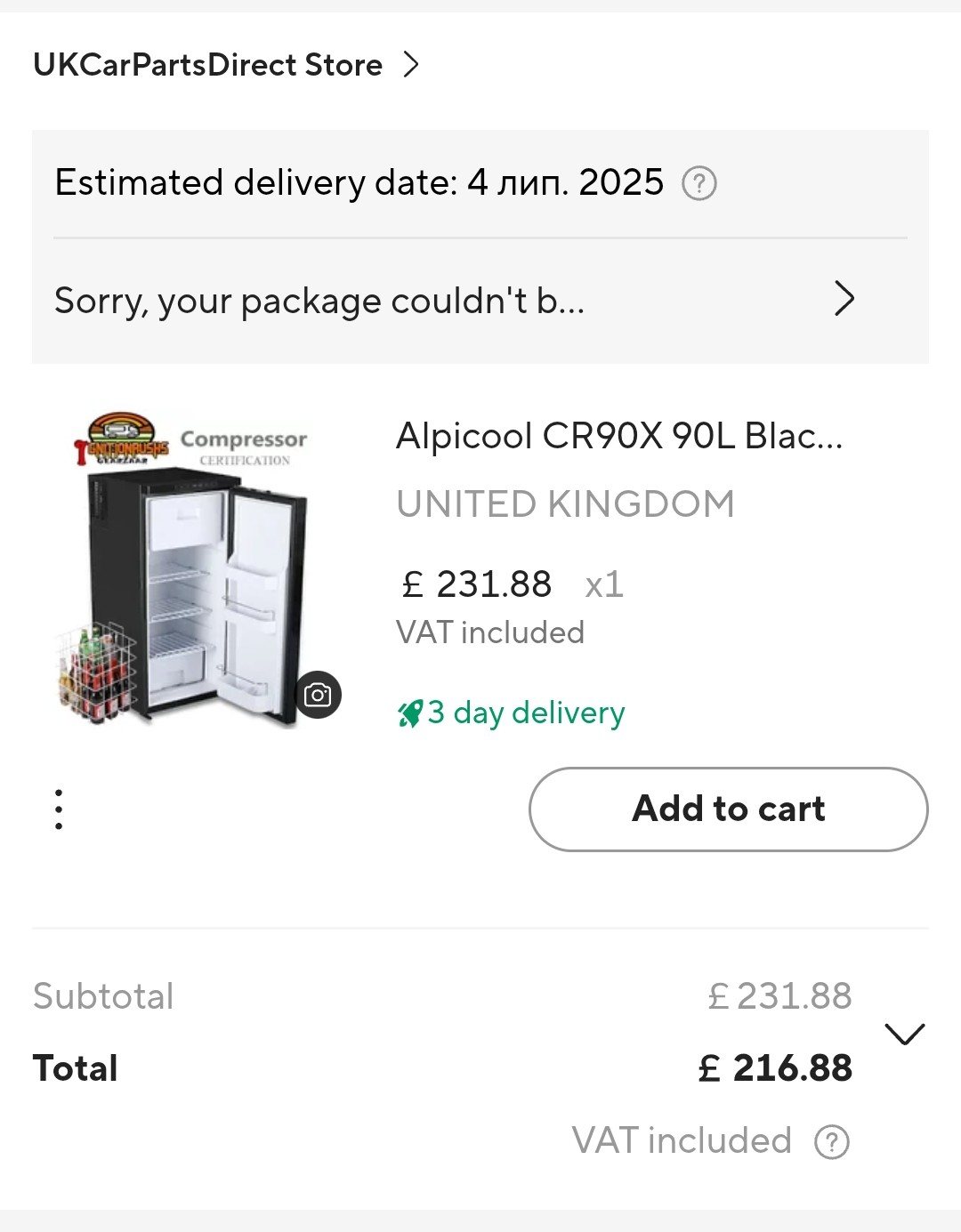

Not all inverters use a lot of power on standby, mine goes to sleep until being wakened by fridge, hence i have a cheap table top small 230v fridge, it when running uses a qtr of an amp, on test it ran 24 hrs on a single 90ah lead acide battery no bother, i have 180 amps to play with in my van plus 200w solar.I have just ordered an Alpicool compressor fridge (90L for £216) to replace my existing 3 way fridge. As we mainly wild camp I had already upgraded to 600Ah lithium and ran the 3 way on an inverter. The problem with that setup was that the fridge consumed 15A when running and the inverter used 1A even when the fridge was at temperature. Given that the running time was at least wide that of a compressor fridge you can see the motivation to change. The Alpicool runs on 12v at 80W (7A). If you wish to run it on 230v it comes with a stepdown power lead but that is pointless in a campervan. 230v only compressor fridges are OK but the inverter continuously uses power and needlessly adds an extra component that can fail.
