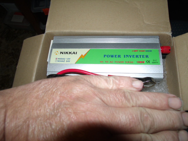

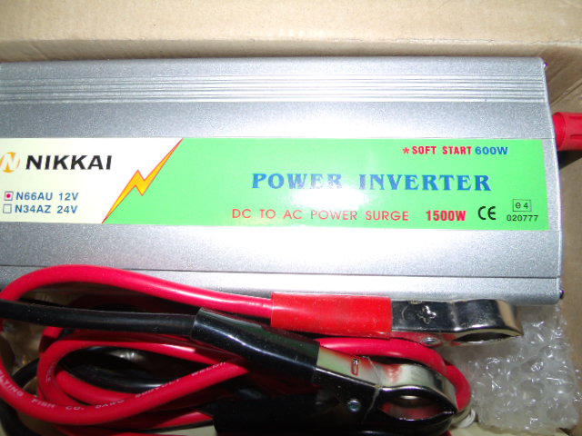

Out of curiosity, what would you need minimum to run a 230v compressor fridge freezer?
Add up the wattage and double it for inverter, my tabletop burns a qtr amp but would say maybe one on startup, so in practice a 300w inverter should be ok, however i run a soft start 600w unit which is quite small, it also powers a plug in 400w heater in winter days before the van heater kicks in.

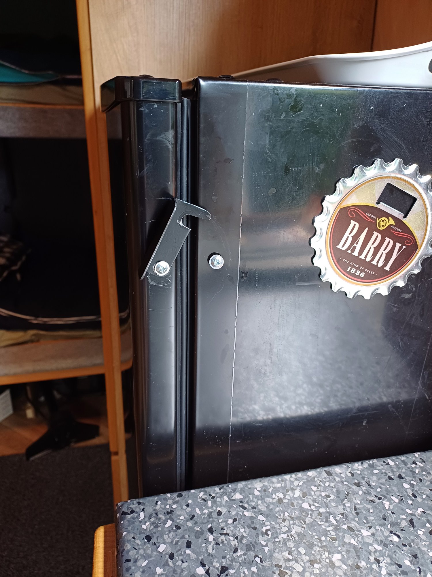

Bit late to the party on this one. After reading Wildebus on about 240v fridges I bought a 93l Cookology fridge. It has been brilliant. Better than the one at home. On initial start up it takes about 500watts for a very short time, but when running it only takes 45 to max 55 watts and is not on very long. It cools down much, much quicker than a 3 way fridge. At present outside temp is about 28/29 (car says 34!) and the fridge is holding at 4degC. The ice box keeps frozen stuff frozen, but not sure if it would be good enough to freeze unfrozen stuff? The door is tight and stays shut when driving. For our recent trip round Ireland and hearing about the state of some of the roads, I did make a very simple catch. (Pic attached). When running it is very quiet indeed. The only thing to be heard is the occassional clunk when it switches off. All in all a much better solution than the 3 ways we have had in the past and of course much cheaper to run. Thanks to Wildebus for his previous advice.
