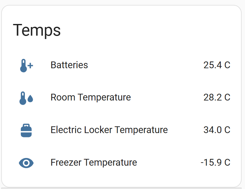

So those with one, how are they doing in this heatwave of ours, I'm finding my gas 3 way is struggling to keep below 12deg when it's 30+ outside. I Fitted the fridge fans on it but little improvement
Just did a screenshot of my temps right now ....

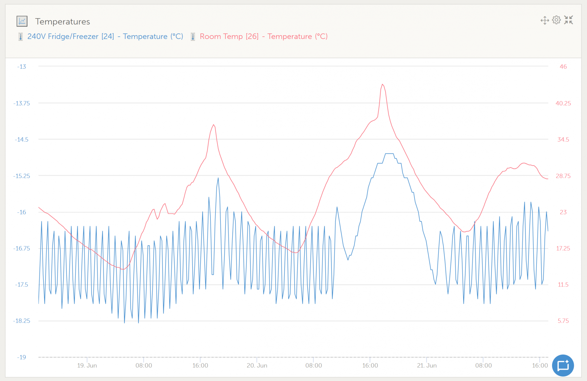

Thought I would have a look at the temp range over a few days. quite interesting in fact.
As the temp gets in the 30's, the freezer temp does get slightly higher. Yesterday, when the internal van temp started reaching above 40C, it looks like there was a bit of a glitch with the freezer temp rising over a few hours before it started to fall again as the room temp dropped and then back to the regular pattern of cycling between a one degree range.
I assume that we were getting over the design temperature range (fridges all have a operational range of upper and lower temps, but typically they have a much bigger issue working when it gets very cold rather than very hot).
But the key factor .... the room temp may have more than doubled in 12 hours from 17C at 08:00 to 42C at 20:00, but the freezer temp only changed from -17C to -14.75C - not really that significant and still well within working range.
