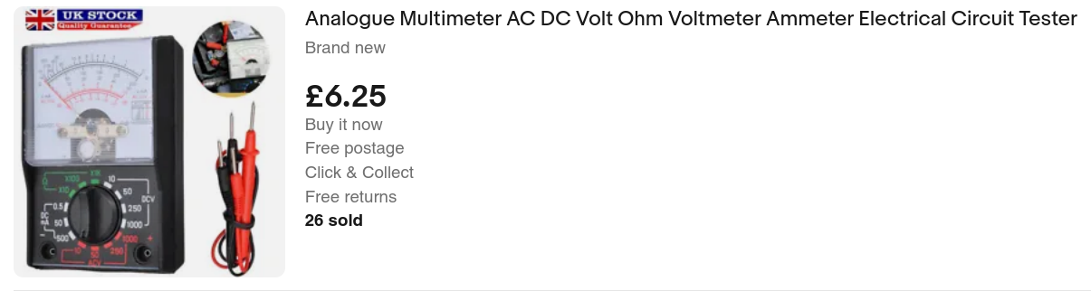

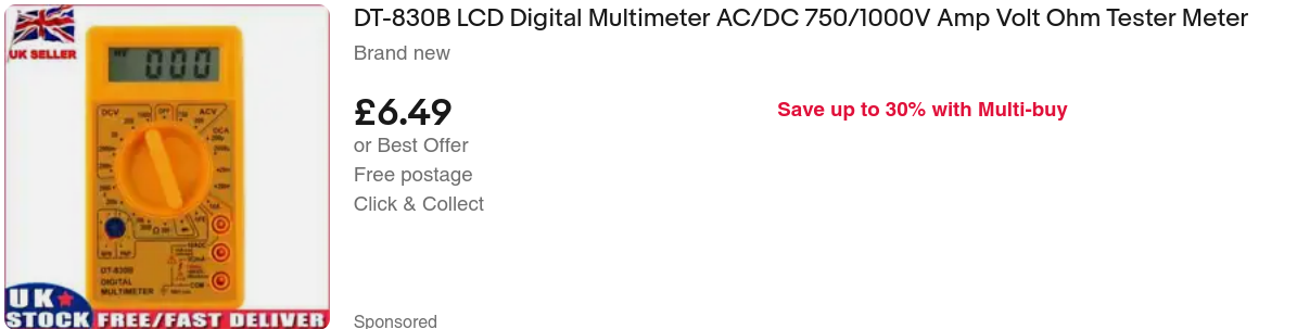

Unplug at a wiring joiner, then put an ohm meter across the wires, if the needle swings or digital one reads zero then thats the faulty one, another way is a bulb and battery, old school but works.
All vans should carry a cheap meter, £6 ish will buy one.

Thanks Trev. I think I know what you mean. We'll be knocking on other vans looking to borrow a meter tomorrow.
