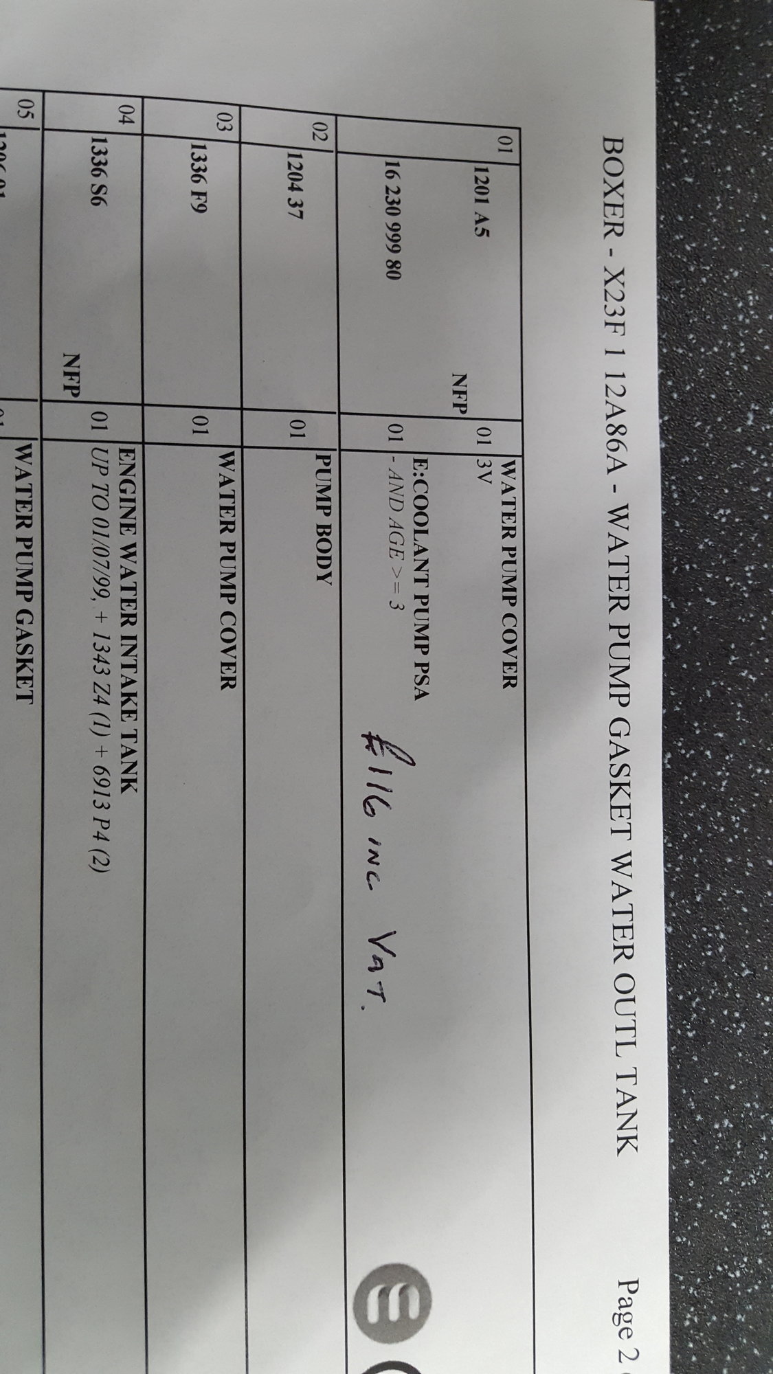

So....Peugeot no longer manufacture them part no. 1201 A5....but there sister company do! Eurorepar 16 230 999 80 ....£116 inc vat. Any peugeot main dealer will be able to order you one. Nobody had 1 in stock in my area though but they are available to order. Hope this helps 👍🏼

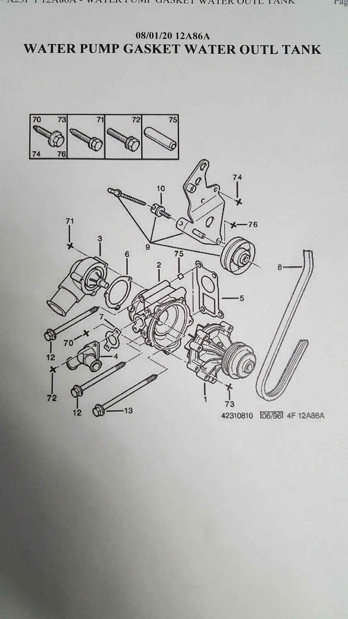

🙈🙈....if its item 1......NFP in part list means no further production. So you would have to either repair or look for that water outlet 2nd hand .
Hope this diagram helps....nothing else showing for that area sorry

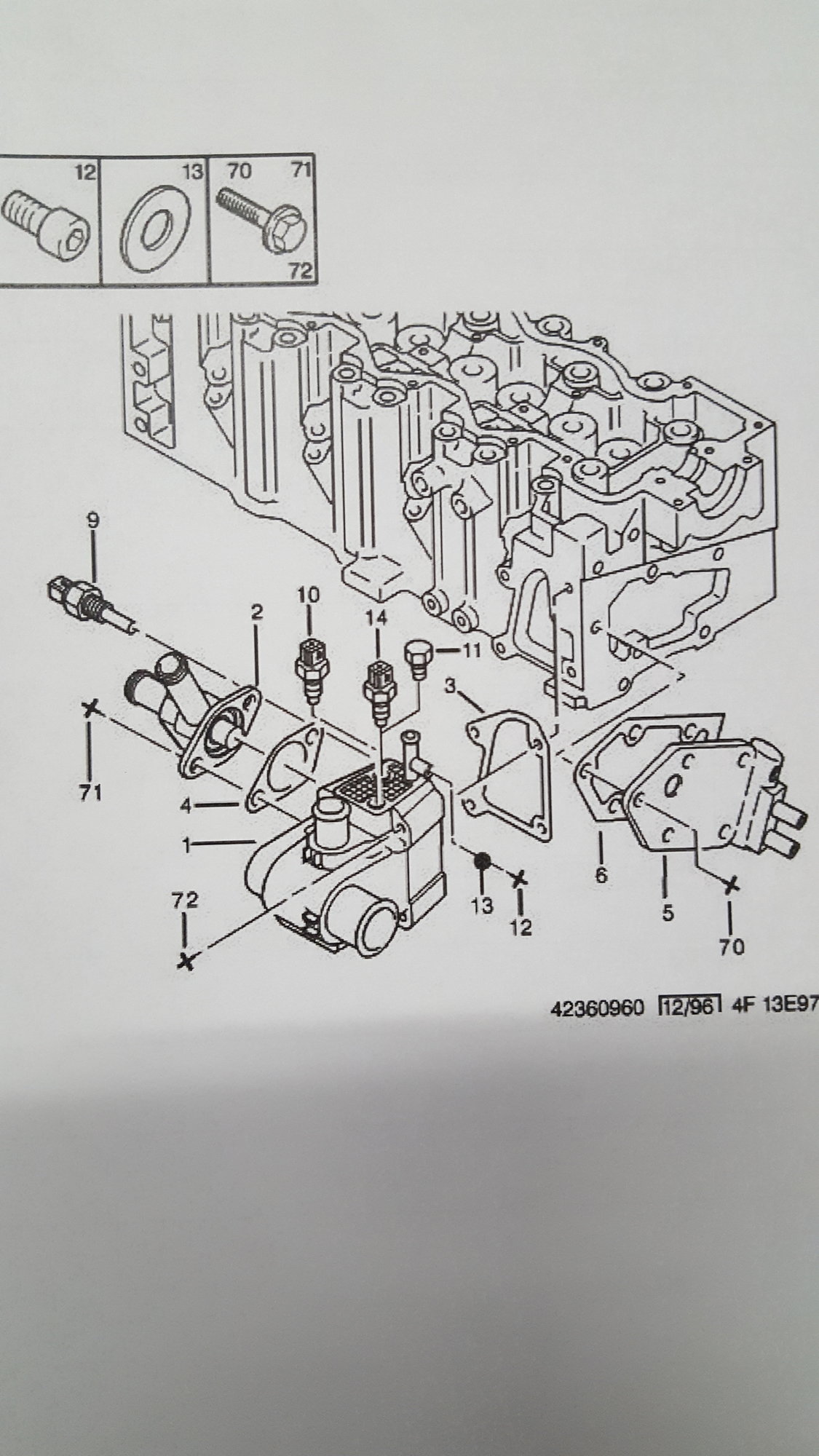

Your first suggestion (post #27) seems much more like it - the inlet pipe appears to be at the front (part 4) instead of at the top? Maybe it would fit, dunno.
It looks like that pipe is no longer in production either 😔. If it can be removed then easier to repair. Hoses can then be guided to fit where you want them?
Is the pipe separate Will and if so has it got a part number, that`s how i found the water pump earlier by using the part number you came up with.
