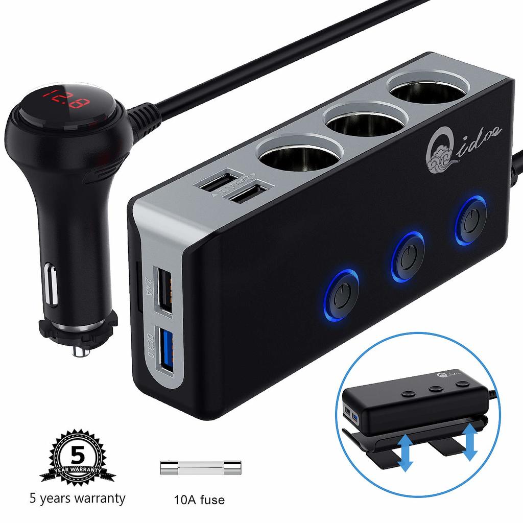

No it wouldn't work as a charger, if you buy something like this
you could plug your fan in as well as charge a few devices, you can buy 3m USB cables so you don't have to put your phones too near
https://www.amazon.co.uk/CLEEFUN-Ch...ay&sprefix=3m+usb+,aps,147&sr=8-1-spons&psc=1

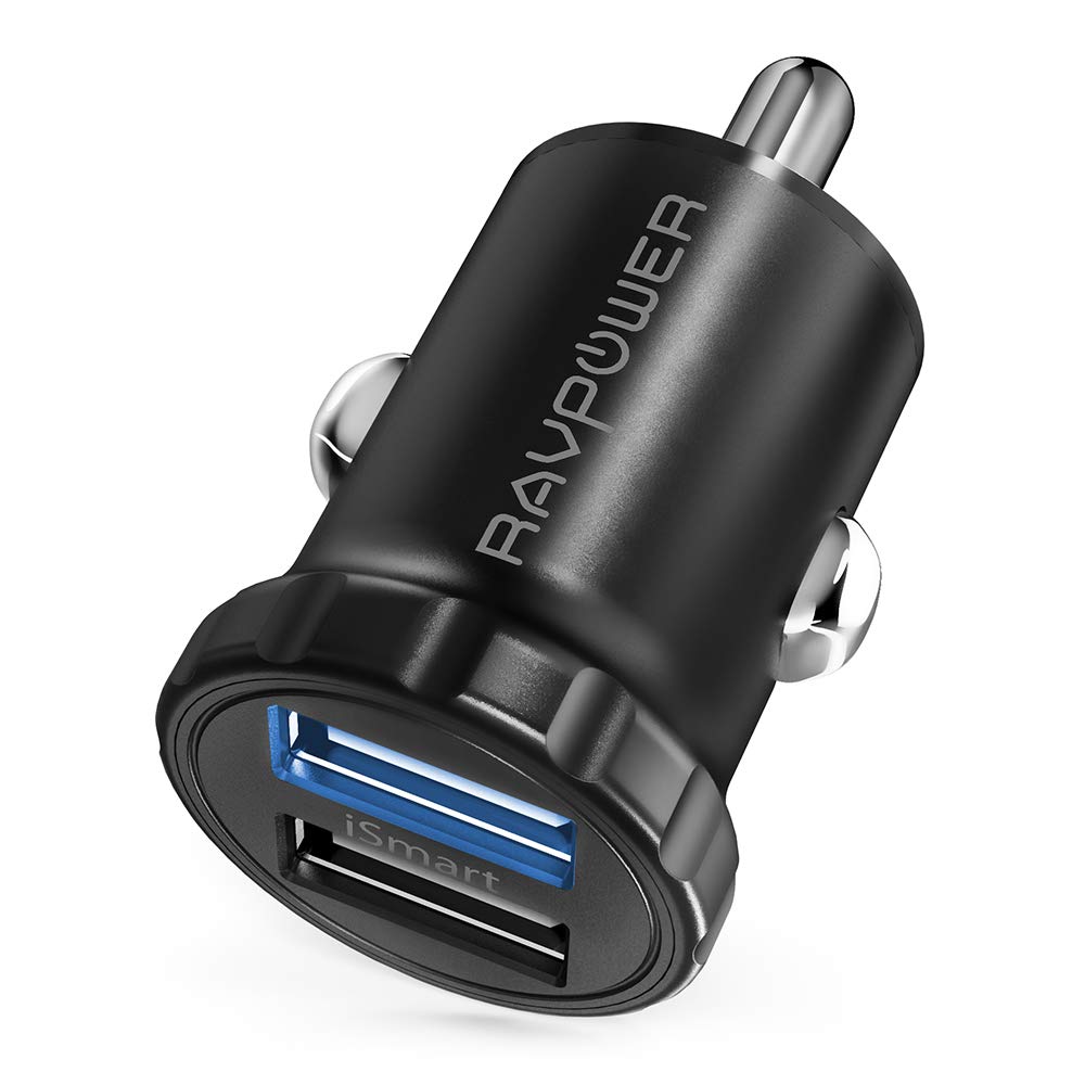

The other alternative is to put another cigarette style charger where you need it and use one of these
that is the best and tidiest way in my opinion

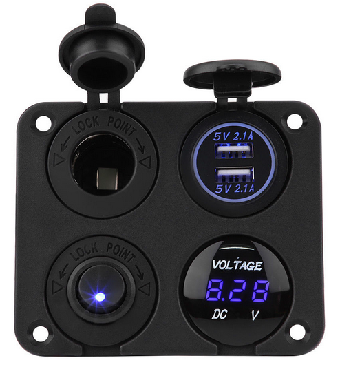

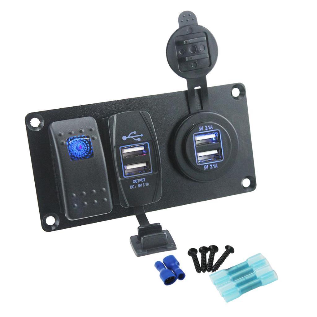

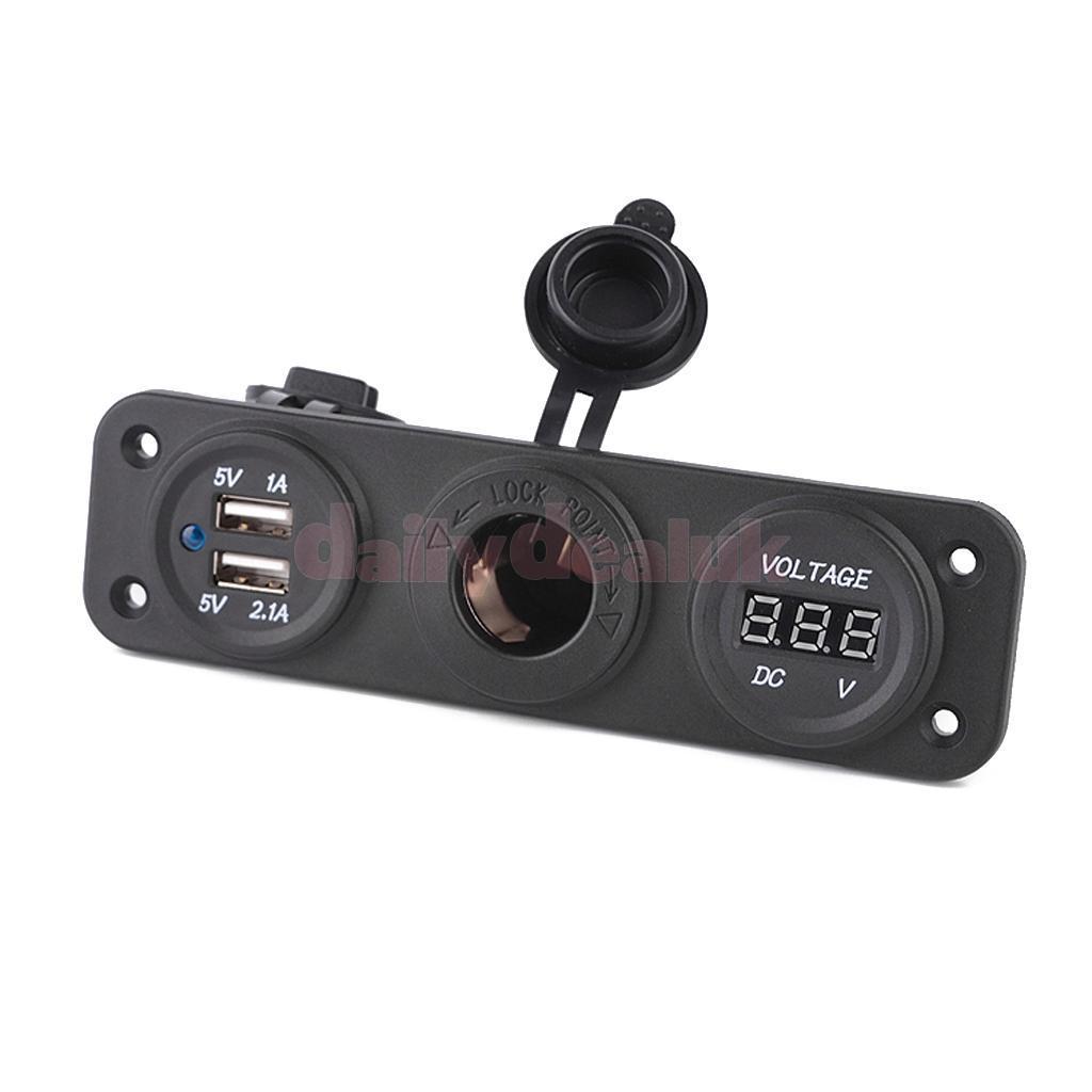

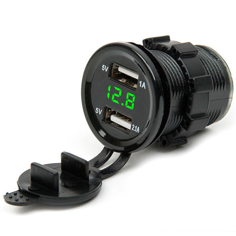

between the seatbacks and the side of my van there is a 50mm gap i have fitted 3 double usb sockets fed from the leisure batteries with in line fuses giving me power whoever we sit or lie in the van it’s great
Any of these will do with an inline fuse to les battery,im sure you will find a place to put it.:scared::wave:

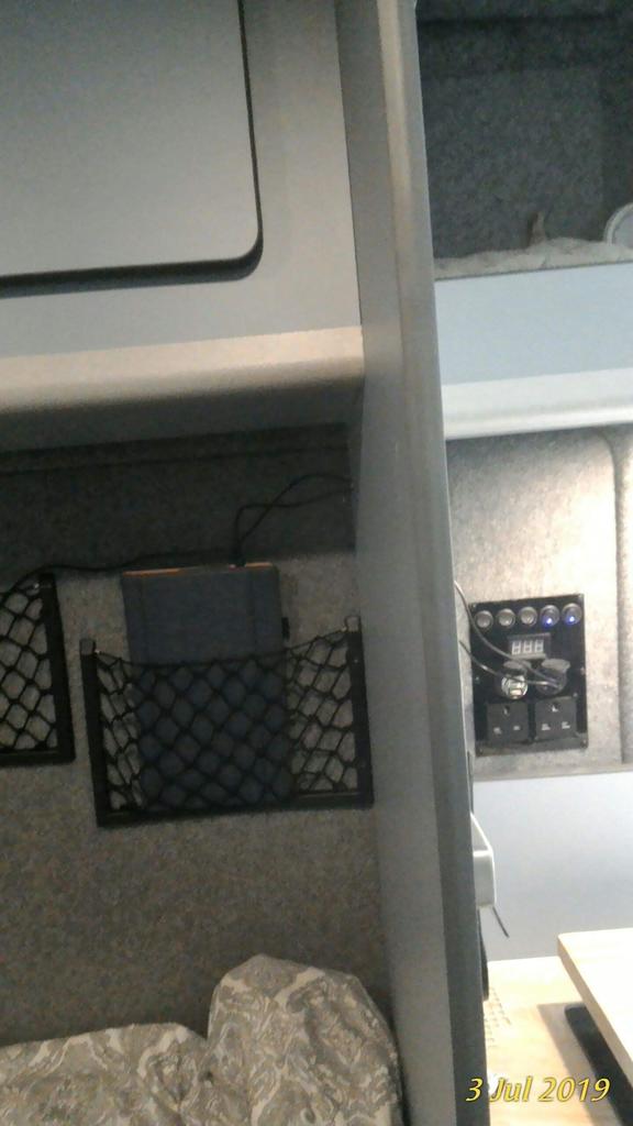

We use nets to hold tablets and phones in place while charging at the end of the bed. The wires are threaded through a small hole in the side panel from the USB ports.
MASO 2x Storage Net Large Elastic Stowing Nets 31.5X17.5cm for Car Truck Boot Tidy
