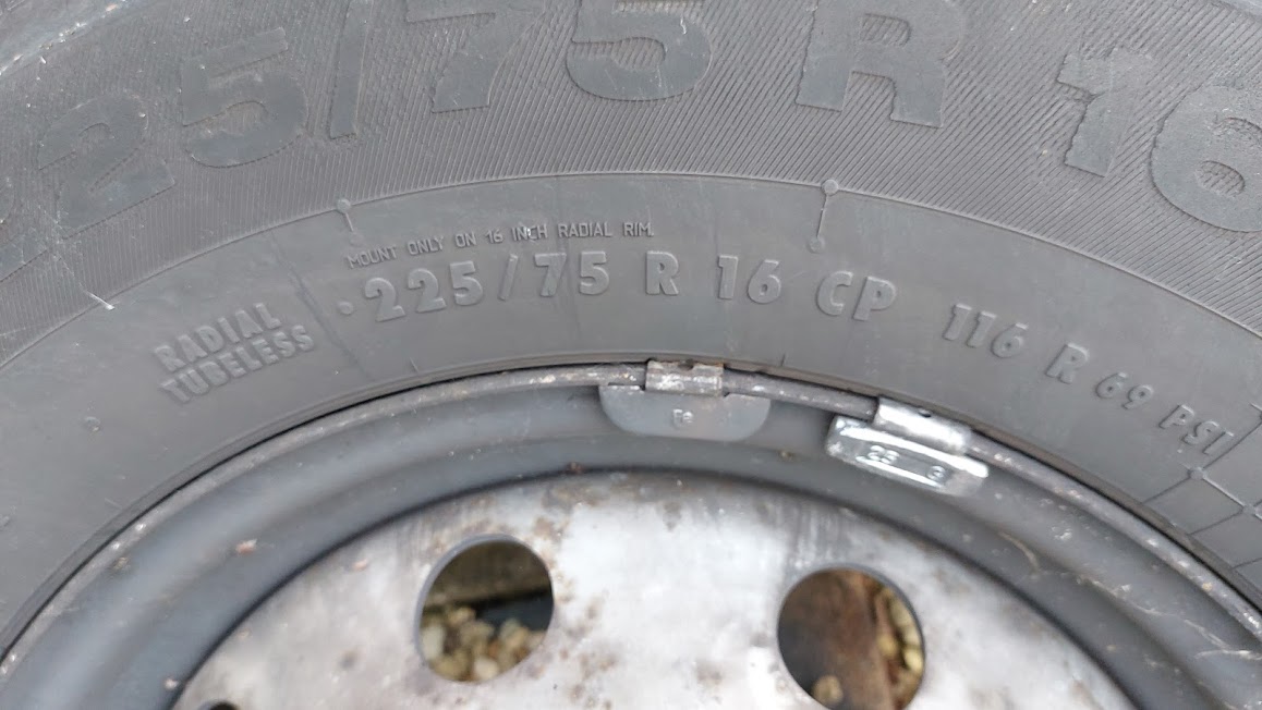

Fitted on my Maxi Chassis OE 4005kg.
Air suspension as fitted to premium cars Range Rover, BMW, Merc etc and Air Assist suspension, to stop you having a saggy bottom on your MH are very different things.
Don’t know why mine should ride and handle so well unless it’s because of the rear wheel drive ans AS air at the rear. With Conti’s you just need to send axle loadings to their tech guys and they will say what pressure to use. Maybe that’s why mine is okay
I fit the cheaper cost tyres and dont give a fart, got 4 new tyres on new rims from England for £100 caus the chap wanted alloys, think they cost me £30 postage, these are now my reserves hiding in the workshop, think there mitchies
Just as I said, the 215/75 16CP cannot be fitted to a Maxi chassis due to axle loads, yours is a 225/75 16CP.
"...if it's for the Maxi Chassis then none will be marked CP as it's impossible to make a tyre that size which meets CP specs...."
👍 I read it the other way round,
Yes my bad explanation I should have clarified that this referred to 215/75-16 116 load index.
