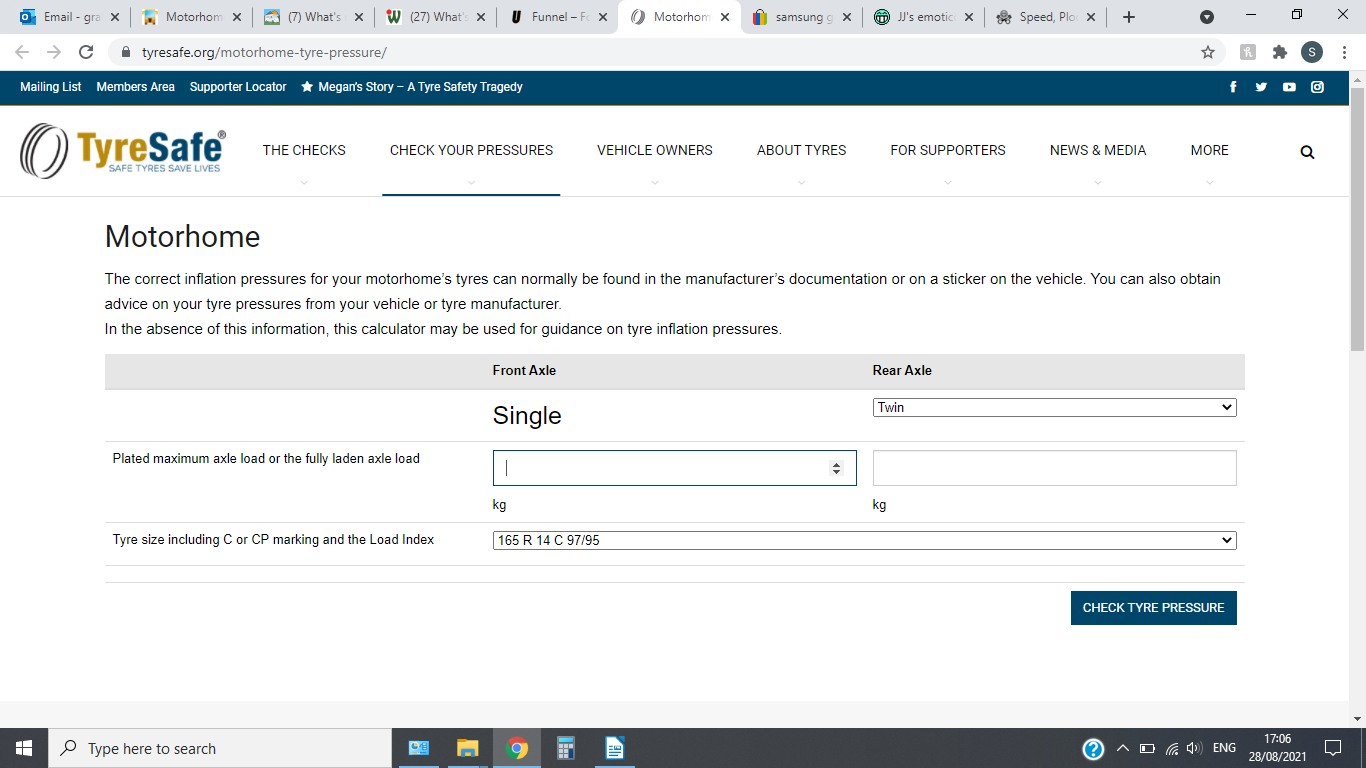

This site has an option for single or twin axles however does anyone know if you put in the weight for 1 axle or the 2 combined (so for me it would be 1600kg or 3200kg as I have a tag axle MH)?

For a Tag axle it has front, axle 1 and axle 2. Input each individual axle weight.
Not on mine. Am I doing something wrong?
Don't think so, I get the same page and options.

They have updated the website since I last used it but I got a result.
On a tag axle both axles are identical and usually have a rating of around 1500 Kg. I just inputted my front axle weight and the weight of one tag axle and got the correct pressures.

If I do that I get 65psi for the front but only 40Psi for the back...which seems a tad low to my mind
If I add the 2 axles together and put that in I get 65Psi all round!

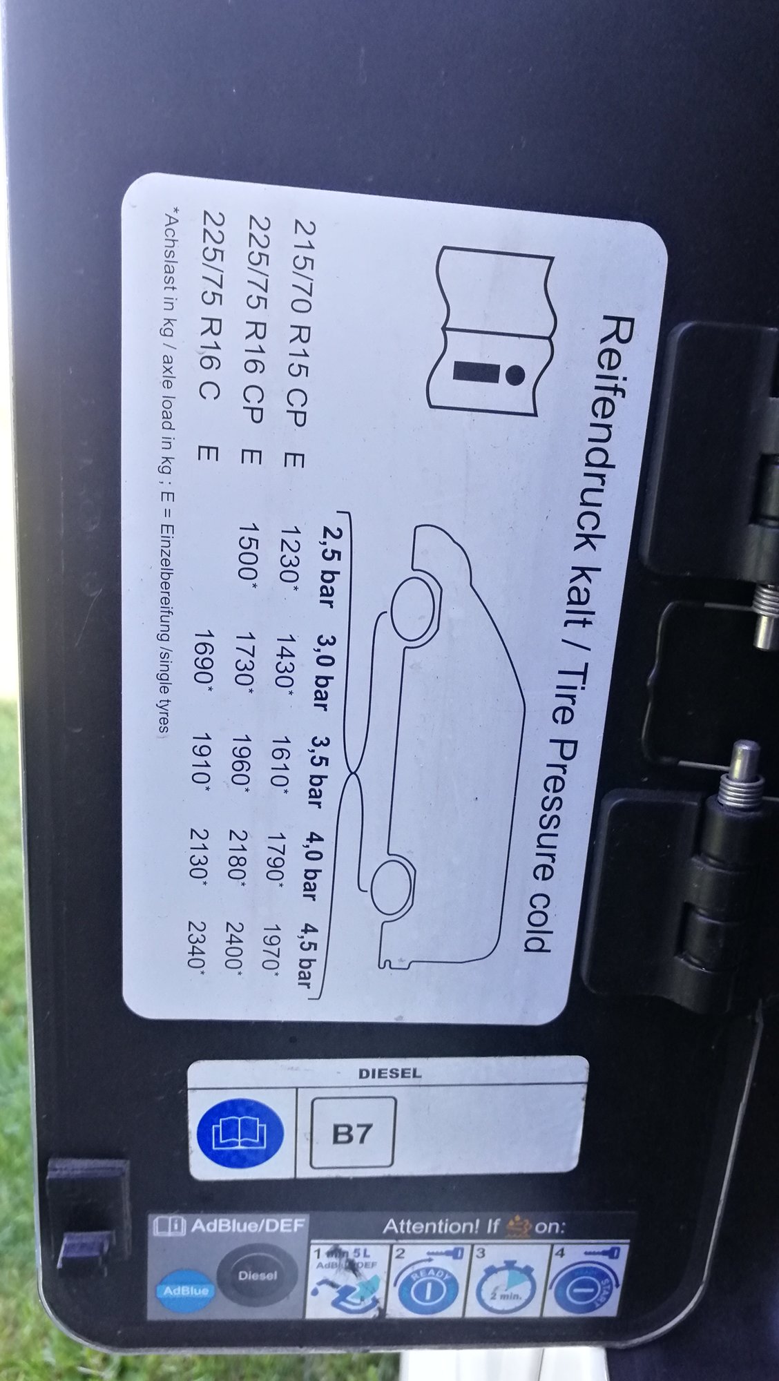

Look at the photo above your last post of the Cathargo tyre pressures for various loads. Therre are some low pressures on that chart. You have not said what size tyres you have.
That does sound low for the rears, but bearing in mind the rear axles are sharing the load I would expect the rear tyre pressures to be lower than the fronts unless the weight distribution is very uneven.

My tyres are 225/65 R16 CP (C on the back axles). Tyresafe give the pressures as Front 62 psi, Rear 44 psi.

225/75R16CP Michelin ones
