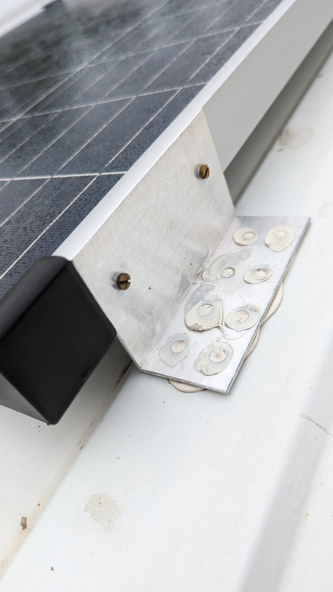

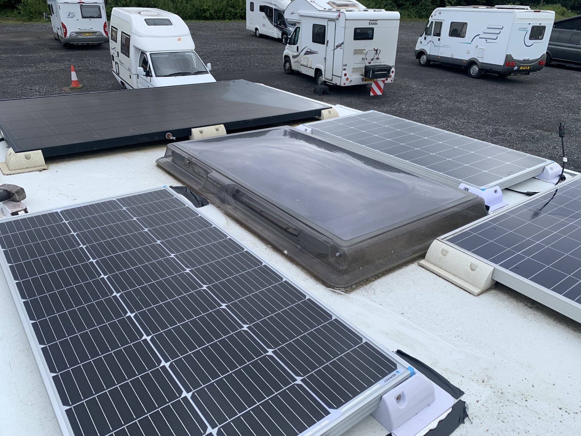

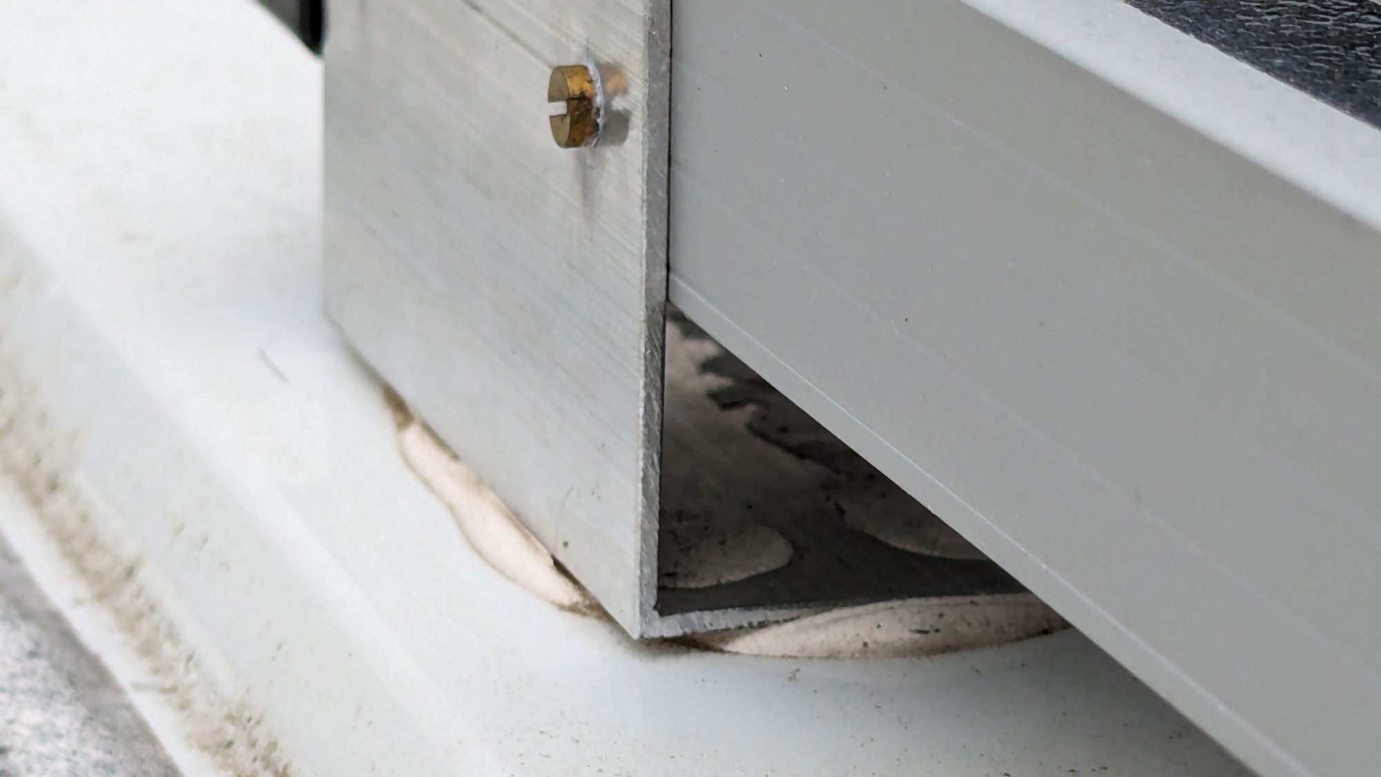

No, I bolted the panels onto the brackets and used Sikaflex.Do you use any mechanical fixings as well Bill?
I'm tempted to put one bolt for each panel as a sort of 'dead man's handle' but not sure if it's necessary.
I was not into drilling holes all over the roof of a brand new van Rob.
But the biggest problem would be trying to get them off if I had to now.
My dealers don't use mechanical fixings either Rob, they use sikaflex 544.
I don't know if I would trust the small corner brackets though Rob,I used screws on them on my last van.
