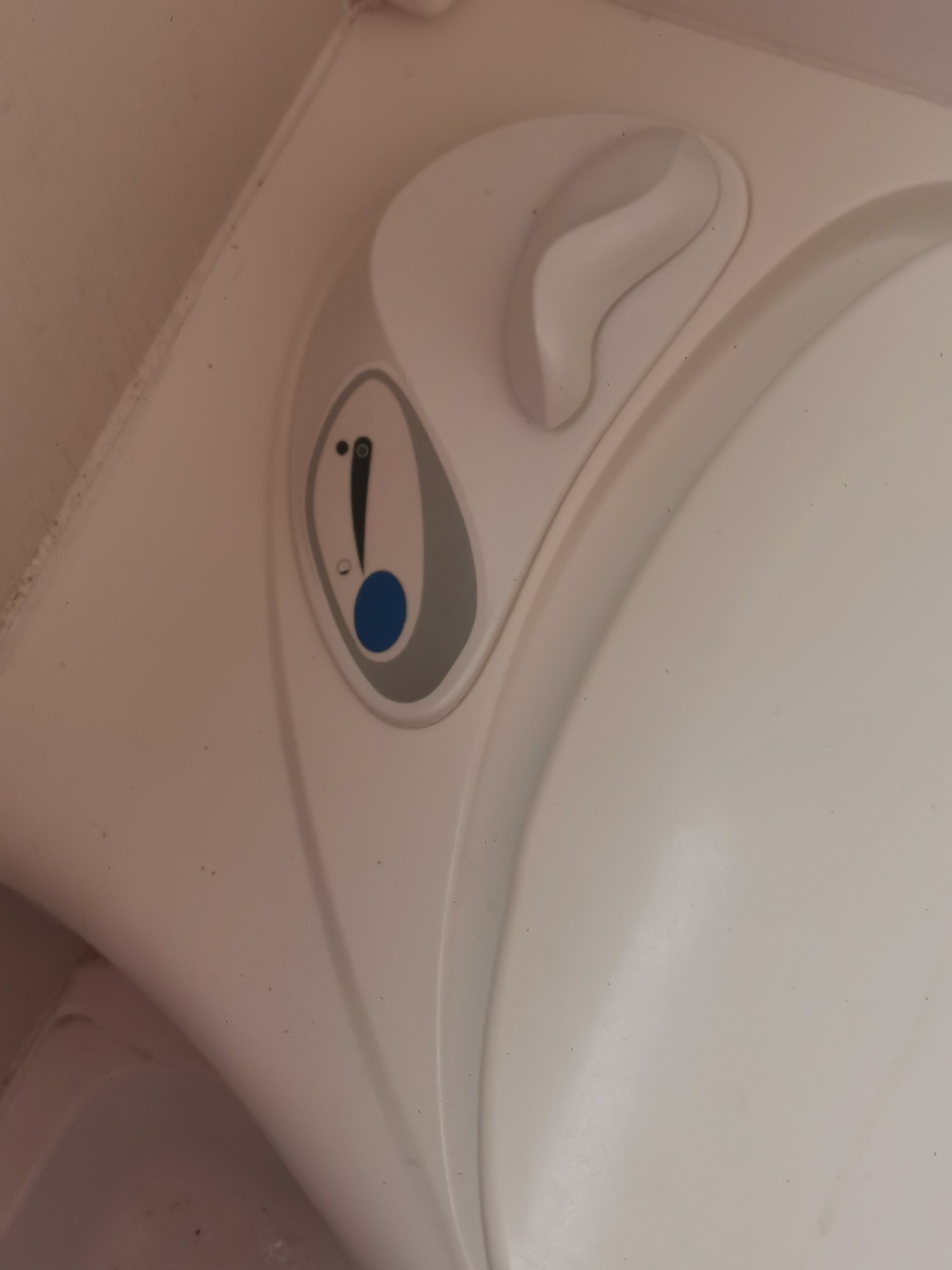

My flusher seens to be working intermittently, one minute press and hold button and flushes normally then next time nothing?

Probably the switch has become unreliable.
I doubt if its possible to clean it. The best thing is just replace it.
