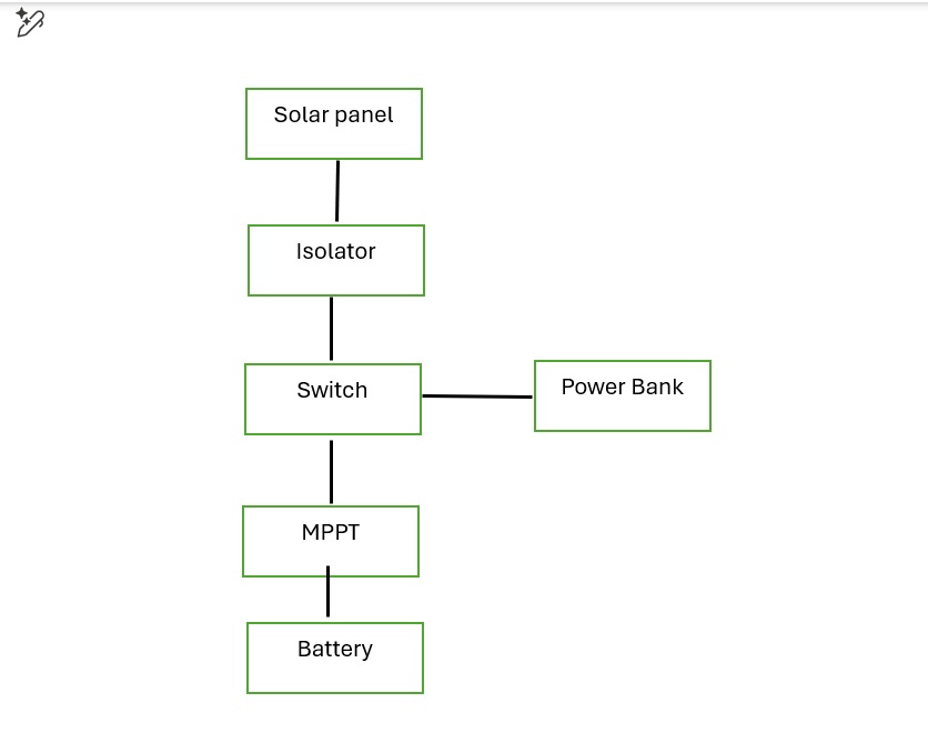

If you sisconect the battery with that without isolating the panels then you will nacker the regulator, dont do it.I used one of these ok for 300 amps also option to turn off completely.Dual Battery Switch, 300A Battery Switch 3 Position Dual Circuit Power Disconnect Cut Off Isolator 32V DC IP66 Waterproof for Boat RV Yachts Large Trucks Vehicles : Amazon.co.uk: Automotive
Dual Battery Switch, 300A Battery Switch 3 Position Dual Circuit Power Disconnect Cut Off Isolator 32V DC IP66 Waterproof for Boat RV Yachts Large Trucks Vehicles : Amazon.co.uk: Automotiveamzn.eu
Don't think so Trev, it's the right side of the MPPT isn't it?
Oops sorry, I thought you were linking to Del's suggestion earlier!

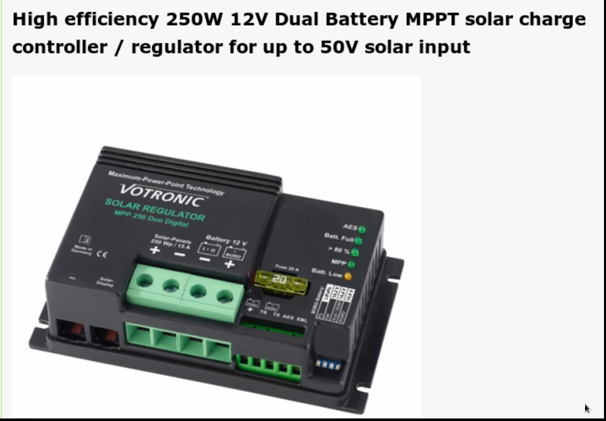

You must either keep a battery in link or disconnect the solar input to mppt unit unless you cover the panel, my unit has a fuse to disconnect....although would it matter still?
You must either keep a battery in link or disconnect the solar input to mppt unit unless you cover the panel, my unit has a fuse to disconnect.View attachment 151130
Correct Rob, just dont disconnect the battery without cutting the solar to regulator.I thought that as long as the battery is connected to the MPPT you can disconnect/connect the solar as you please?
