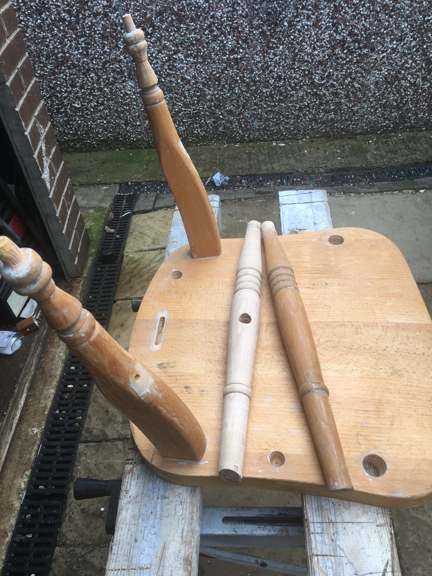

Came of the lathe looking great pity I have to colour the beech to match the rest of furniture

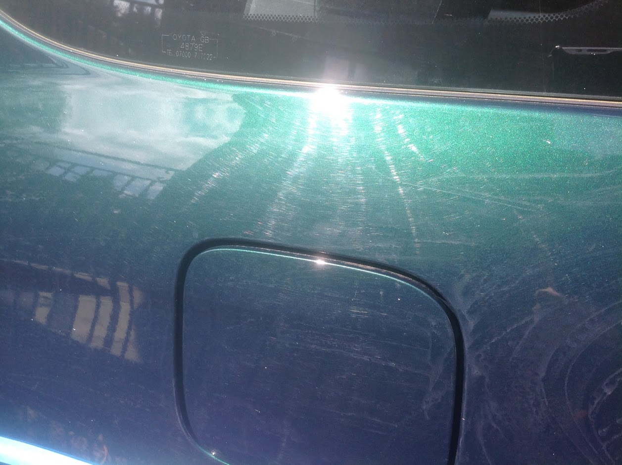

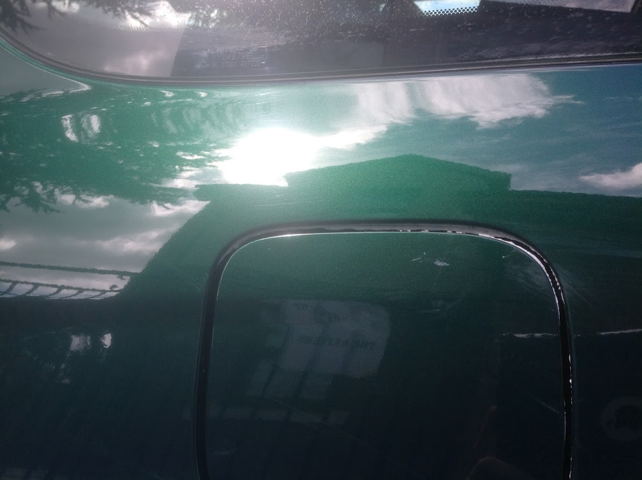

Did my RAV4 (remember Japanese paint is VERY soft! I did the whole RAV4 in the same kind of time it took to do that VW bonnet and used finer compounds).
The RAV4 had nice paintwork when I bought it, but had the usual regular washing from a sponge and bucket...
bit of CAREFUL Machine Polishing ...
