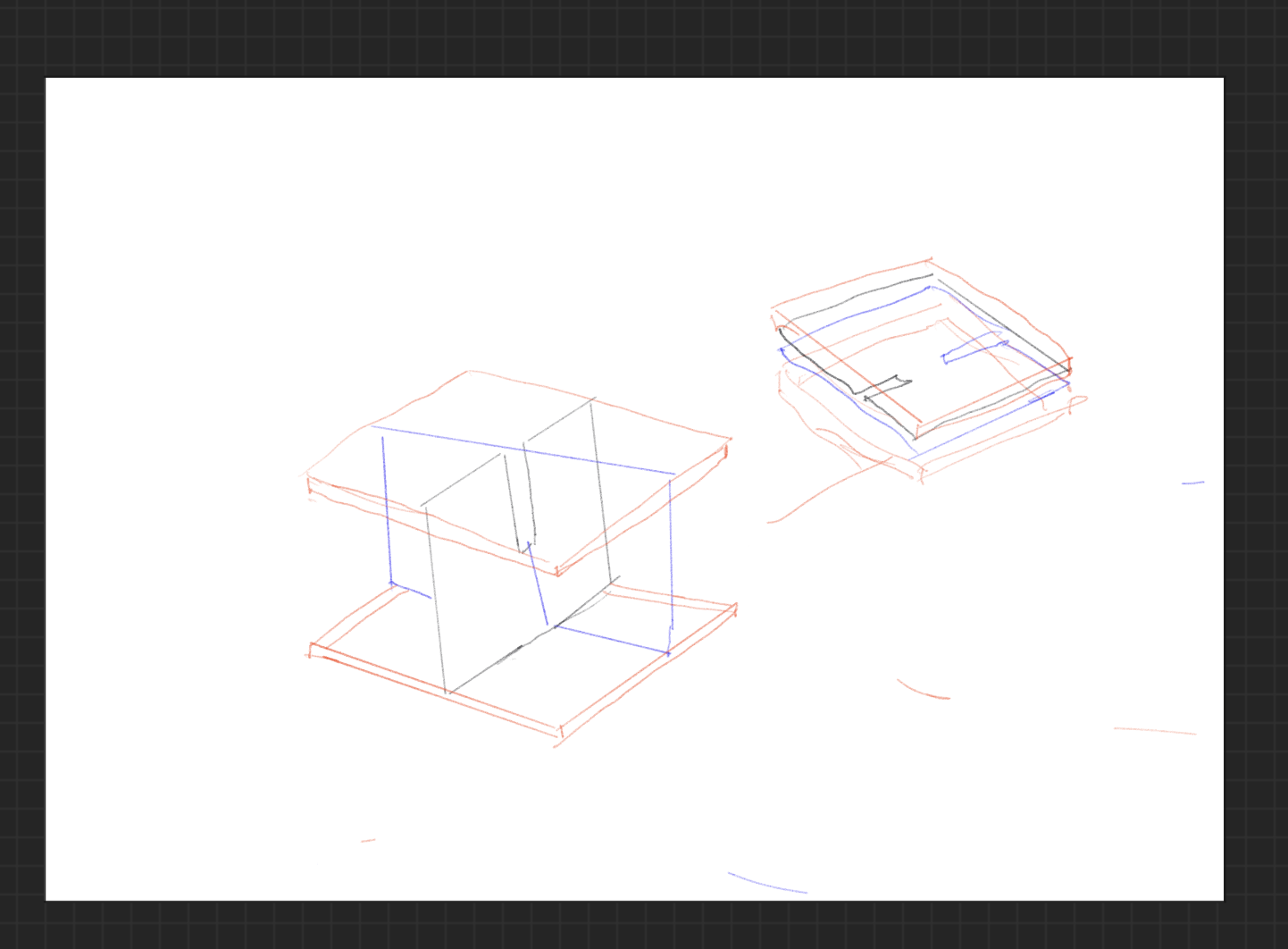

I’m thinking of this (poorly drawn for now)
120mm high when in use 20mm high when not in use.

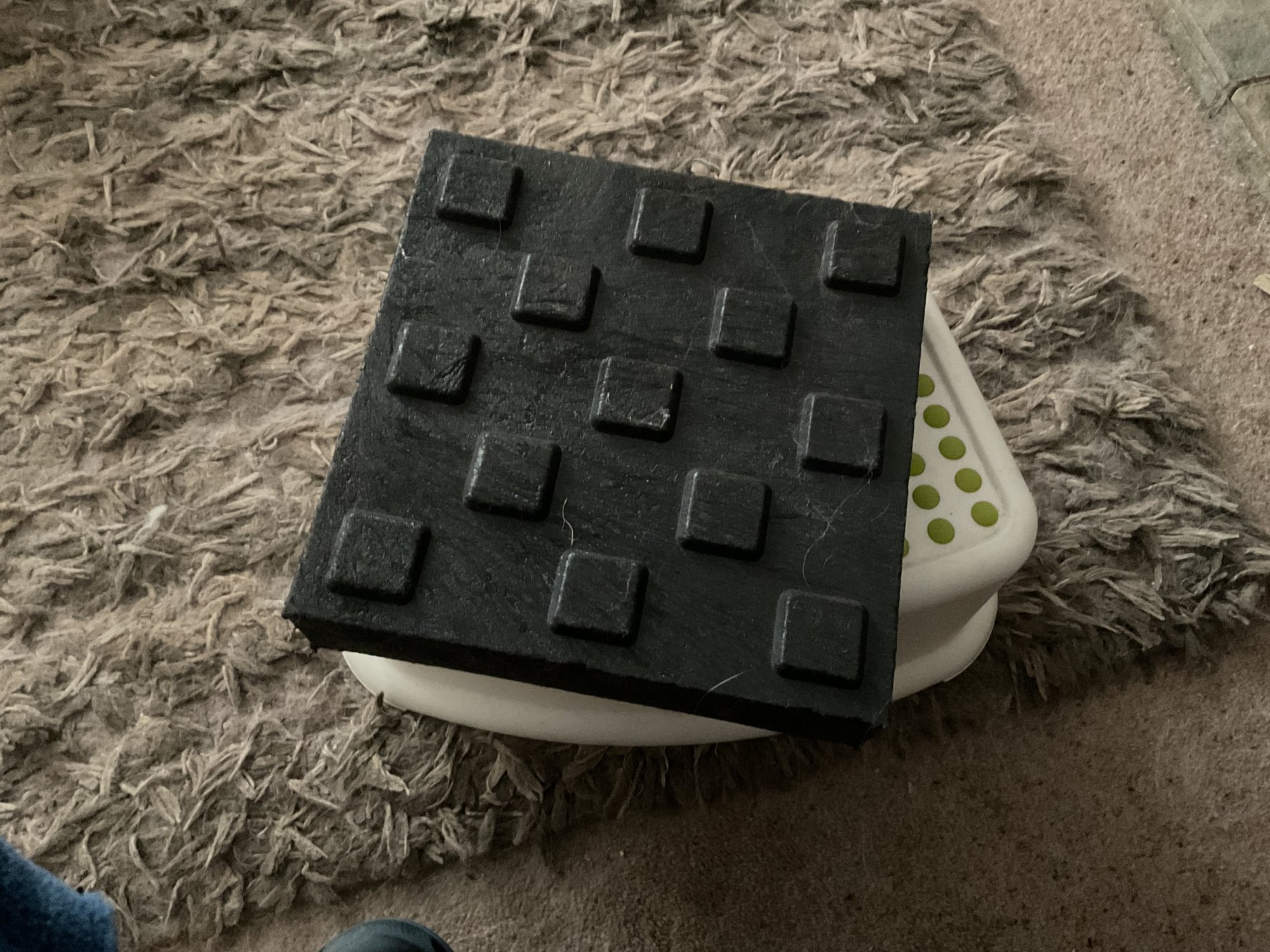

I have some blocks slightly larger than you are looking for but they can be used to jack up on and they stack so they don’t slip off each other, here is a photo. They are about 25cms square and about 5cms thick, material is I think glass fibre reinforced HDPE.
Thanks, I might come back to you on that.
We used to have something very similar, powder coated green with a rubber mat on top to prevent slipping. Can't remember who made them but we found that they weren't particularly stable. The design of the slotted internal cross pieces meant that they were prone to twisting, Heavier gauge sheet might have solved the problem as would slots in the top and bottom plates.
I made some in 3mm aluminium in the week and yes they worked, but I’m going 4mm and 200mm square with better locators.
Also sandwich profile tops that slide onto the legs to avoid slipping.
