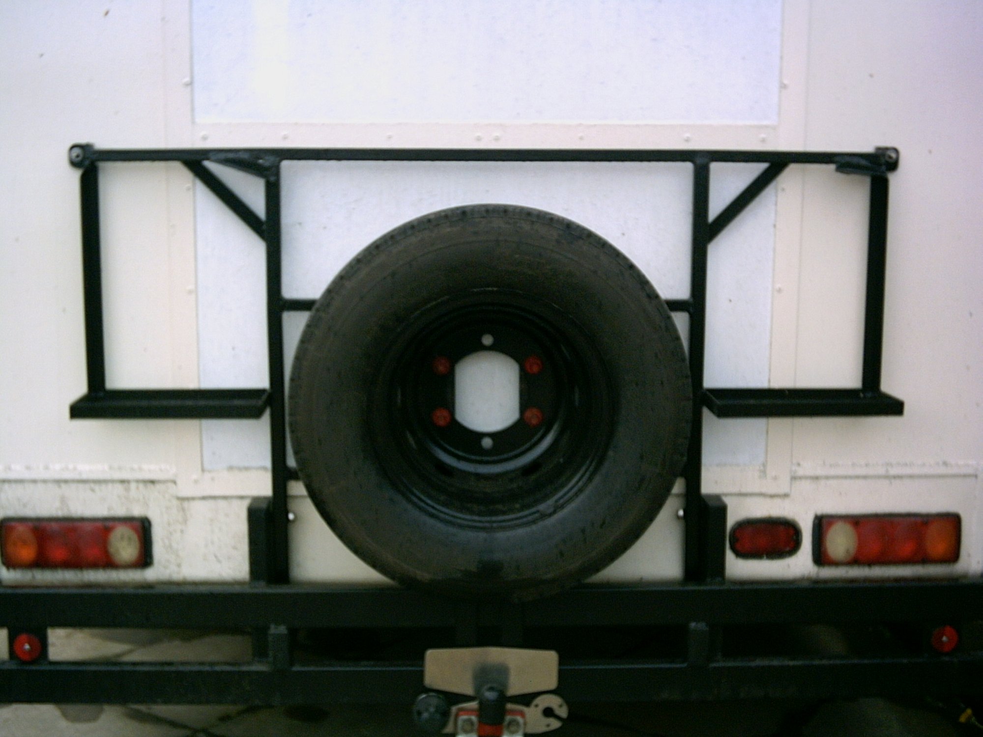

Bracket bolted to t bar or back chassis, never carry a loose wheel inside a van, bolted down is ok.
I fitted one to the underside of the van using the fiat bracket.
