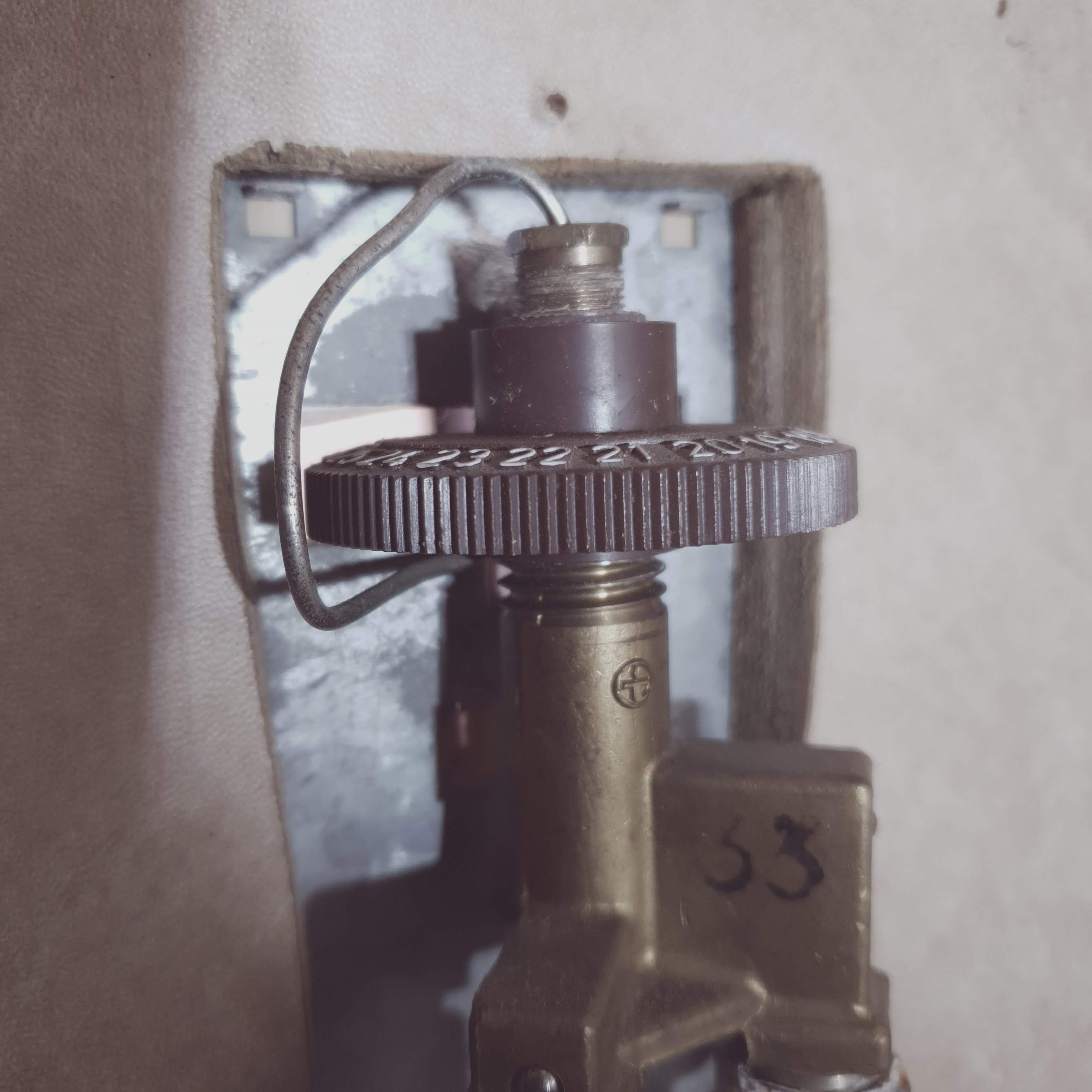

I'm no expert on gas fires, but to go out suddenly I would suspect the thermocouple.
I know nothing about gas but one daft thing comes to mind ..... got enough gas in the bottle?
  • Like
Reactions: RAW
I tend to agree that if it suddenly went out then the thermo couple would be my first thought. As for buying one I have found that usually a third party thermo couple can usually be found to fit. Phil
Sorry to be replying in bits and pieces, but looking at the photo once again Robert I would hazard a guess and say that the slot just below the temperature wheel should accommodate the thermocouple tube so as it would be out of the way from damage by the wheel itself, looking carefully it looks as though the tube has sustained damage just on the bend below the temperature setting wheel. Thermocouple tubes will take a lot of abuse but when they do start leaking they cause all sorts of problems from low gas flow to no flow at all, even a leaking one can if heated by a fierce pilot light give a good gas flow until enough fluid has leaked out to drop pressure inside the tube to either make the main burner go down to almost nothing or suddenly go out. Phil

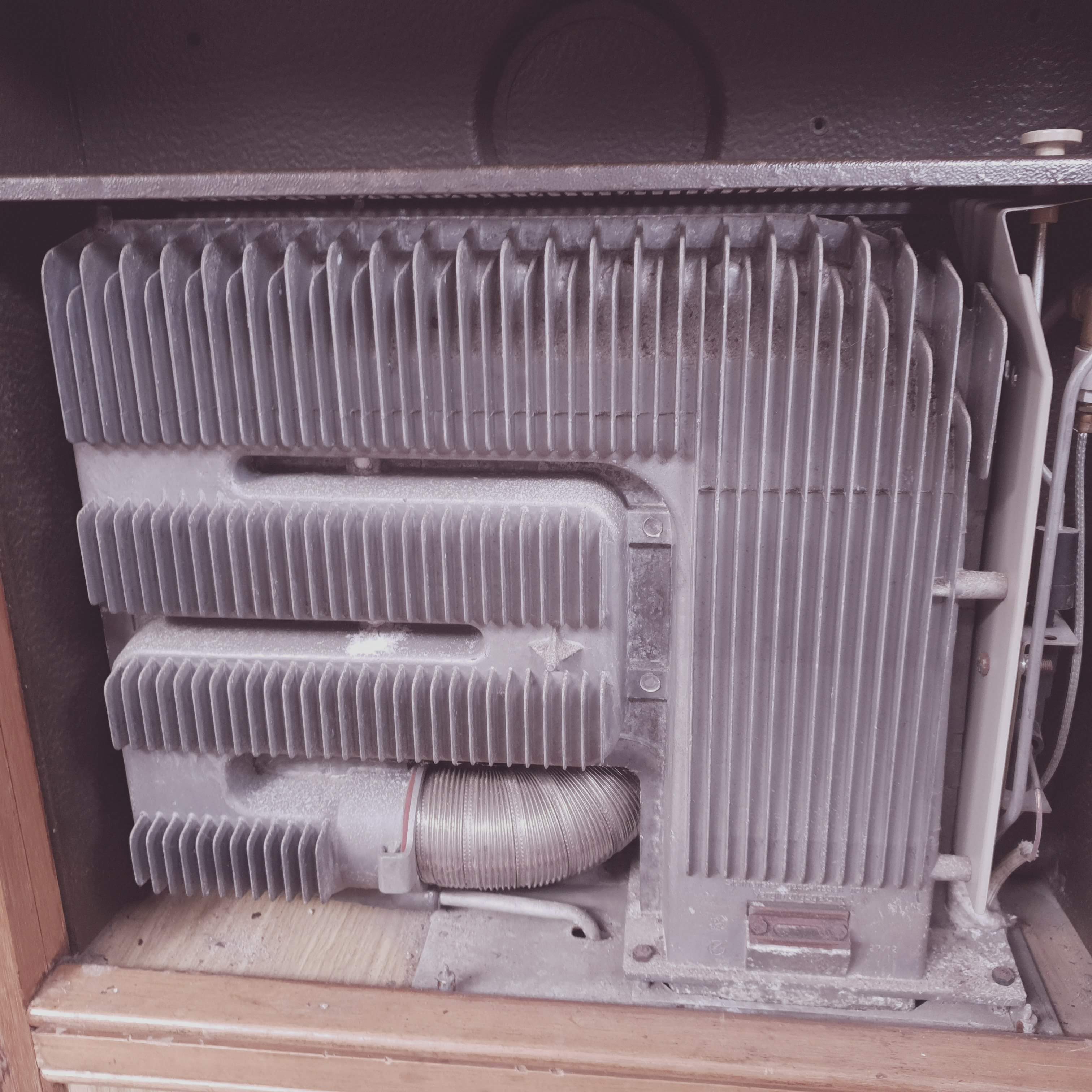

So the cover is off, I am struggling to take the Top Nut part off where it screws into the wheel on the thermostat (left picture), just seems to turn and turn.
Someone else on a Facebook group send take glass cover off and clean inside with a small brush as jets might be blocked ? (Middle Pic)
Any more help appreciated. Ordered new Thermocouple as was not overly expensive, under a fiver.

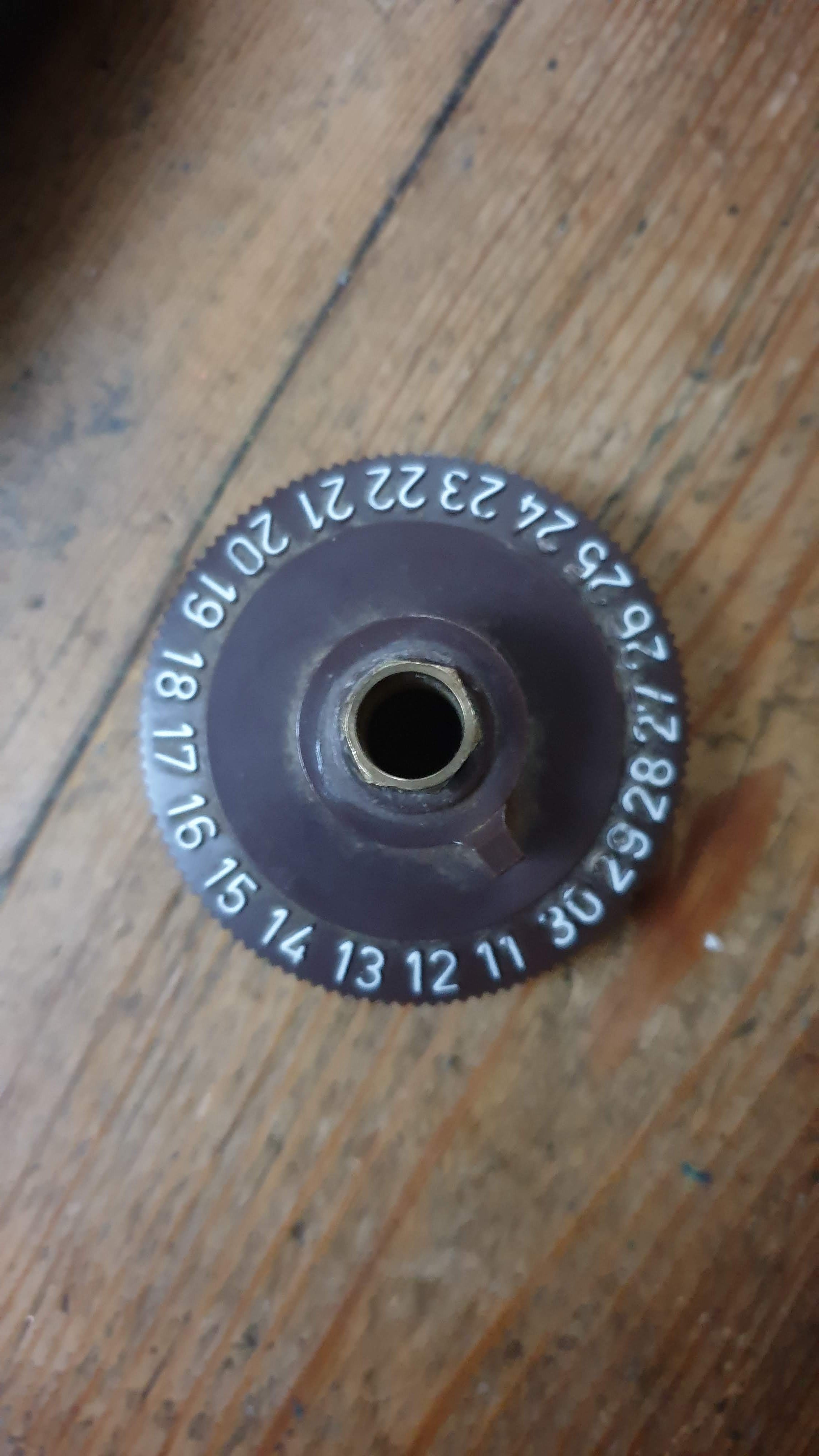

Here's an Update
I have removed the thumb temp control and the thermostatic couple unit that is inside
It seems that the part in the Left picture above is an entire unit.
Inside there is some sort of rubber type valve which seals the unit and if I press down it restricts the Gas flow
So I am simply going to remove all the controls and cap it. This seems to allow enough Gas to power the fire without it going out. Pictures to follow.

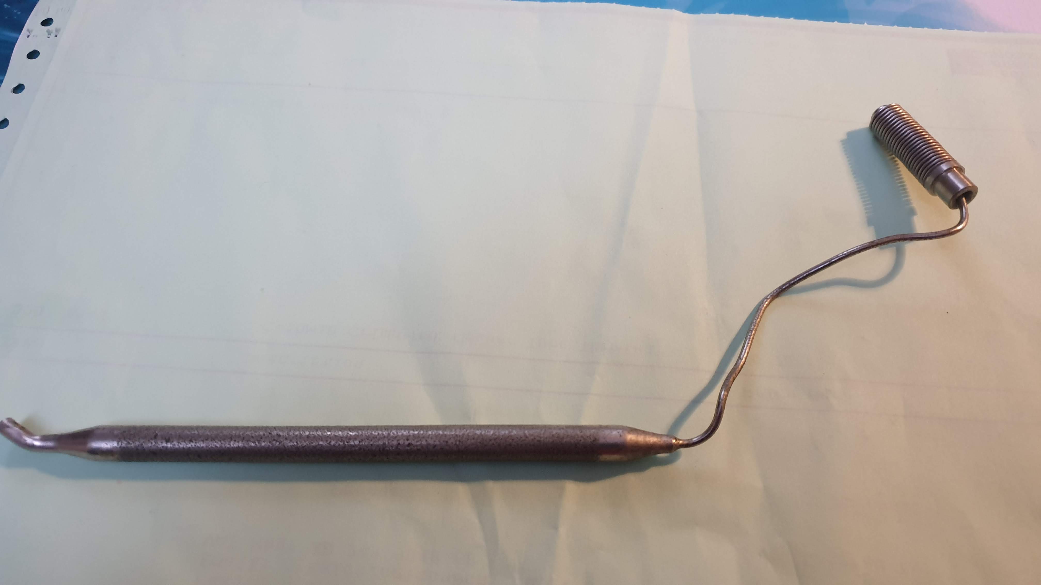

Hiya Phil,
I am not sure it is really a Thermocouple as such - it looks like this and is nowhere near the fire or heater, which means it is more like a temp control or thermostat.
Also have tested it and the part on the end at right is springy but does nothing when very cold substance wrapped around the thermometer looking part on the left
Also regarding a "Pilot Light" I am not really sure there is one and if there is then I think it would be inside the Fire Unit itself and there would be a thermocouple there.
I have had no luck finding an exploded Diagram for the Carver SD2000 but there is a PDF manual at http://www.thomson-caravans.co.uk/advice/maintenance/pdf/carvertrumatic_sb1800_sd2000.pdf
So my solution for now has been to Cap the Gas Control Valve after removing non-working part above
Also with the Screw down function of the thermostatic Dial, I really cannot see how this would ever have worked or been calibrated in degrees of 1 Centigrade, if indeed it is degrees that are represented on the removed thumb screw control

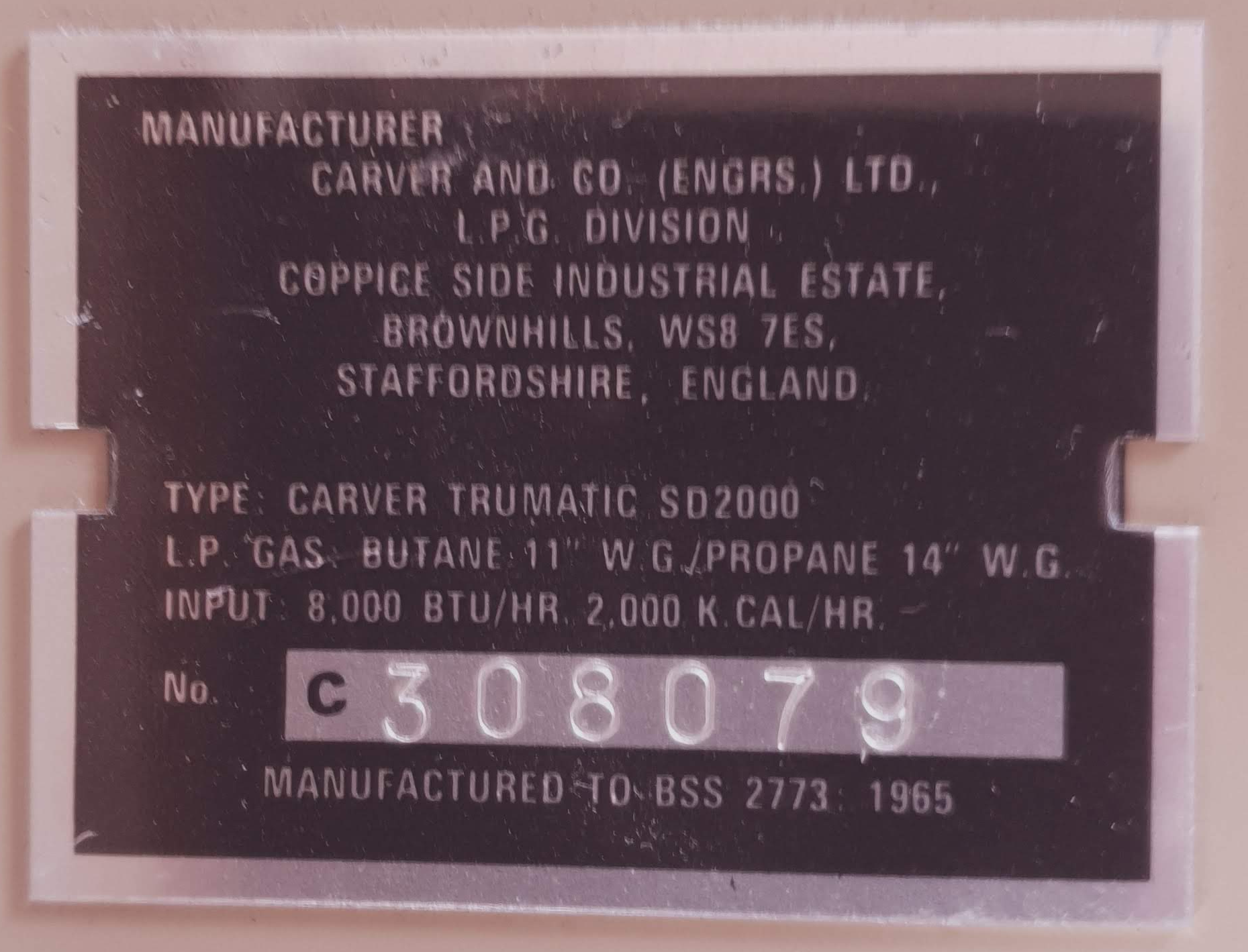

This is the Gas Fire, hopefully it was not made in 1965
Also hopefully no major incidents to follow (y)

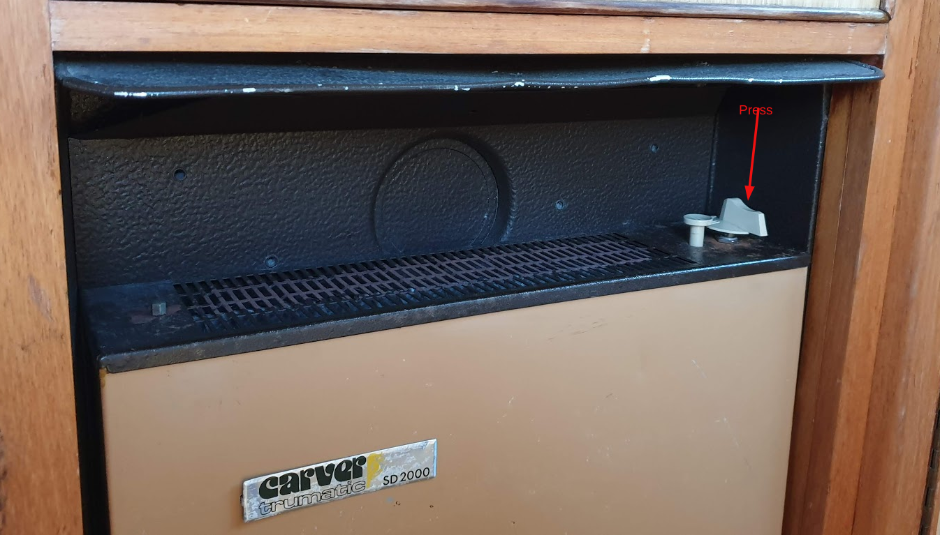

UPDATE whilst in Scotland, Findhorn, here ; feeling windswept, the fire now only works constantly if I press down on the control valve.
Otherwise fire just goes out after minutes or seconds

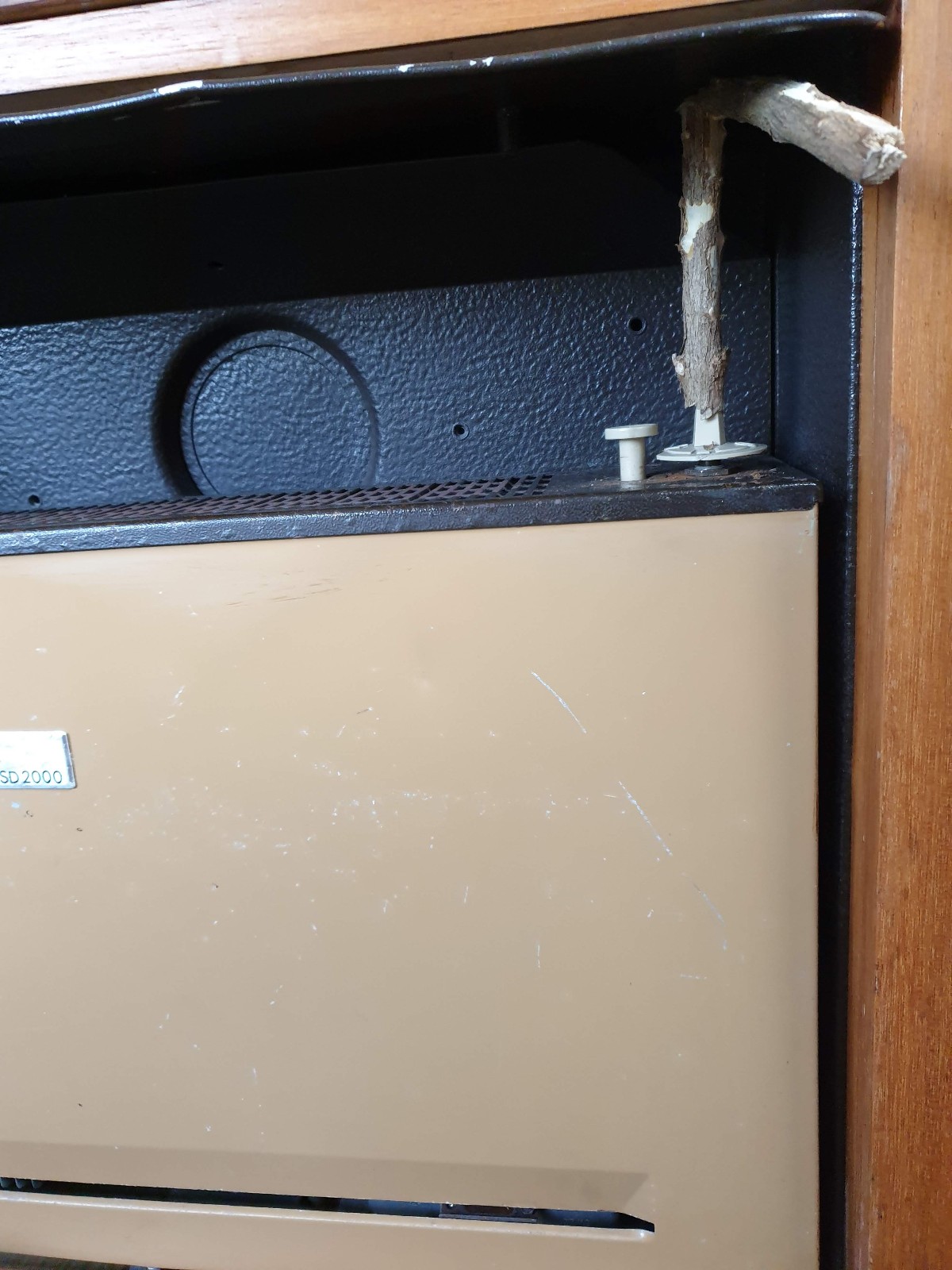

UPDATE 2
Gas Fire is now WORKING
I WILL NOT be using the Fire whilst asleep or away from the Van !!
