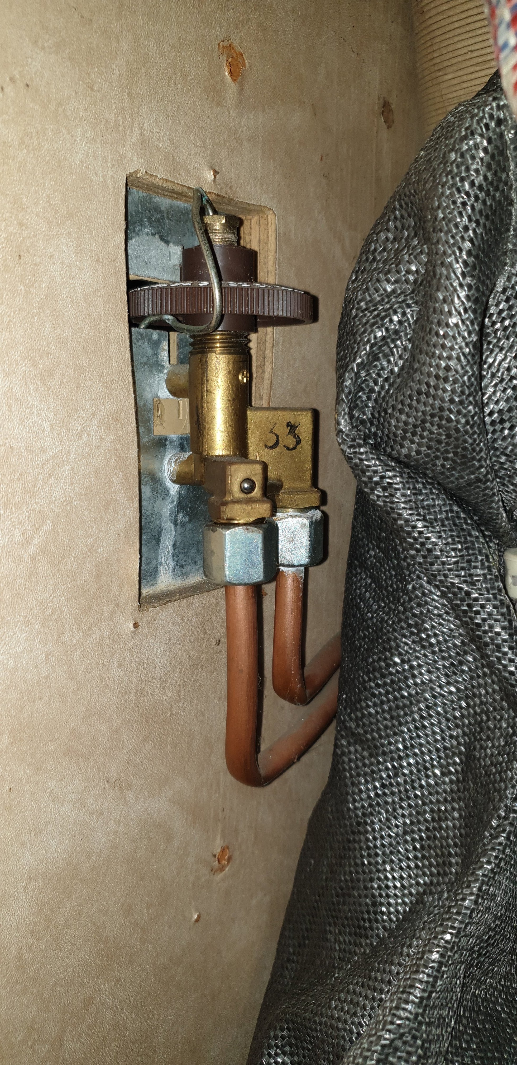

Dear Gas knowledgeable folk,
I have one of these Carver Fires though Gas flow seems low despite thermostat set to highest level of 30 deg
I have taken cover off and it's all pretty clean.
If thermocouple at fault then what's next anyone ?
The fire lights but does not seem to put out much heat, even with thermostat at full 30 degree setting
TIA
Robert
An Update on This although Sadly no-one has viewed it, I tested the fire again today and it sparked up and started to work well, you could hear the burner. I had thermostat up to 30, highest level, tried before but never before has the Gas Fire burner worked so well. So it was working well for all of ten minutes and then suddenly seemed to go out ?? Any ideas ?? Thanks
Think there is a flame out metal thingy in them,bit like a superser ,may require a tweek with neadle nose pliers.
