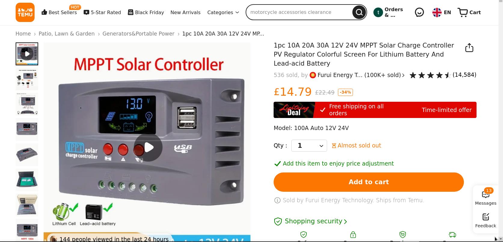

Saw these on temu today, just wondering are they real mppt units, very cheep.
You know what they say, Trev - buy cheap buy twice. It looks a bit brown and sticky, I wouldn’t want to bother to sniff it ;)
