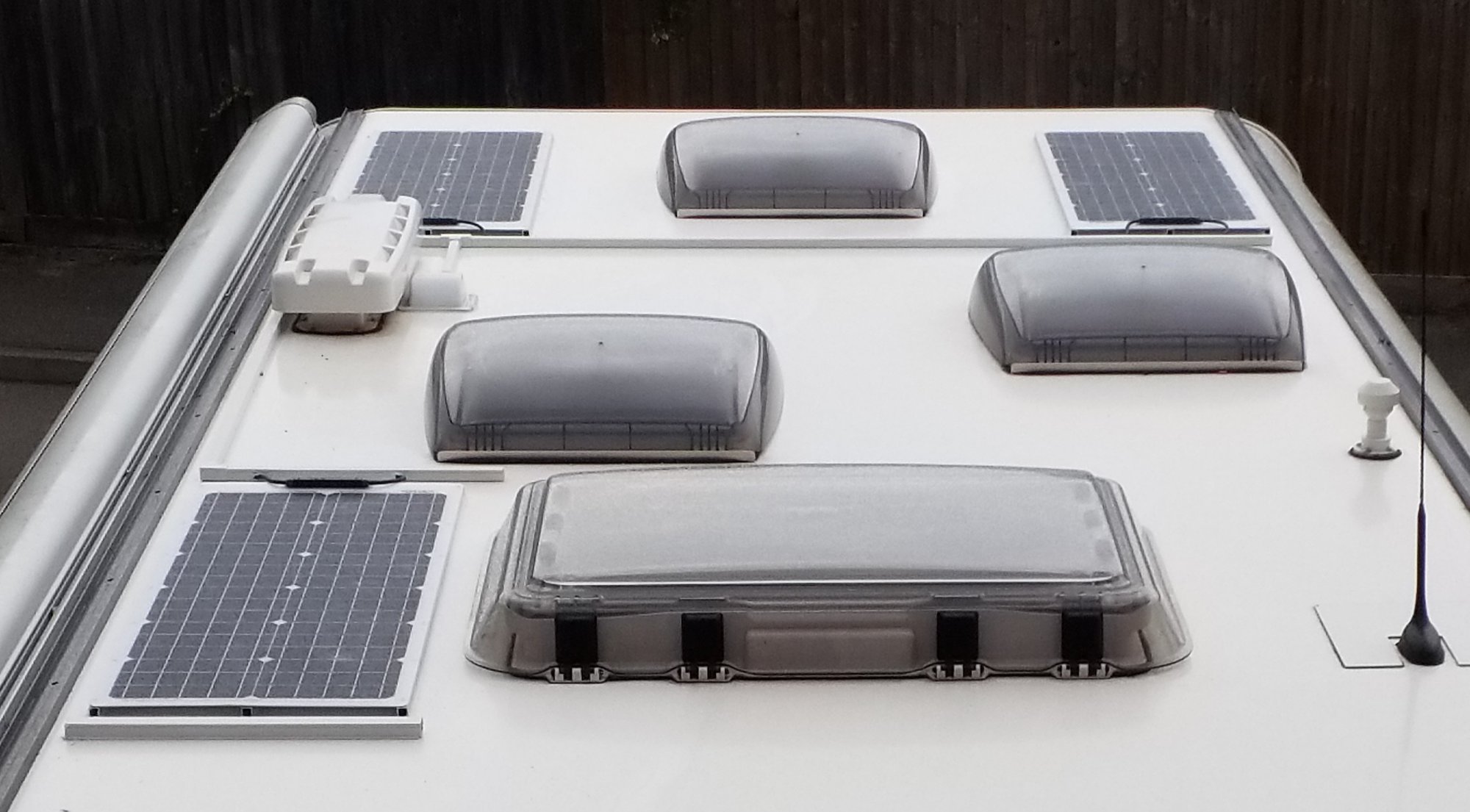

I used 3 x 50w panels because I didn't want to mount one at the very front. I used Sikaflex to glue 3 x 15mm square aluminum tubes to the roof and then pop riveted the semi flexible panels down the edge. Easy to remove if I have to as only have to drill the pop rivets out and panel will come off. The 15mm tubes give a ventilation slot under the panel. The panels don't stick up to high. They are still attached after a blast round the M25. I fitted a piece of trunking in front of the forward panel as a wind deflector. Don't know if it's needed as panel very close to roof. Been working fine last few days.
