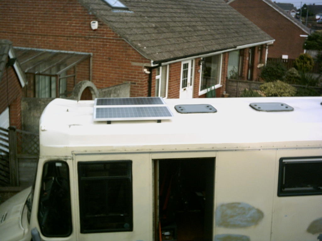

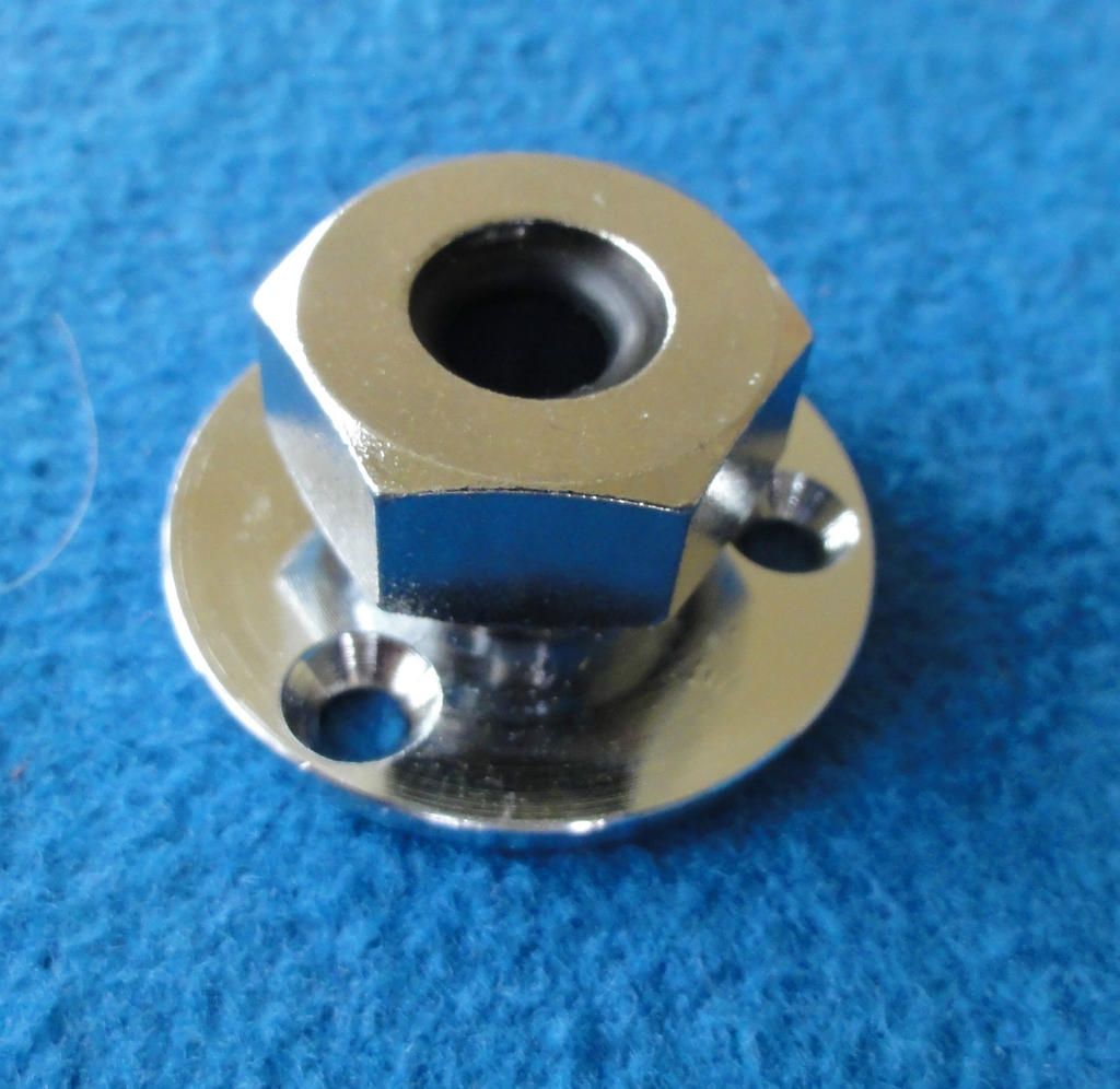

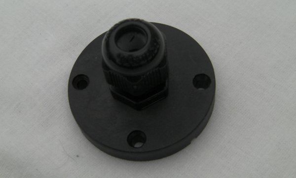

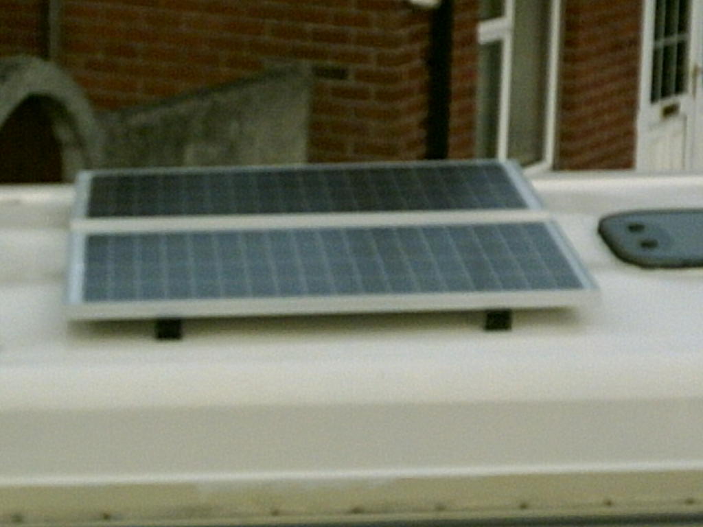

There is a good two & a half inches under mine plus i have the cable entry gland under it,grp roof.
