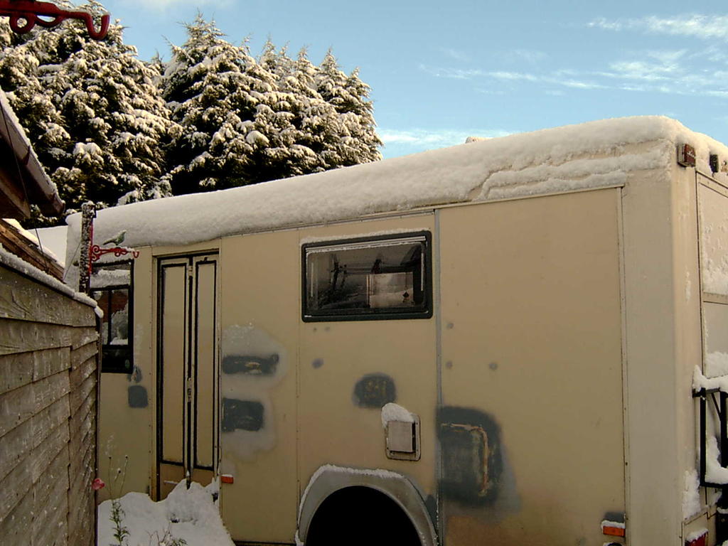

Help for some reason i am getting no power from s/panel,i have checked all wiring and control box/fuses etc,worked fine in the summer, am i missing something.:scared:
problem is they don't work in winter try fitting a lunar panel .
