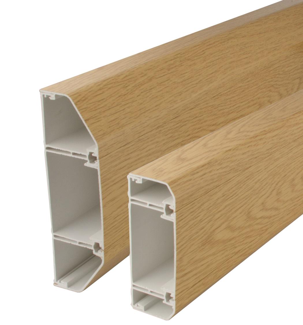

Now it would look nicer if it blended in more as you are said. This trunking is nice gear - https://amzn.to/4h0RBaa. I've used the D-Link trunking internally in the Motorhome, externally on the roof for PV Cable (putting the black PV cable inside some white trunking when on a white roof really looks so much tidier). Also used in the house when needing to run some cables around a door frame. Nice quality.
Generally used the plain white stuff but I got a length of oak effect colour when I had to run some cable from the satellite dish inside my cocktail cabinet and against the wood veneer finish. Doesn't make it invisible but for sure less obvious than white would be.

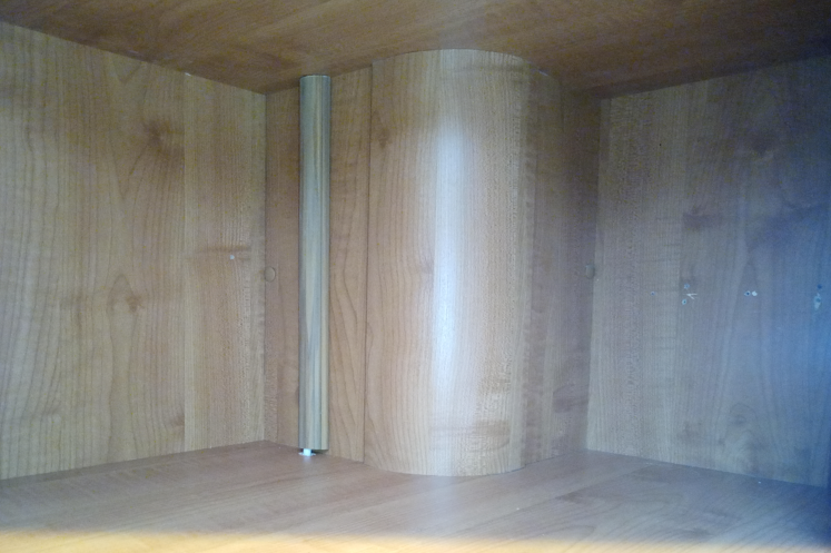

This is the Oak finish D-Line trucking I mentioned earlier in my cabinet
(Cut it a bit short :( ) I think it blends it well enough? due to limitations on where it had to feed downwards, ended up having to go part along the wall rather then the ideal of in a corner.
