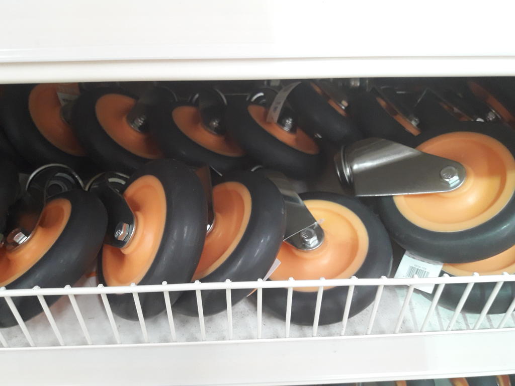

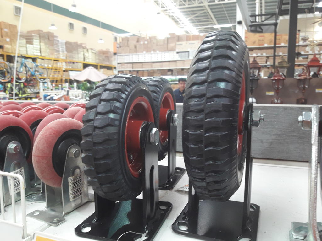

But I would rather use wheels if possible...
Ridiculous prices (low) here...in Thailand..available as well in local "B&Q".
Plan is to buy 2 here and bring to uk in April.

I attach photos and ask
a) which ones would you recommend
b) what size
c) how to fix
