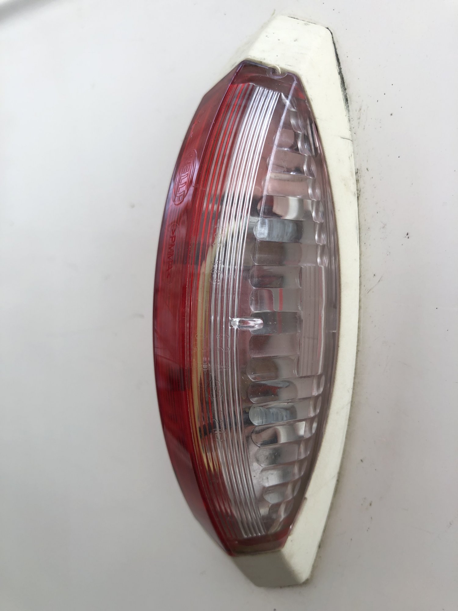

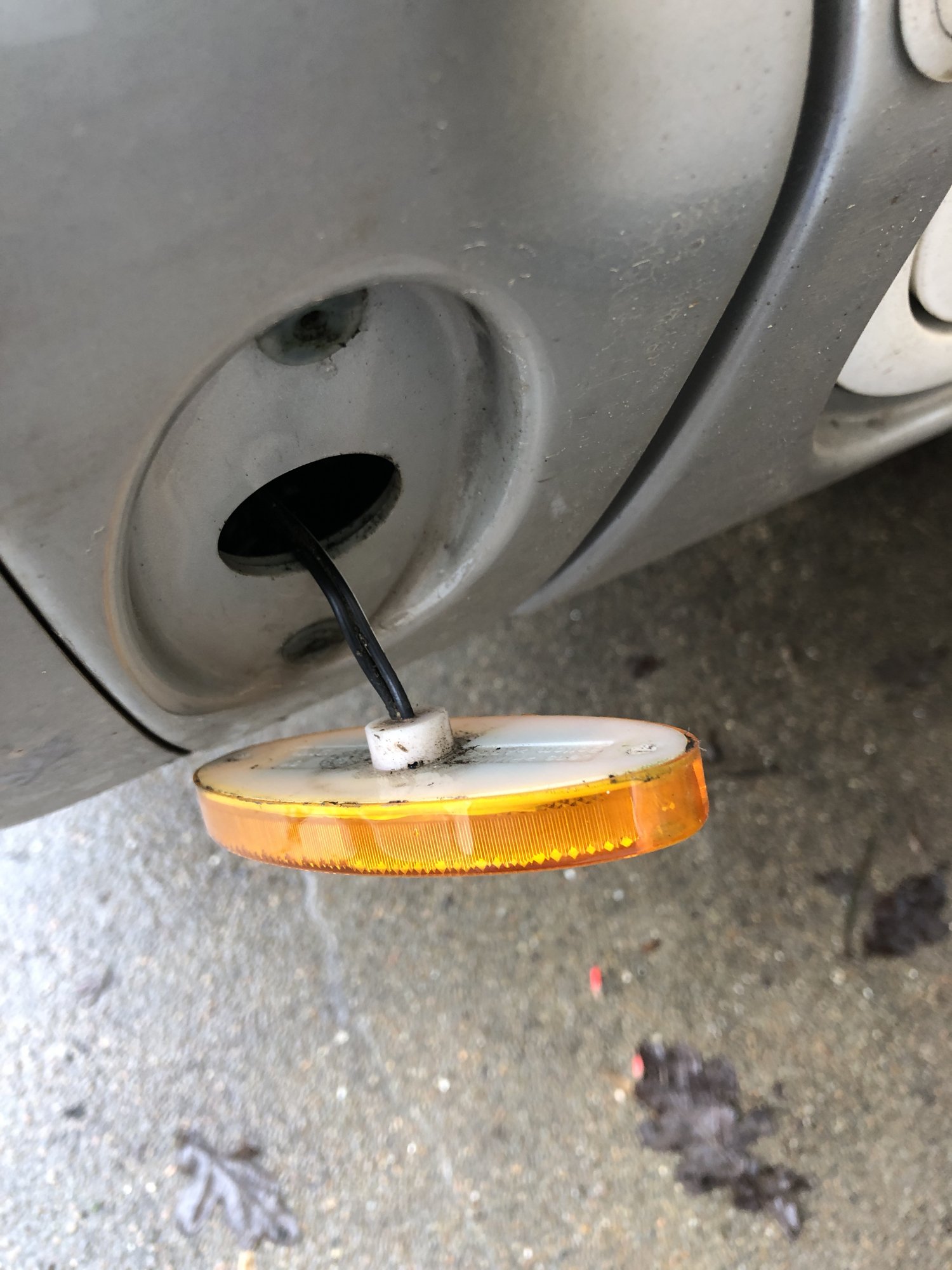

Gosh these wires are so short. I have only a couple of inches to work with!!
Do the lights come apart or are they sealed units?

How does one change the bulbs in these?!!! Can’t see any way from outside.
