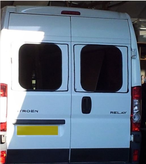

some of these windows have such a small corner radius that cutting the hole square still leaves plenty of surface for sealant . 4 straight cuts with a disc cutter- job done
also i mask up at least 60mm all round a cut
i mark out with permanent marker on the metal panel , then mask up . the marker can be seen easily through the tape , and acetone [test first ! ] remaves the marker
i have often removed the soleplate for cuts in tight corners , but glue on a bit of flat plastic as a temporary soleplate to protect the paintwork .
sounds obvious but hold the panel with gaffer tape before the final cut to prevent having your tootsies chopped off

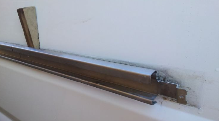

Note shortened SLD middle rails so the door could never hit the window.

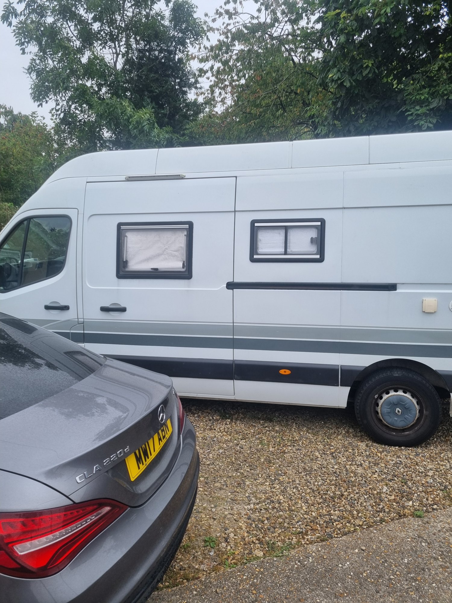

I fitted a couple of new windows recently Kev. One in the rear door and one above the galley. I ordered a smaller one for the latter because of the rail and I also made it a slider to stop the door slicing it off if we forgot to close the window!
All the rest are openers.

This is the bit I cut off, and I used the end bit to fashion a stop for the bottom track of the door but I never took pictures.
