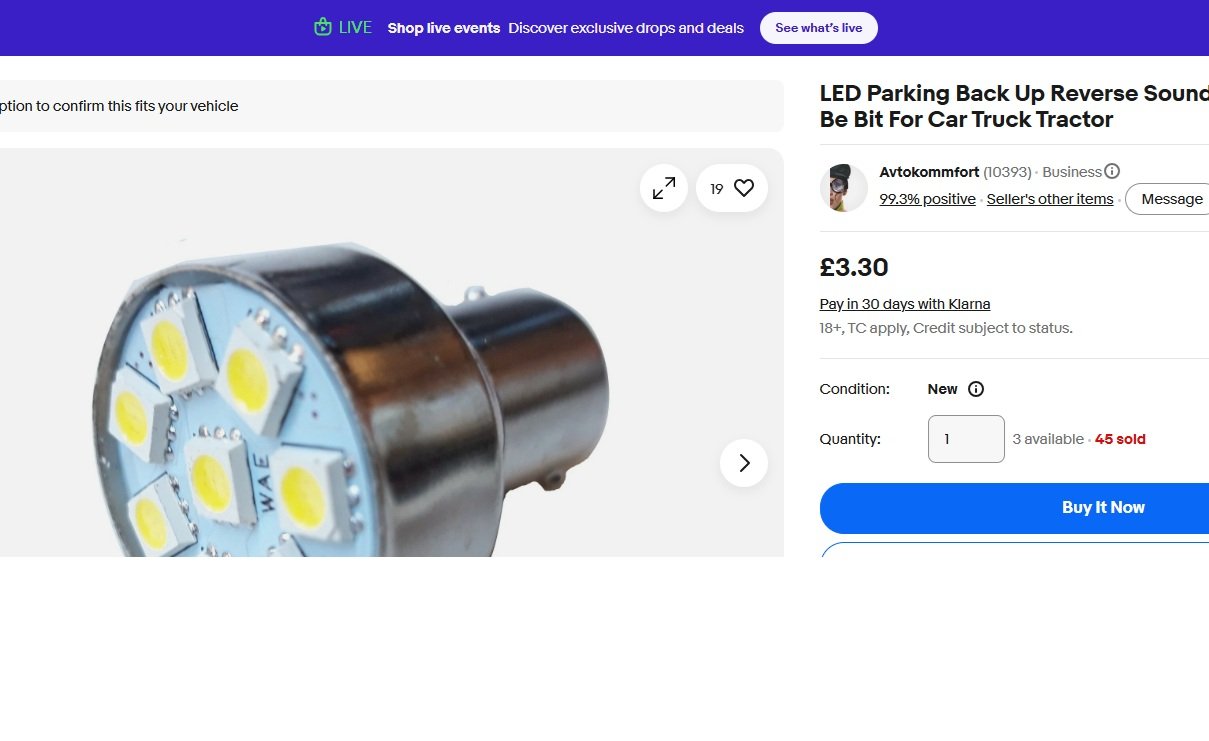

Next time you change the reverse bulb it is worth thinking about getting one with a built in buzzer
It could just save a life.
