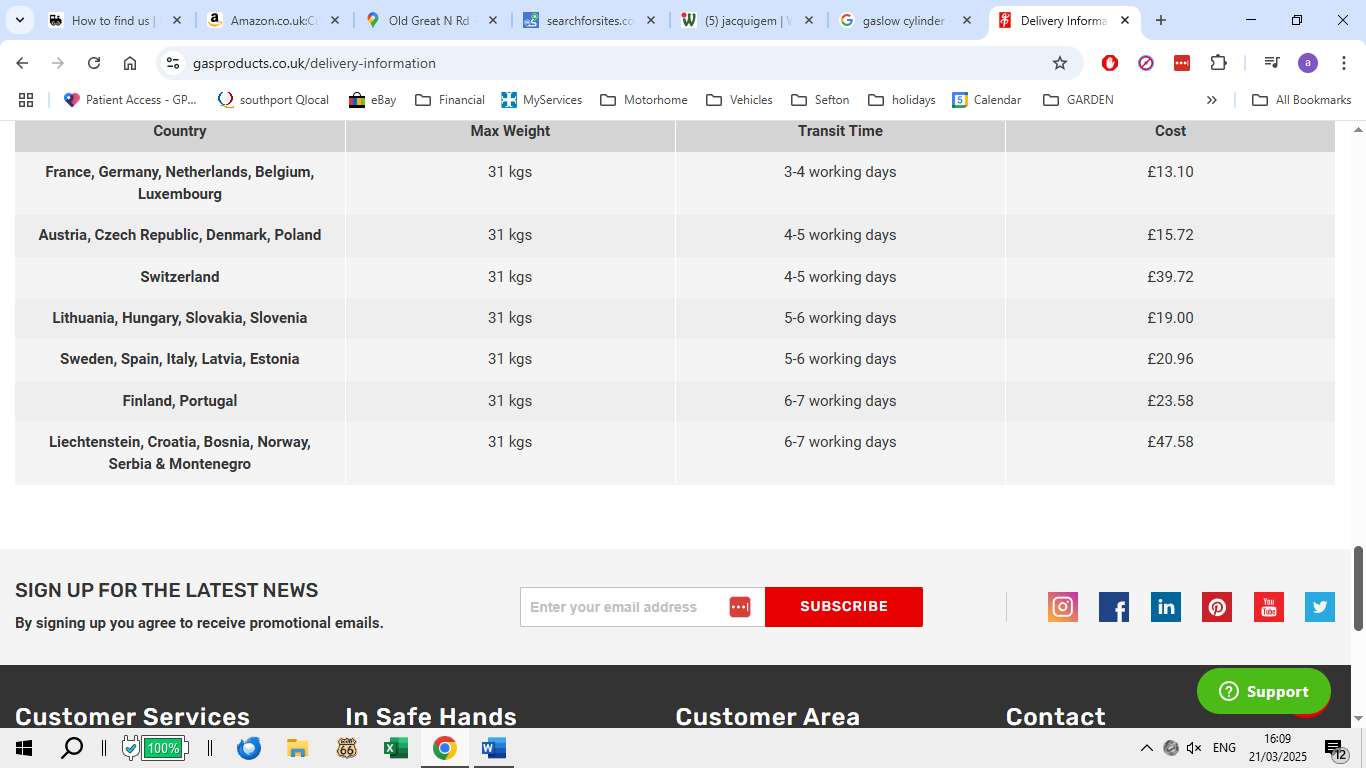

Interesting Gaslows Spanish agents quoted me 1480euros for bew cylinders and pipes.
Assume that price is in UK and not really wanting to go back.
Their website has prices for EU delivery.
I only investigated one retailer, others may be cheaper.

That's helpful , thank you.
I note that they call it a cylinder 2 to be used with an existing cylinder, presumably to increase capacity ?
I would need 2 and there would be no existing cylinder, don't know if that would be a problem.
