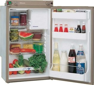

Here is a link to a PDF with a 'conversion chart' showing exact fit Dometic replacements ....I'm looking for a compressor fridge either 12 or 240 volt to replace the three way fridge.
Has anyone here done that?
Any suggestions as to fridges that would fit the void?
Thanks![]()

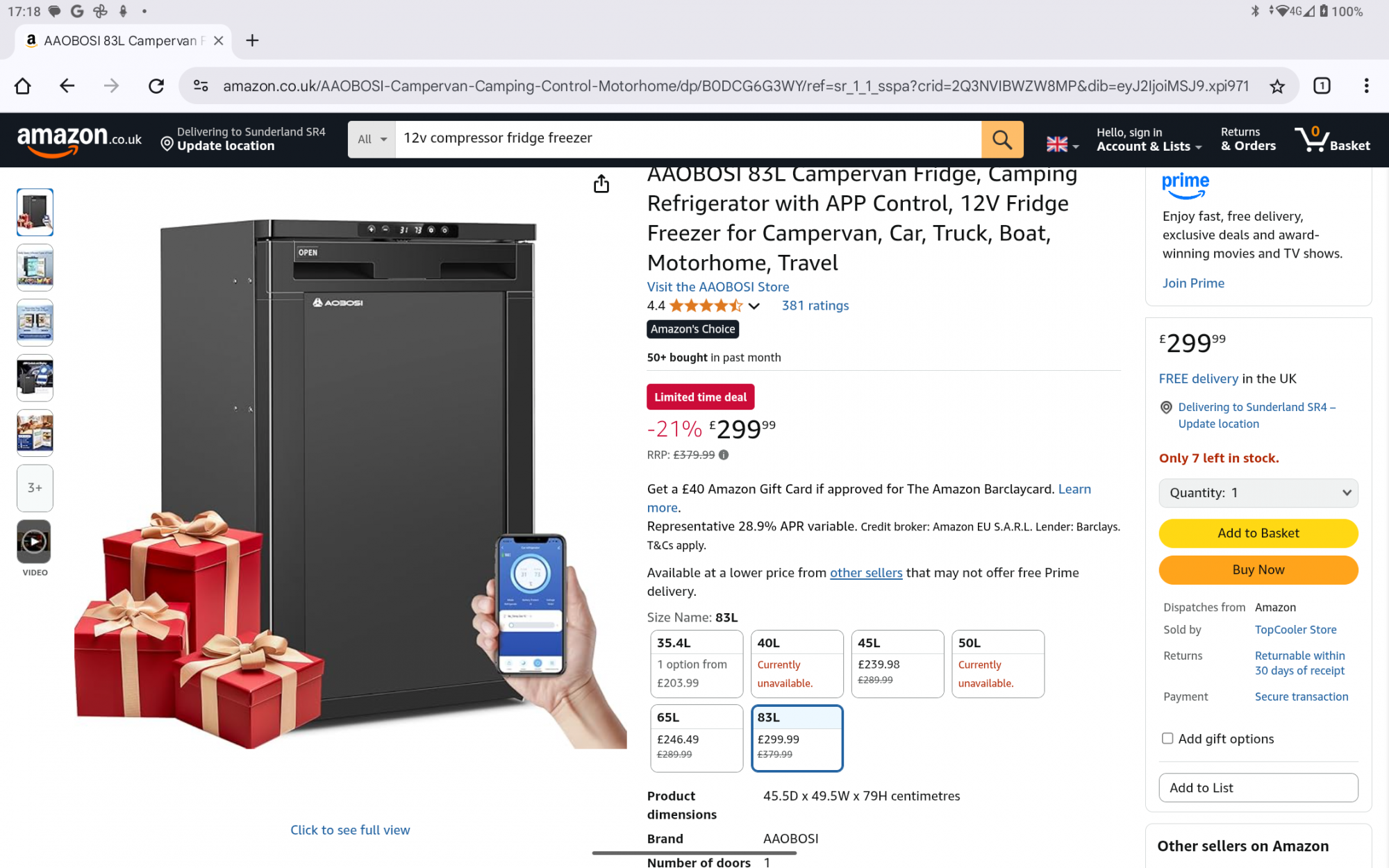

Yes, I posted a link to that one a couple of weeks ago. It's a rebadged Alpicool.Tompa just replace his fridge freezer with a one of Amazon was on sale at £299 12v compressor its a cracking fidge 83 ltr.View attachment 146160

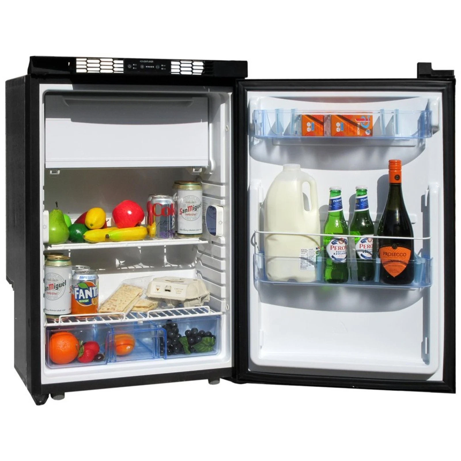

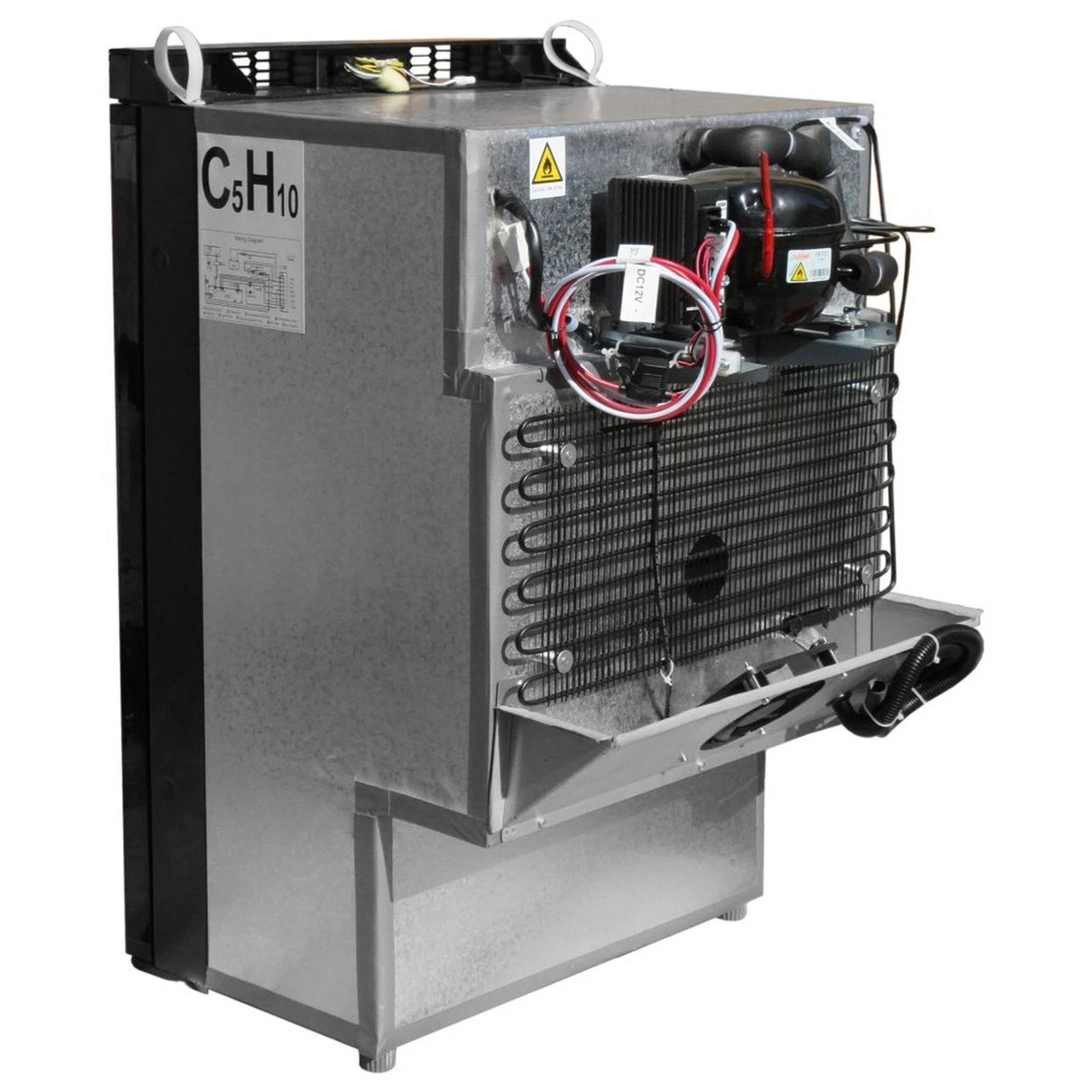

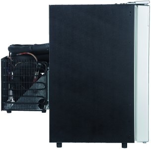

There is (or at least was) a Waeco compressor fridge which had a compressor unit that could be respositioned to allow the fridge to be fitted by a wheel arch. I think the model was the RF40 or RF45, but that was maybe 10 years ago so will by now either have been updated or discontinued I would think.

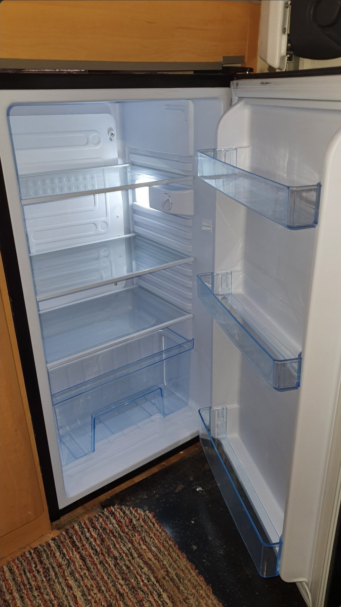

I found this thread but there isn't any description of the installation:I replaced our 3 way with an Alpicool model.
If you can view my earlier posts there are photos of it installed. I did have to fit smaller height feet as it was a bit tight. Main issue I had was my sink drain was directly above it.
Slightly disappointed with the Alpicool's temperature control, it has adjustable freezer values and fridge compartment. In reality it appears that one change affects the other.
Quite power hungry. I can normally survive 2 nights without solar before driving off, thats with 2 x 85a/hour gel batteries.
