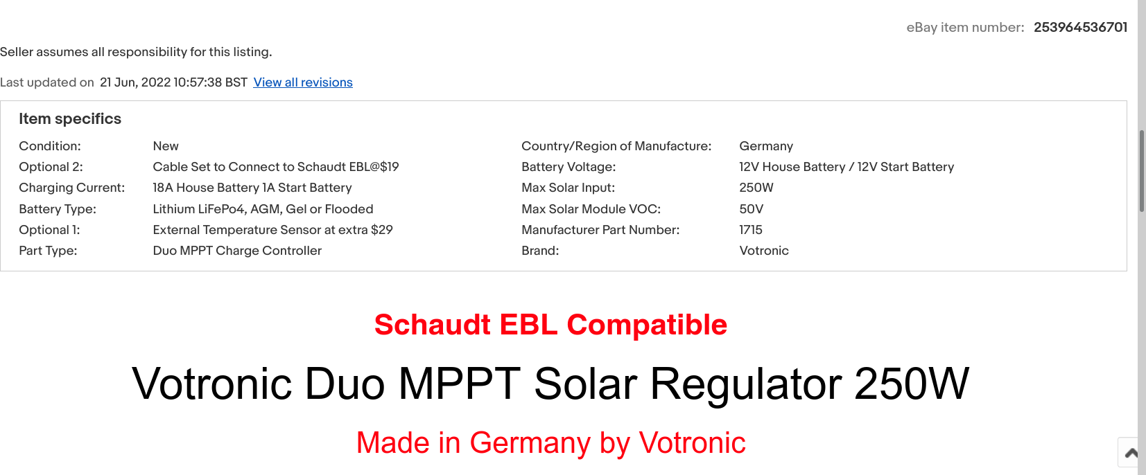

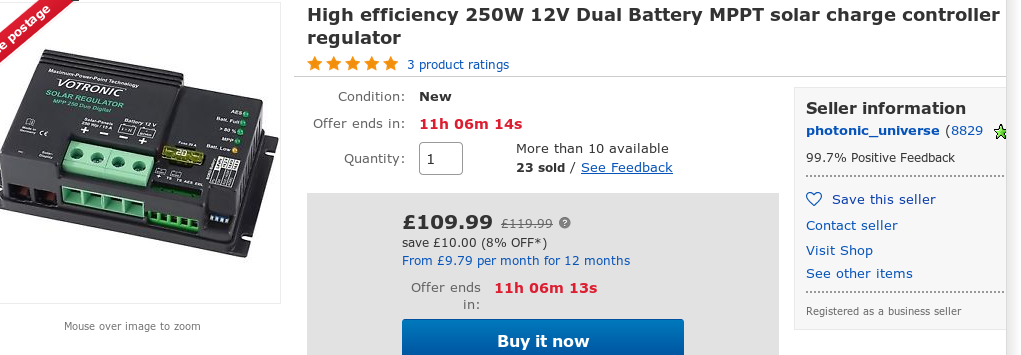

Solar Charger. Between £60-£150 for a Lithium capable unit. We'll call that
essential going by what you say
