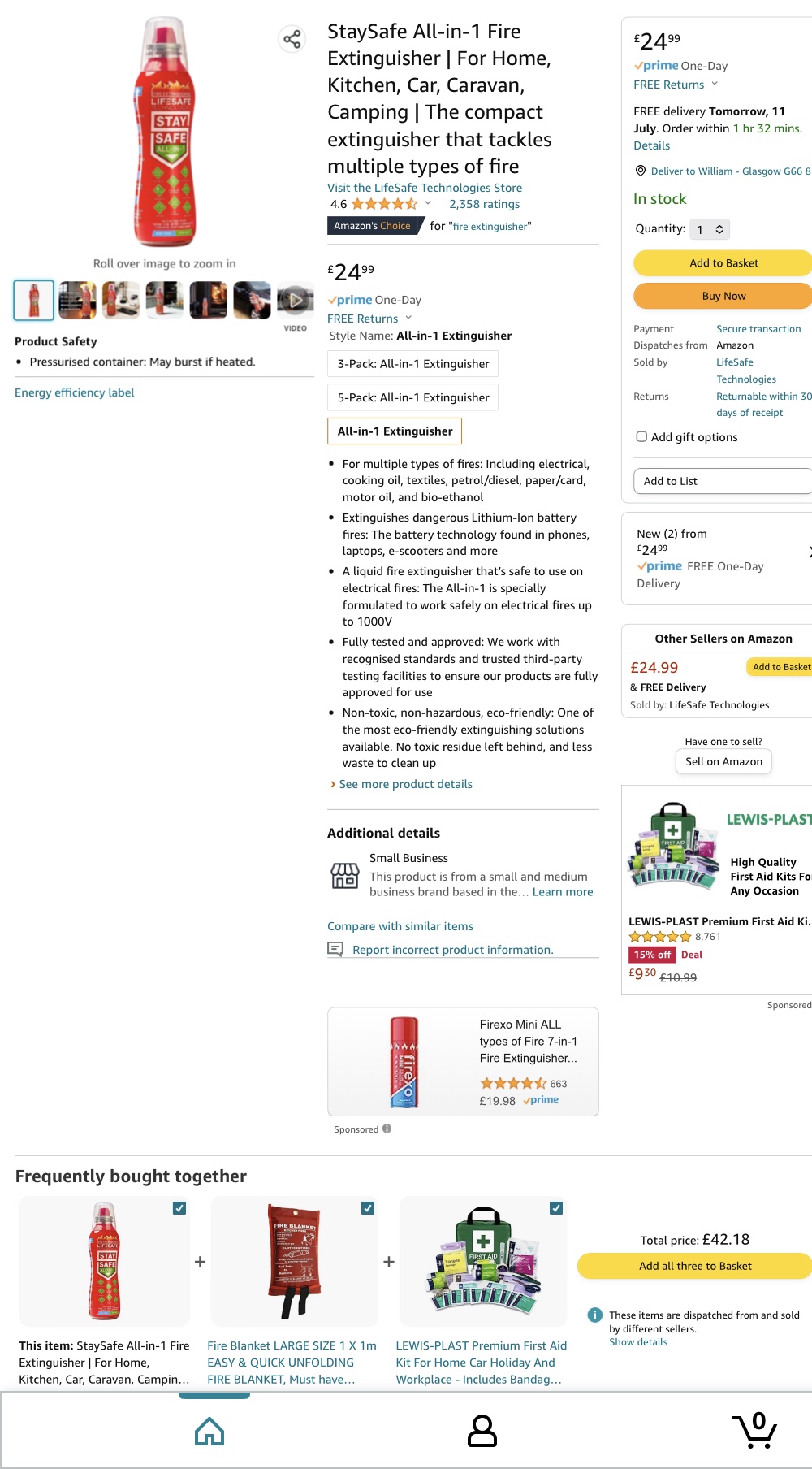

This is what I carry and there’s a video on YouTube showing it being used.
No powder to cake up, no mess from the extinguishing agent, and way more reliable, for just £25.

The Staysafe and Fire Safety Stick are the type I would go for. Versatile, simple to use and store.
Be very aware of the limitations of any extinguisher.
