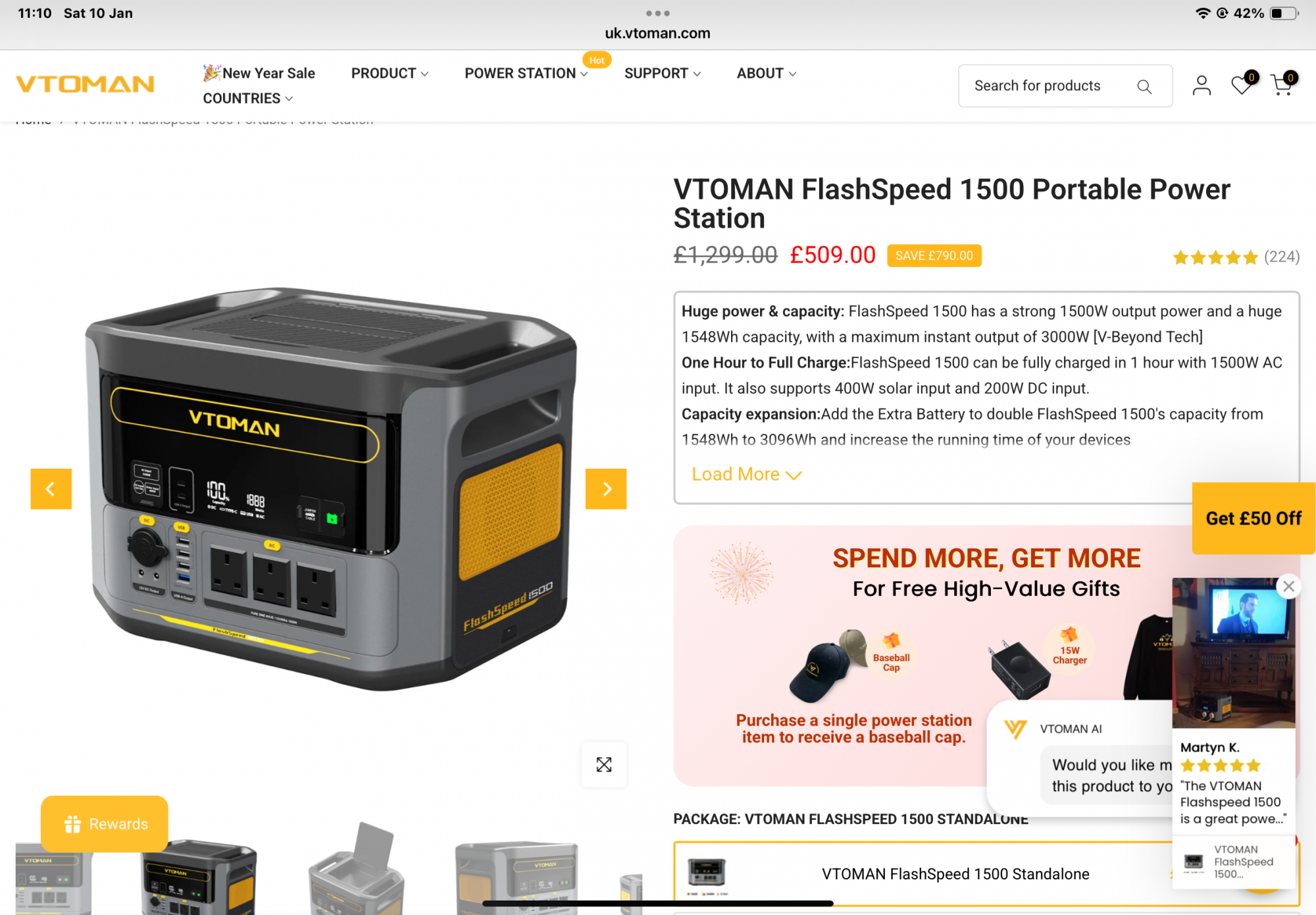

Vtoman for me I also have a jackory but prefer the Vtoman as it can recharge in under a hour but fans are a bit noisy but have came down in price since my purchase also have the solars but big n heavy
