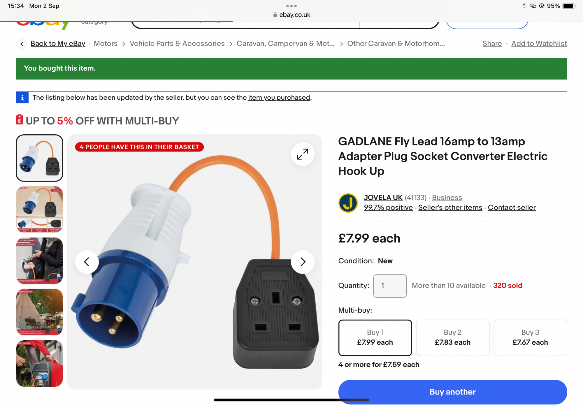

Can it be done?, is it worth doing and from what I’ve learned on here a ‘reverse polarity’ light will be on the Sargent unit, does it matter and will it stop it working and will it cause any damage?.
Yes it can be done, same sort of thing I do if I connect my generator the the EHU socket.

For wot it’s worth I have plugged my vtoman into ehu point and run all things as if on ehu even at Hereford meeting
Down to 20 % on power station plugged in my vto a portable solar panels( heavy23 it’s ) and three hours back to full charge I. Happy

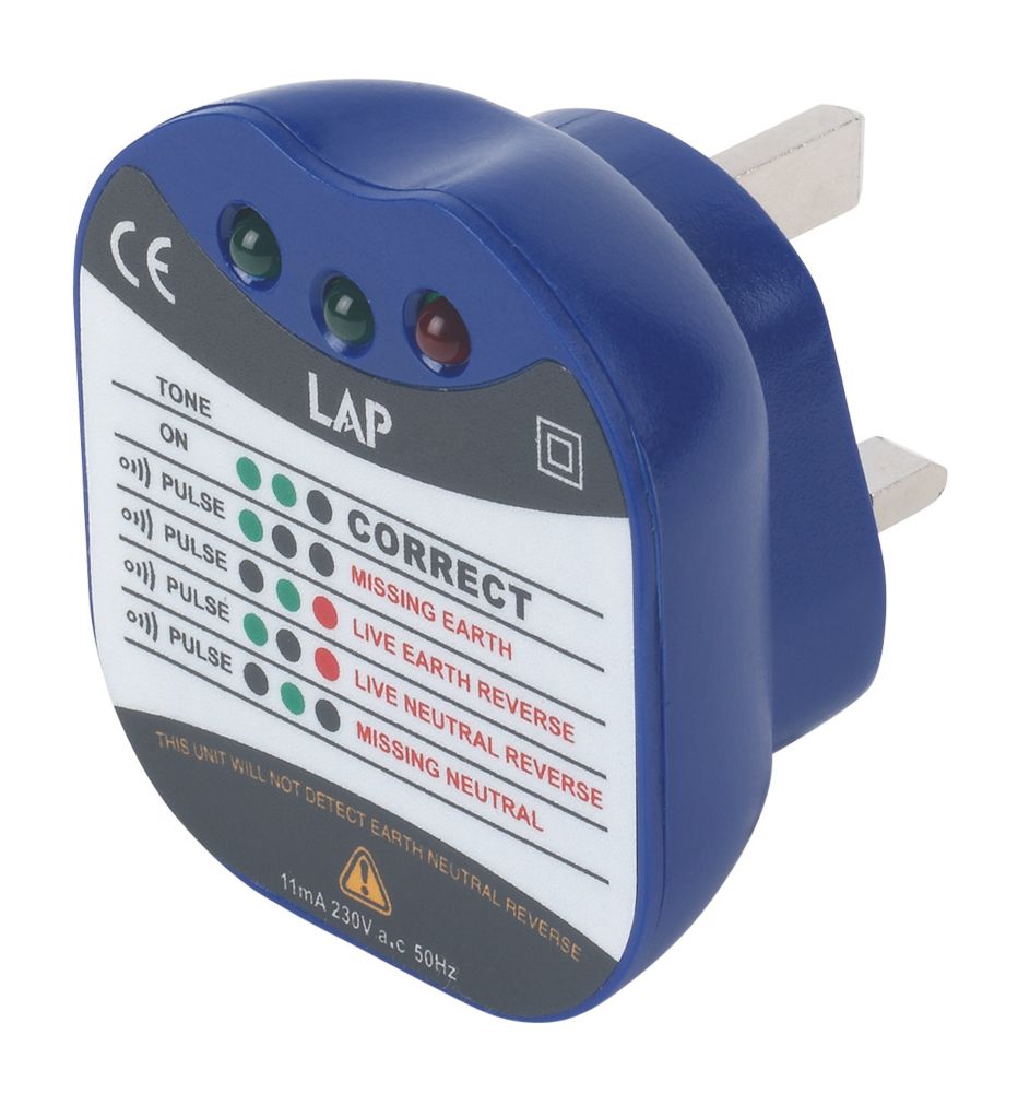

Also carry polarity tester which saved the day at mo r saint Michelle to a French mans delight £16 off ebay
Does far more than test polarity for about half the price.
IMO this is essential kit for MoHo, I even check UK sites, but never found a problem except France.
