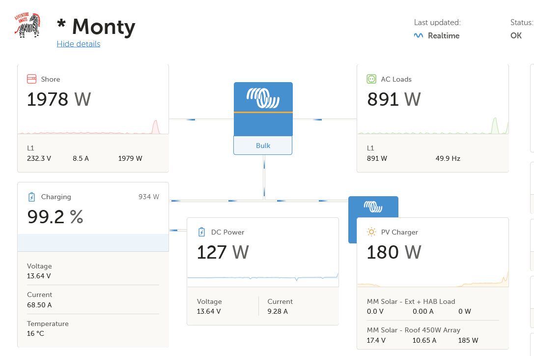

Probably will work. I found my own Power Station - a VTOMAN - is not liked that much by my Victron Multiplus, but the Sargent unit is dumb and would pass the power through ok.

you can do this and it will work. ( I mentioned about the Victron? I changed a setting to allow the VTOMAN to power the motorhome but that is a step you can ignore).
