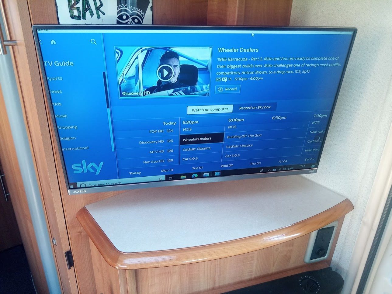

Swapped out my Cello 20" TV for a 24" Avtex Series 9 Pro last week.
One of the key features I chose this TV was it has two HDMI connectors.
Going to use one for a Firestick ...

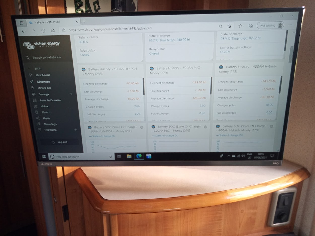

And the other one is for a Mini-PC which can be used for general browsing but a key purpose will be to use my Sky Subscription without a Dish

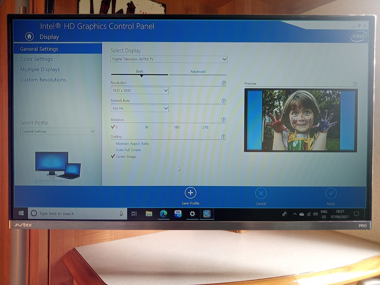

This has a problem however :( Windows users will probably see from this zoomed in shot ...
The screen is overscanned at the default 1920x1080 Full HD Resolution - the tell-tale above is the date under the time has been cut off. And at the top the window controls (minize, maximize/restore and close) are nearly cut off, which IS a pain.
I think this would be a problem for anyone with one of these TVs in fact.
The following shows the issue in more detail and how I fixed it on MY PC (another one may be different, so might have to find an equivalent setting on another one).
So the issue in more detail:
This is the settings at the Avtex's native 1920x1080 resolution. You see the display sides cut off on all the sides
You can choose a lower resolution to get round the problem. But there is a massive amount of wasted screen space doing this.
What I did with my PC is go into the Custom Resolutions tab, enter the defaults (1920, 1080, 50Hz) and then use the slider to find a new resolution that the TV will accept (it is fairly limited) and fills as much of the screen without spilling over the sides
And I ended up with a rather unusual resolution of 1832 x 1030 and 59Hz
and the screen is decently filled :) some more pixels would have been nice but this was the best one that the system would accept and looks fine for my needs (y)

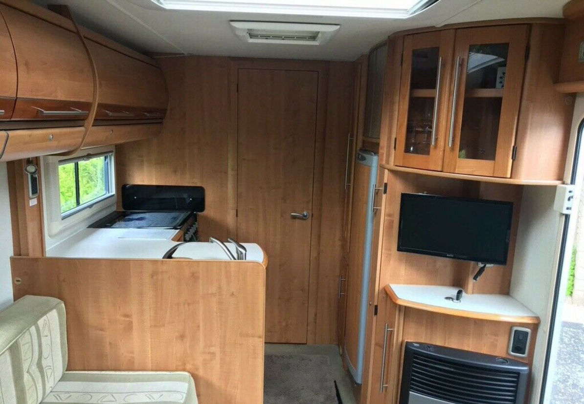

Next mod in this area was for the PC Power. Comes with a 240V AC to 5V DC adapter (so USB voltage levels), but the current is 2.5A so more than the typical USB Port. So made up a little box with a neat 12V-5V adapter
I use this nifty little converter - https://amzn.to/2T3VrKg. Rated at 5A, so plenty of leeway for a 2.5A demand, and as well as having standard connectors for 12V Jackplug in and USB Port out, it also has screwdown terminals for In and Out as well, so a very flexible little unit).
Added a little rocker switch so can turn it off without having to unplug it from the socket
Whole thing very easy to do with minimal of tools or electrical know-how
And placed behind PC that is stuck to back of TV
Where the TV is placed I have just one 12V outlet - a combo TV12V and Aerial socket. And not only do I need more, the position of that socket stops me putting the TV against the corner as the plugs stick out :(
So added a triple 12V adapter fed by the original 12V socket for the plugs and also swapped the aerial lead for a right-angled one to allow the TV to go much more flush.
I would have liked to use CBE fittings there to match but the side panel was a touch too slim for the cover to fit. Hidden by the TV anyway so no big deal.
The two sockets are for the TV and the PC (the Firestick is driven off the TV, so when the TV is off, the Firestick is off (I think!)), which leaves a spare socket? The third socket is available for something like a SmartSpeaker (Amazon Echo for example) or maybe a Soundbar for the TV, which seems a popular add-on, so just a bit of future-proofing there.
There is the question of is it ok to run 4 12V sockets off of a connection originally used for 1? A good question and I am happy with it for the use I have. The TV is low power - certainly I am sure lower power than the TVs that would have been around when this motorhome was brand new, and the PC is a remarkably low 12.5W so that is tiny. An Echo is a tiny power consumer - less than the PC and the Avtex soundbar is also very little at under 1A at 12V, so the total maximum is not a great deal at all.
The actual original cable was also pretty substantial - 2.5mm2 at least so well up to the current drawn here, but I certainly wouldn't be wanting to be using all 4 sockets at their nominal design current of 10A each!

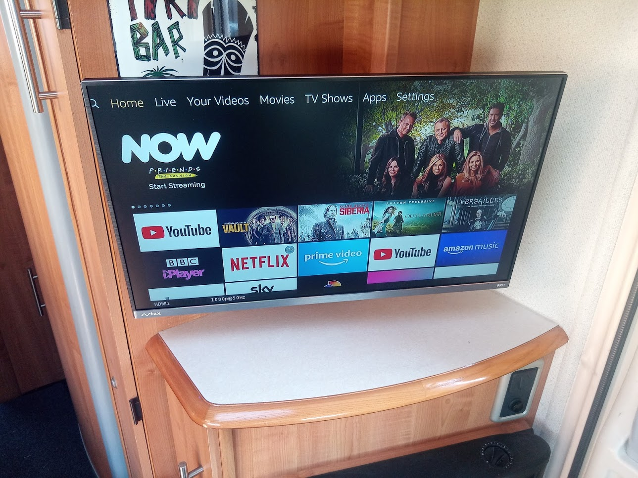

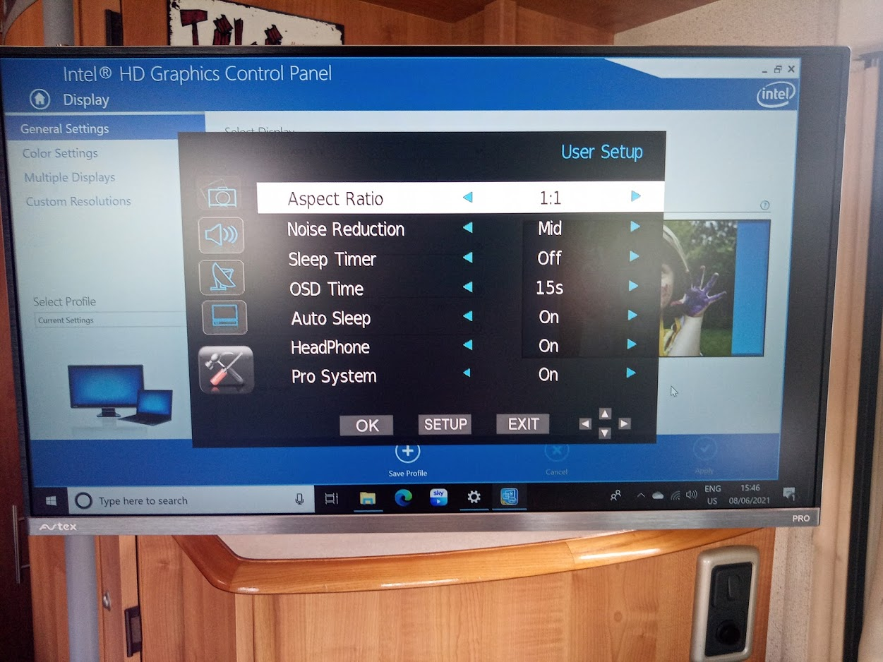

I mentioned an issue with the PC display overscanning on the Avtex in an earlier post (see a very brief summary below)
I called Avtex about this problem yesterday when I found it and they advised there were no settings to adjust this on the TV and would need to adjust the PC - so this is what I did as per my earlier post.
But then I noticed the Firestick had the same issue and there was no way to adjust that, so decided it was just not right and needed to delve deeper into the Avtex options ....
And found the setting to fix it (y)
You go into the menu, into the settings, and then 'User Setup'
The Aspect Ratio default is "Auto" - that results in an overscanned picture (maybe deliberate as sometimes you did used to get those visible scanning lines top and bottom on some transmissions), but if you change the settings to "1:1" you get a true 1920 x 1080 image
It looks like these settings are set for each input, so I had to select the first HDMI input (Firestick), into the menu and make this change; then select HDMI 2 (PC) and repeat the setup process.
So that is that sorted out - but I won't deny I am a bit disappointed at Avtex for not being able to advise me of these settings to start with :cautious:
Since when have technical support staff understood the products they represent?
I guess I expected better as read some comments on a couple of forums about them being very good (and when I worked on Tech Support, I used to know my products better then the customers (always a good start :D ))
I was tempted to call them after I found it today, but decided sod it, fed up with calling suppliers to give THEM correct info (would be the 4th one in a week) - it is meant to be the other way round! :mad:
I had better luck with Avtex and for the issue I had was told to select 1:1 for the aspect ratio. What I hadn't appreciated was that each 'Source' has its own 'Setup' menu e.g. that setting 16:9 in TV doesn't affect the other 'Sources', unlike our TV at home.
Having independant settings for a source is definately a bonus.
I find the Avtex manual pretty poor I have to say - it doesn't mention these options, and as far as going into the general "User Setup" it says something like "go to 'User setup'" but doesn't explain how you do that. For people who are not that familiar with this kind of technology, it is a poor show.
Customers are not supposed to fiddle, they are not qualified. ;)
Actually the guy I spoke to (who said, nay insisted, there were no adjustments possible) gave me the "special" 4 digit code to get into the manufacturers setup to try something or other, but said it would make no difference and I didn't try it anyway (forgot the code!).

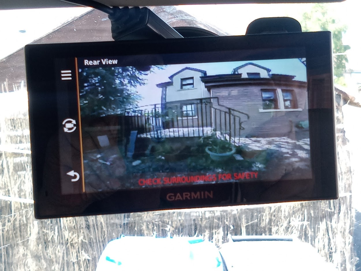

I was intending to sell my Garmin Camper Sat Nav and use the built-in SatNav on the dash system that uses Google Maps, but after I used it the other day when out, it was a bit frustrating with the 'noise' you get with Google Maps with the links and stuff covering up half the map :(
Plus the Camper version can be good for stuff like width restrictions and so decided to get it fitted :)
Plus, it also gives me the Camera Options which are handy (y)

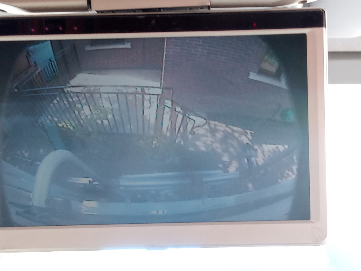

The Cheyenne has a backup camera with a high level mounted camera pointing down, but the display, despite being nice and big, is not very visible to use.
In contrast, the Garmin Camera, which I fitted at numberplate level gives quite a different angle and also has the benefit of (adjustable) guidence lines and much better visibility.
This is the position I choose for the Display
Pretty well in the standard rear view mirror location, so nicely out the way and power is routed via an overhead console.
And when it is showing the Backup Camera view ....

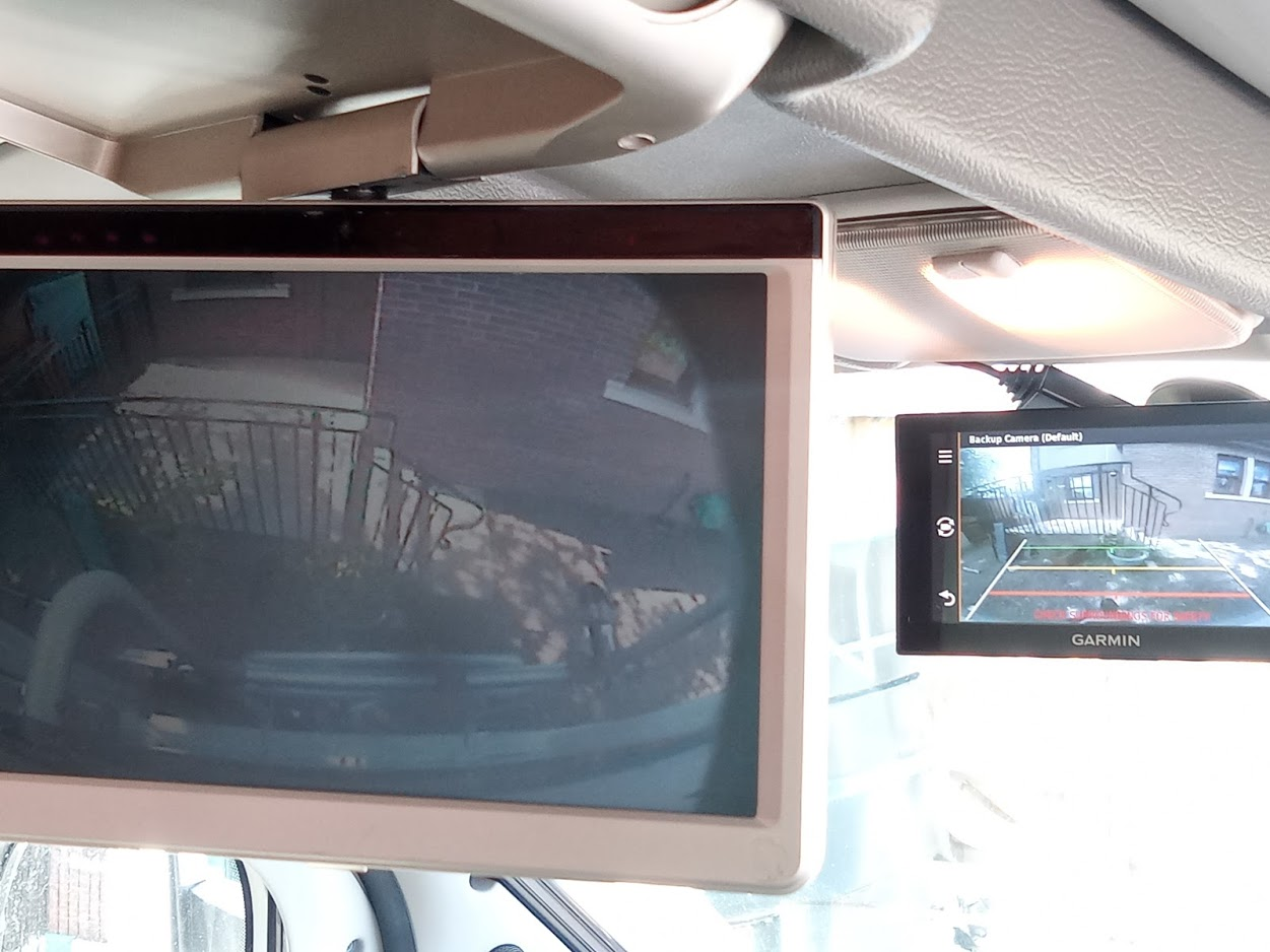

Plus I have a second camera, pointed directly back to work as a rear-view mirror which will be handy for general driving.
The Cameras I bolted to the Numberplate and routed the power to a rear light cluster
Bit of a comparison ... original Backup and new Backup displays "side by side" - so I could use both, which could potentially be useful in some situations as the views are different.

Tried the newly installed Garmin in the Motorhome last couple of days on a trip away and around 150 miles.
As a Sat Nav System, I really do prefer it to the Google Maps, not least as I can actually easily see it! I don't wear any glasses for Driving but I do for reading and to use the Dash system (which is essentially an Android Tablet display) I need the glasses on.
But the Garmin unit is designed for use when driving. (this is one reason why I am not a fan of the "don't waste money on getting a Sat Nav, use your phone" argument).
As a Reversing Camera, it is definately better than the factory fit setup. The visibility is much better and having the guidence lines is very useful.
As a Rear View Camera, it certainly works but is less successful. You get a very slight refresh pause going on. Calling it a stutter is too much, but it is not a totally smooth view as you would see in a mirror and is not present in the reversing camera. I am guessing it is a video bandwidth thing as there is lot more changing. It is also a case of "objects in mirror are closer than they appear" and very much so. I think it will be useful in many circumstances still as there is a bit of a blindspot on the drivers side due to the way the mirror can be positioned and how I have to set my seat, so this could be a useful extra aid.

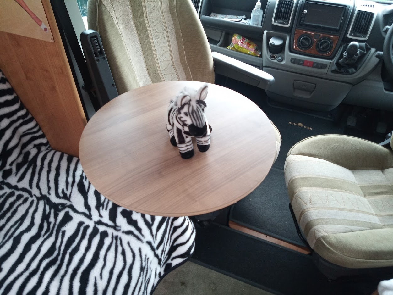

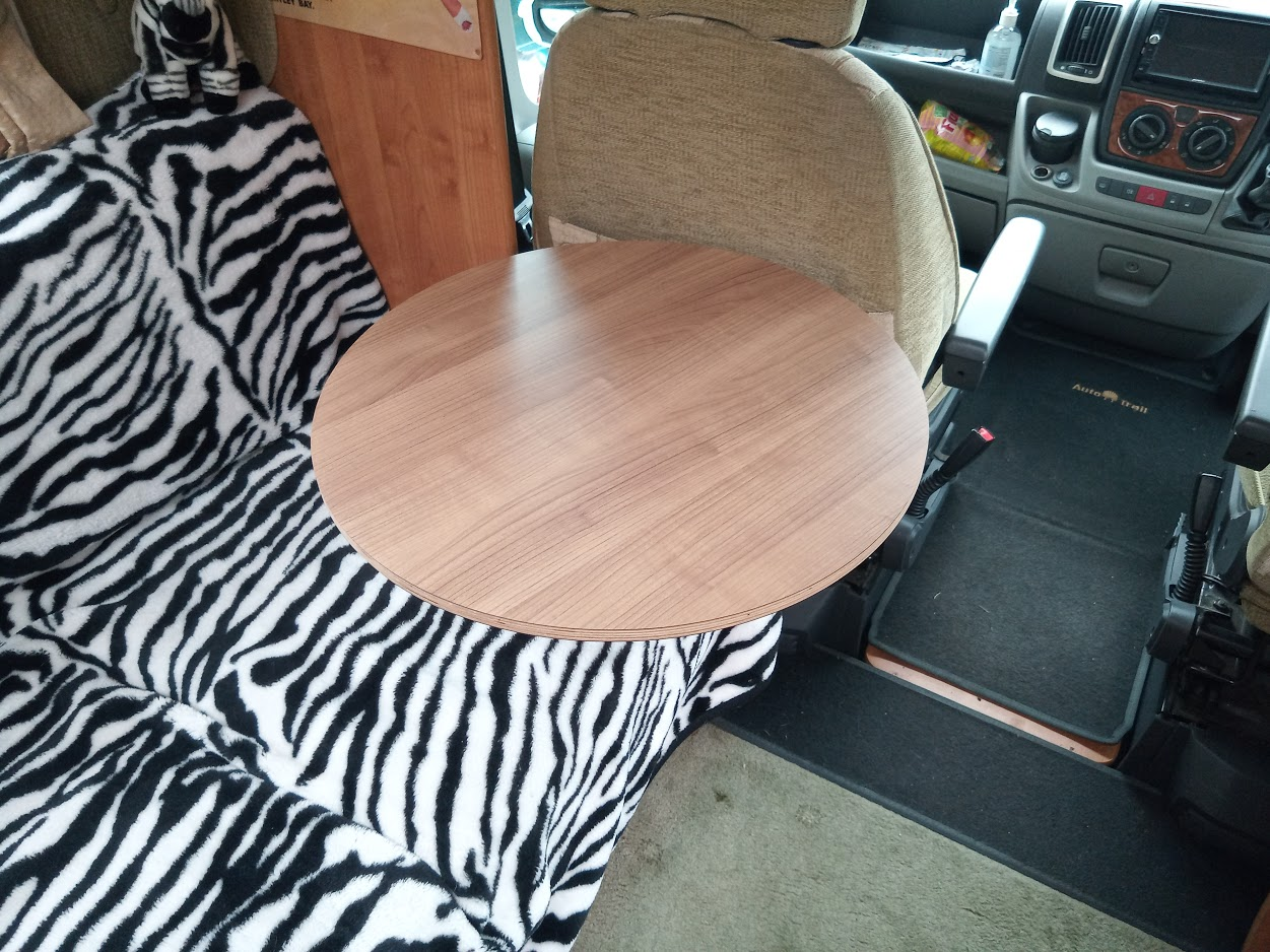

I ordered a Tabletop for my Lagun Table from a specialist campervan carpenter (https://chippysworkshop.co.uk/).
Not sure what finish I wanted and in the end opted for a top with a Dark Walnut Finish on one side and a Pale Walnut on the other to kind of echo the Light and Dark finish I have on the top cupboard doors. It is not as close a match as I hoped for (limitations of cameras and monitors to use to compare) but still a pair of nice finishes.
And the interior
I will need to select which finish I decide to have on top as the Lagun support plate gets screwed on underneath the tabletop so can't just swap it over if I change my mind.
Initially I was thinking of having the darker finish on top, but maybe veering to the lighter instead? What do people think? (cat demanded to be included in the shot!)
PS. Little matching corner quadrant is for something else which chippy made for me at the same time ;)

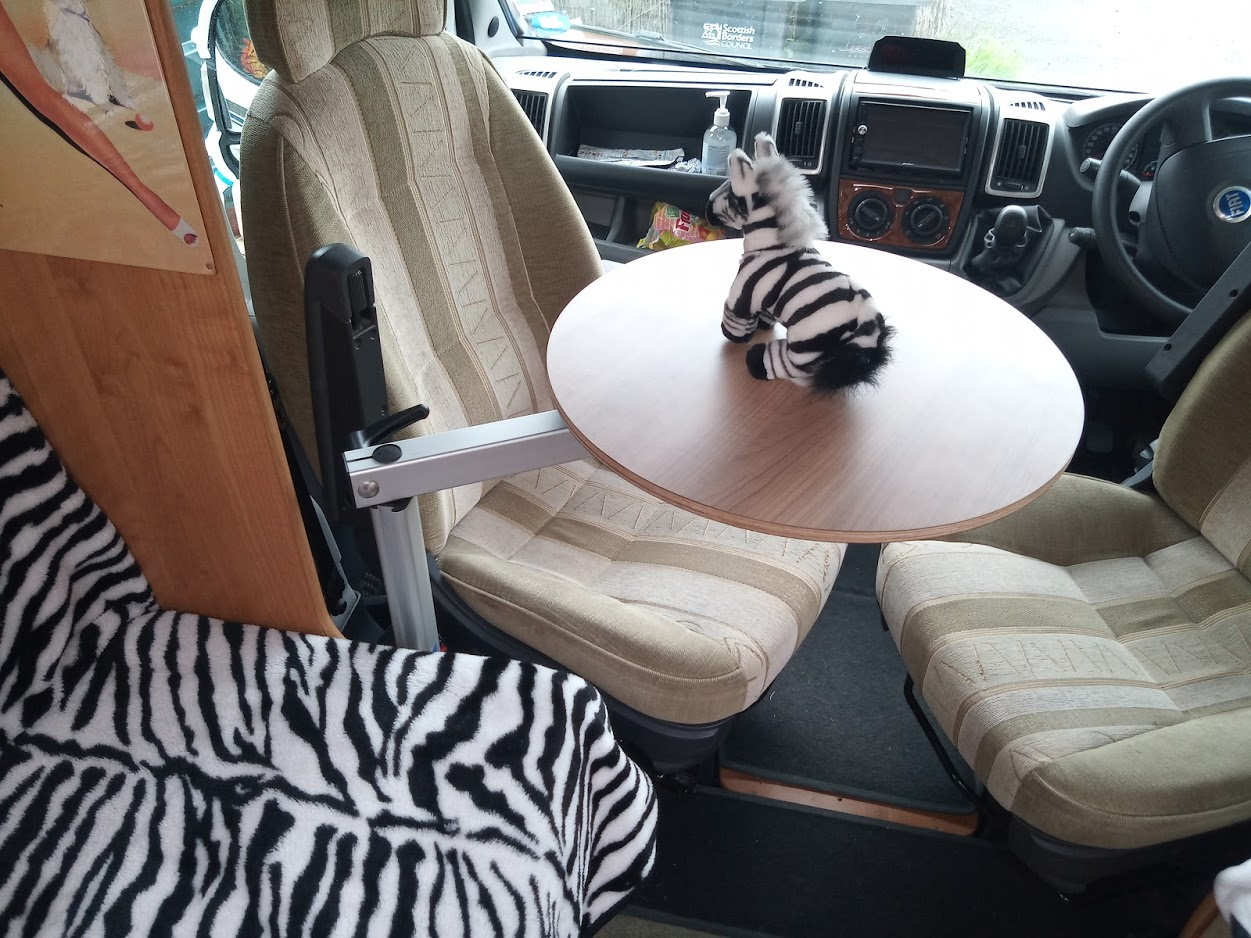

Now onto the table mount ...
So Mounting is complete!! yea - only 6 months after buying the kit!
Unsure what kind of tabletop to have at this stage apart from where to fit the mounting plate. Could go very traditional with a standard wood effect to match and blend in with the vans woodwork.
Or could go a bit more funky? I like this guys work and have seen it "in the flesh" also and is nice quality - https://chippysworkshop.co.uk/
To finish off this thread, I did get a tabletop from Chippys Workshop (https://chippysworkshop.co.uk/) in a wood effect top and bottom. Originally thought I would have a rectangular top but went for a round top instead - size is 55cm.
Decided to have the pale walnut on top, so fitted the mount on the dark side.
The mount is fitted off-centre to allow maximum flexibiliuty of the Lagun system.

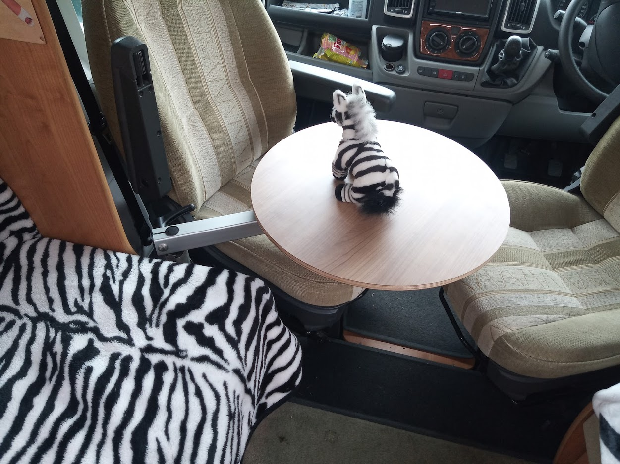

Then just a matter of dropping it onto the mount. The following series of photos are just with the top in a few different positions. It is infinitely variable in the positions for both top and bar. The Zebra on top always faces the same way on the tabletop and shows how the table is turned round along with the support bar position
Each connection point has a locking lever so you can leave it loose to make it easy to position, tighten it a little or properly lock it down.
You don't have to have the seats turned to use the table system either - this shows the tabletop in place with the front seats in travel position (it is not touching the seat back here BTW).
As well as being able to spin the top around and adjust the horizontal arm to the position you want as shown above, you also have the height adjustment to suit what you are using the table for on each occasion.
The Lagun is not a cheap table system for sure, but the quality and flexibility of the system makes the extra cost over a basic bent pole system worth it IMO.

So how when the lower bed is made does someone get to the upper bed? I suppose some climbing on the cab seat back possibly but it doesn't look that easy! maybe put the ladder feet on top of the lower bed but be a funny angle and where does the ladder go after the occupants are up top?
I really am not sure what Autotrail expect people to do here (maybe there are instructions in the handbook but I can't imagine what the recommendation is :unsure: )
Now the interesting bit ...
The lower bed when made up is 2.4M by 1.2M - which is a 'small double' in width but a very long bed. This is comprised of a long sofa on the right combining with a short sofa on the left to make up the bed.
However, if you pull out the long sofa (as shown in the photo above), you end up with a flat bed of 1.2M wide and around 2M long. Unless you are significantly taller than average, it makes very little difference if your bed is 2M or 2.4M long (I am just under 6 foot and I can lie on this sofa without any problems), so making up just one side of the sofa is (IMO) just as good as making up the two together, PLUS you also still have a two-seater sofa you can sit at even with the bed made up, which is handy.
The key benefit of doing the lower bed like this is the upper bad ladder though!
With the right sofa fully extended to make the bed, there is still room - just! - to put the ladder in place
So all that is needed to do is to move the two ladder support clips over to the new ladder position and it is fully usable and you have the 4 berth layout actually usuable
I just need to get something to cover up the holes left by moving the screws and it will look spot on.
