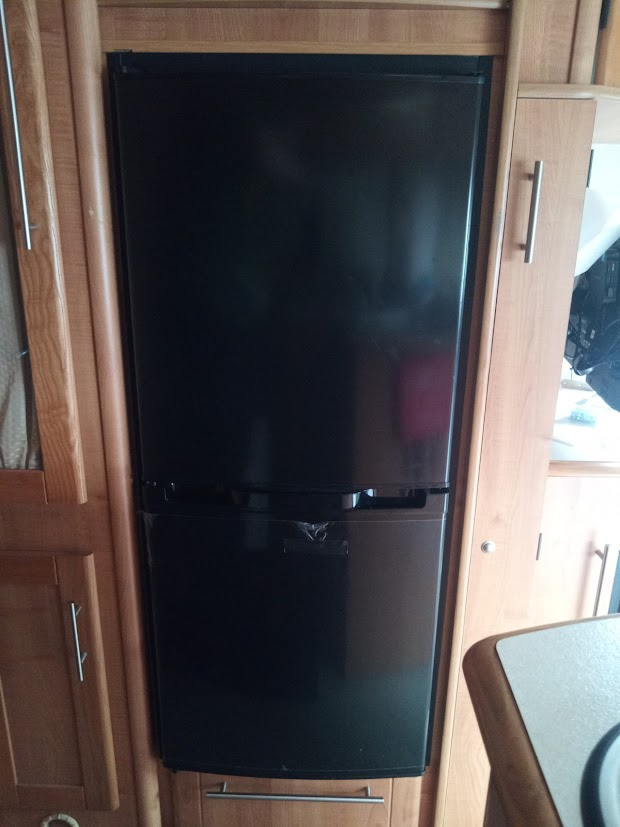

Good to see you managed to get a black one - looks like it's always been there.
Neat job!
I think it looks "proper" :D I am think maybe pull off the "LEC" badge as Motorhome fridges seem to have no branding on them nowadays?

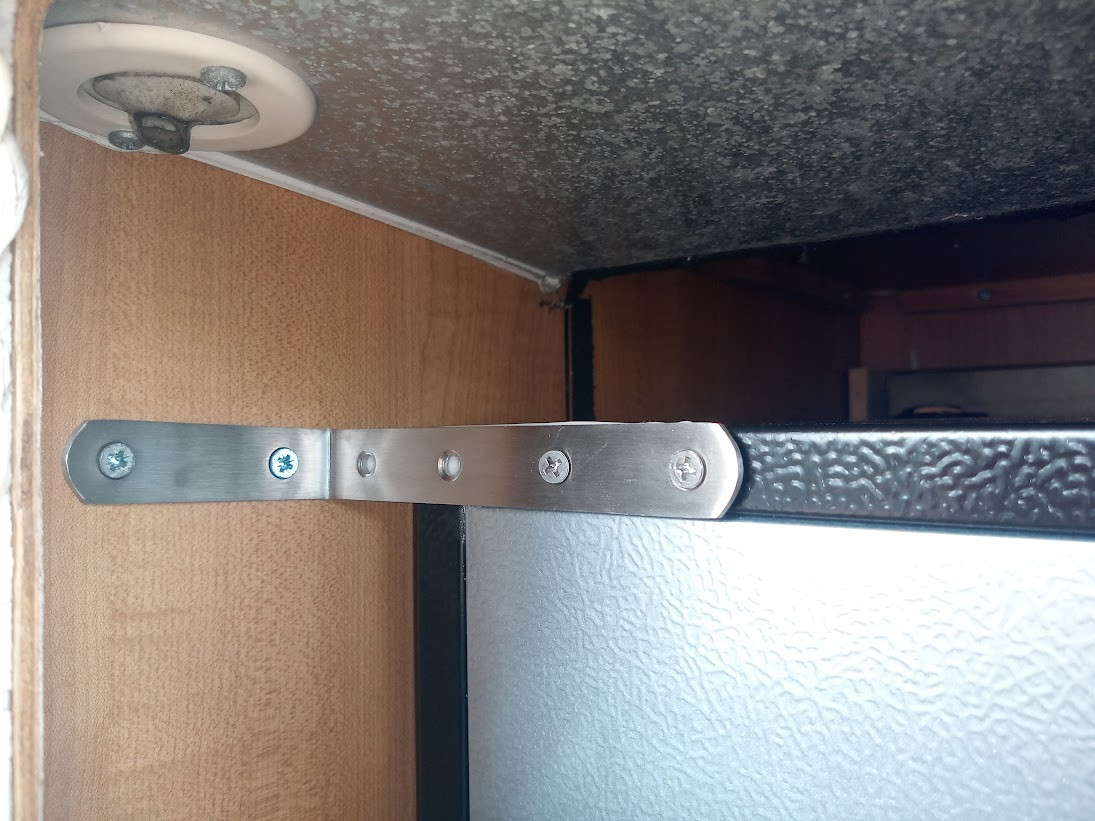

Brackets arrived today so completed the securing of the fridge at the rear now on the top side.
Used VHB tape on the fridge housing, and some extemely short self-tappers into the case to add some mechanical security so nicely locked into place.
And Fridge trim cut to size and offered into place ready for final securing once the new top door-lock mount arrives.
Sits nicely in the old Thetford hole.

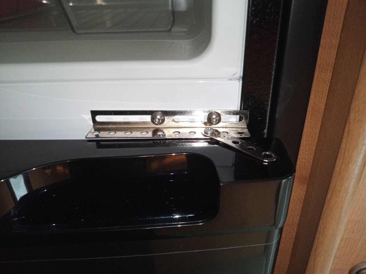

The top and middle hinges arrived to modify into locks :)
Unfortunately they were both for a different fridge :(
Modified the top hinge fitting enough to work I think (it better! seller won't want to take it back with various holes drilled into it :D ) . But the middle one is going to have to go back so need to make one myself I think.
Got the locks sorted out, even if at least temporarily for the bottom door.
Got limited clearance in the gap between the two doors and had a play with some knock-off "meccano" from B&M Bargains ....
It turned out to work very well so at least I have a template to work with for something permenant

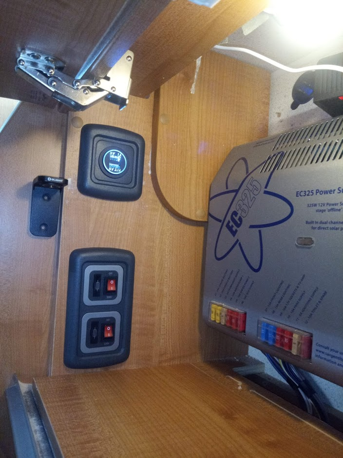

Reworked some electrics following the changeover from the 3-Way to the Compressor Fridge ...
I had installed a couple of AC Spurs a few months ago - one for the Water Boiler and one for the Fridge
These are controlled by the Cerbo GX and have power to them based on various conditions (EHU Present, SOC and AC load levels). I then turned on each spur (top to Boiler, bottom to Fridge) depending on what load I wanted to run off Electric (rather than Gas).
Now I have a 240V Compressor Fridge I want power to that to be always available, so rerouted the Fridge line to connect back to the default Supply out the Sargent unit - but with a slight twist ... still routed through an SSR (Solid State Relay), but for the fridge I control the SSR via the BMV-712 Relay. I don't intend to use any programming to switch the Fridge supply on and off, but it is just a way to be able to remotely turn the fridge off and on if I find I won't be using it for a while, or if off and I decide to I am going out in the van the next day I can turn it off or on from the house using VE.Connect via VRM :)
Maybe a bit of a gimmick, but the wiring and options were there so thought "why not" :D
The Water Boiler I still want to have the orginal level of control, but if I am specifically controlling the Fridge On and Off via the BMV Relay, I don't want the Switched Spur so removed it.
That left a hole so would to do with it? Well, thought may as well fit an 13A Socket :)
This outlet is controlled in the same way as the AC Spur above, with the various Cerbo GX conditions coming into play, which is fine.
I have a couple of potential uses for this outlet, including for example a laptop charger (I store the laptop and charger in one of the lower cupboards and this would allow me to also charge it in situ (y)

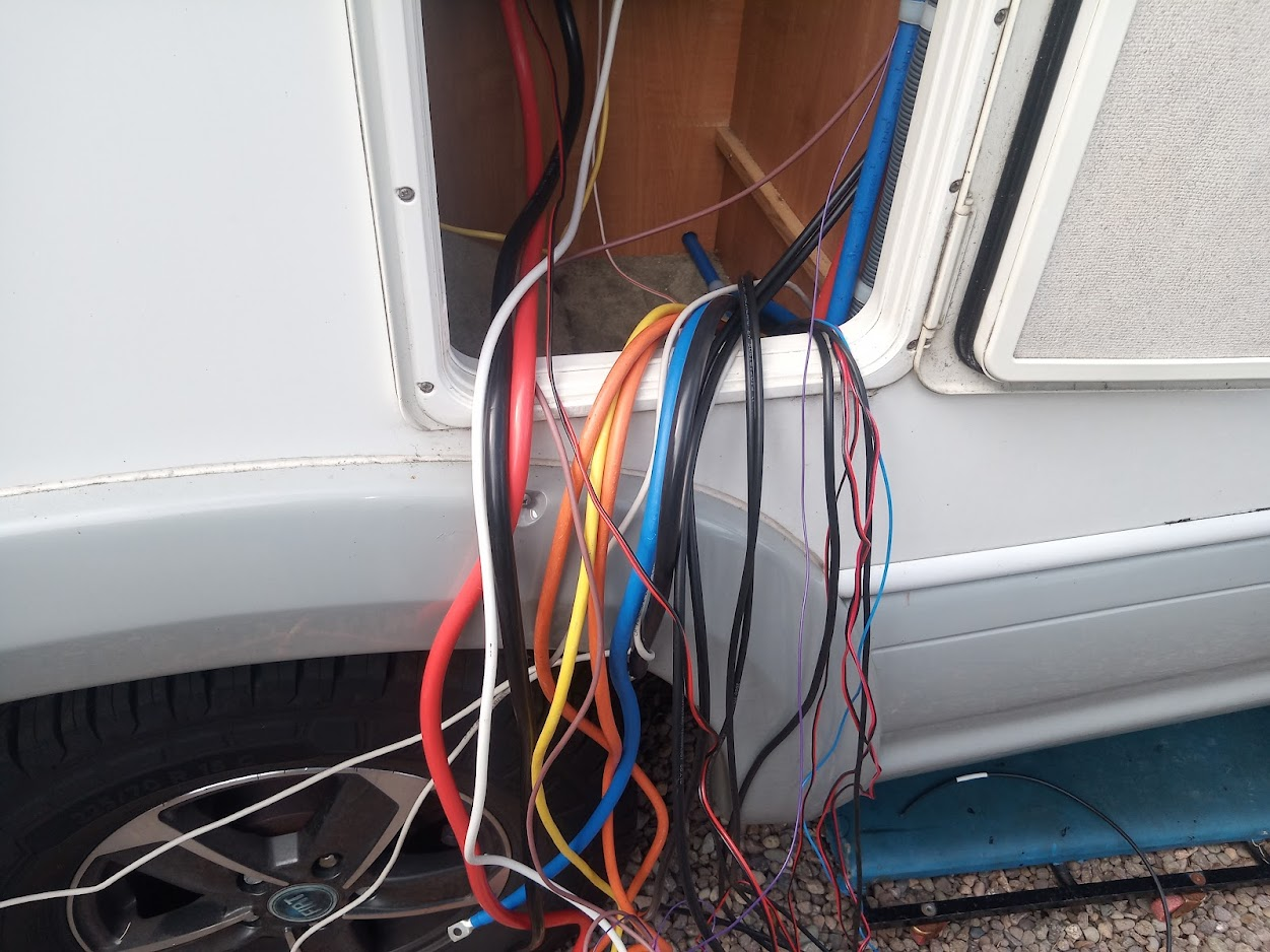

Step one was to rerun all the cabling in preparation ....
It may not look like it, but this is pretty well the "after" shot :oops:
There are a few more cables to relocate which will be done in a few days time.

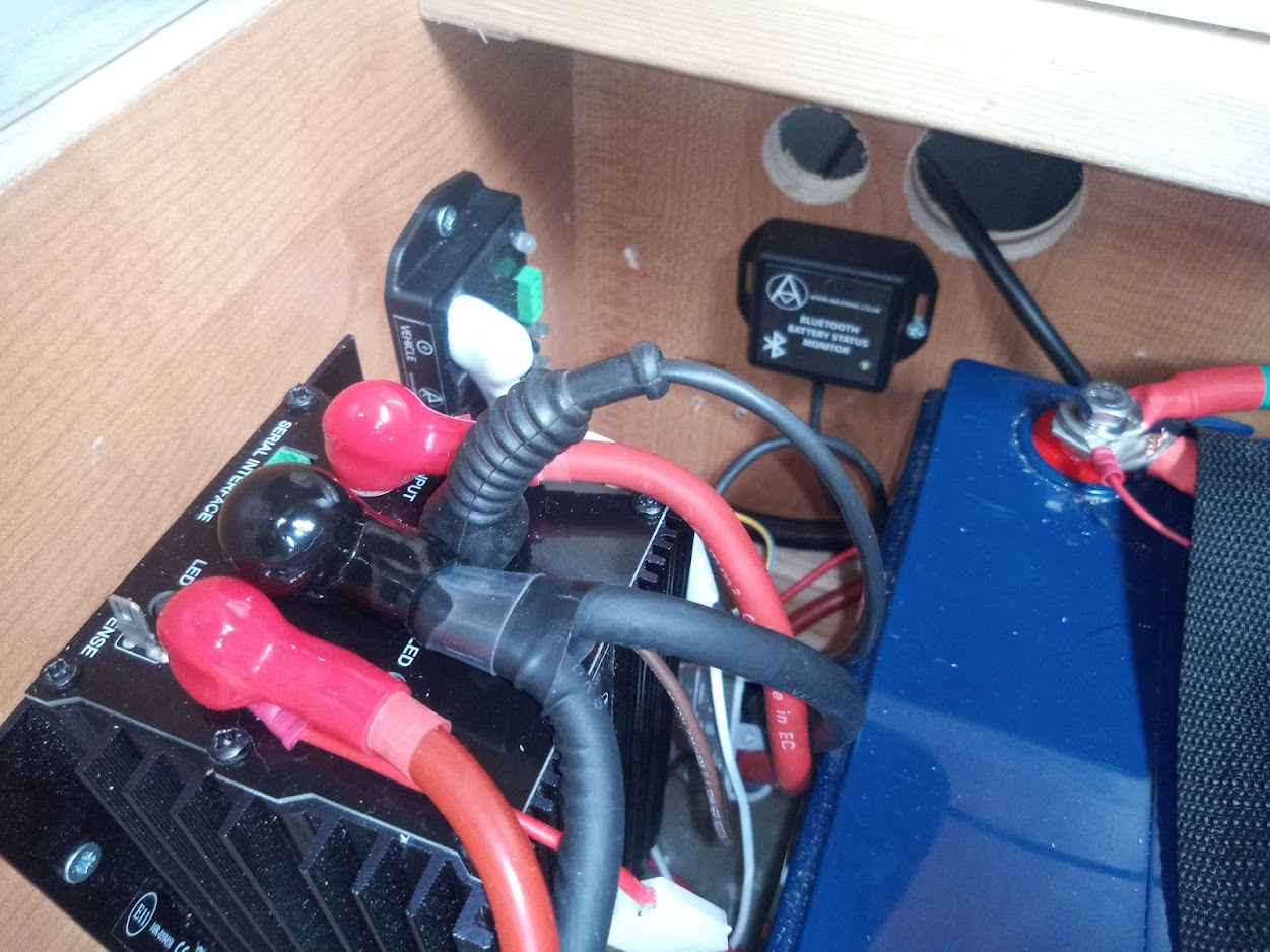

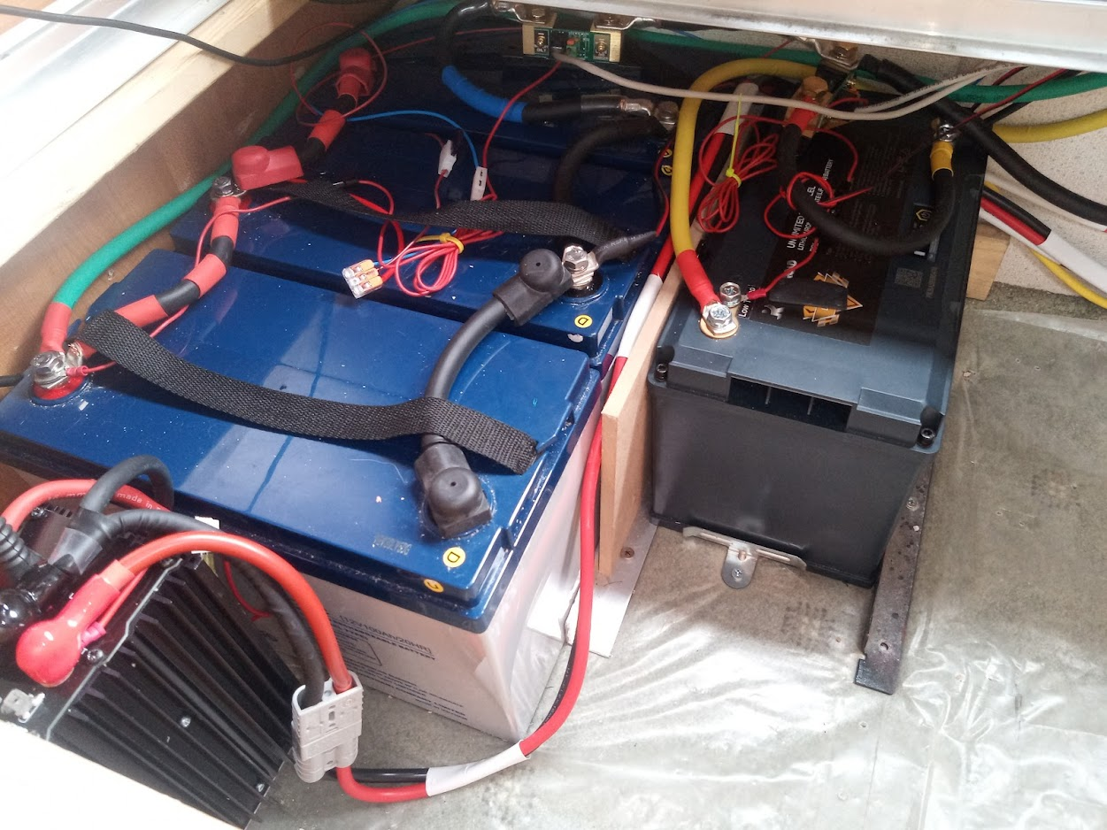

Battery Bank location adjusted. Still using the under-sofa storage but repositioned the Lead Carbons to be both against the front and get some of the weight more in the centre (L-R centre that is).
The Lithium Battery is against the Leads but positioned lengthways. The reason for this is two-fold. It keeps the storage area to the rear a little squarer in space; and it will also let me add a potential second Lithium end on with cabling that would be very straightforward to adapt by just adding a pair of battery interconnects and moving the current -ve cable to the additional battery (cable already sized ready for this).
So the 3 PbC (Lead Carbon) Batteries are set up in parallel in a regular way. The -ve is connected to a dedicated Shunt for a BMV-700.
The LiFePO4 (Lithium) -ve is connected to its own BMV-700 Shunt and the two Shunt LOADs are then connected to a 3rd Shunt which is for a BMV-712.
The +ve's for the Batteries are setup in a slightly unusual but flexible way.
In the picture above you can see a Green cable coming off the PbC Battery Bank; and a Yellow cable of the LiFePO4 Battery. I decided to colour-code them for easy future identification when I have forgotten what I have done and can refer to the wiring diagram (that I always initially do for future reference but forget to update usually :( )
The Green and Yellow Cables go to a Isolation Switch that has two inputs and one output.
It is always a good idea to have an isolation switch between the Battery Bank and the Loads & Chargers. In this case, as well as having that switch in situ, using a 4-position switch meant that I could do any of the following:
OFF: disconnect all the Batteries
1: Use the LiFePO4 Battery on its own
2: Use the PbC Battery Bank on its own
1+2: Use both PbC Bank and LiFePO4 Battery as a parallel Hybrid bank. This would be the standard operating mode and also is very simple way to get the two battery types cabled up in parallel.
