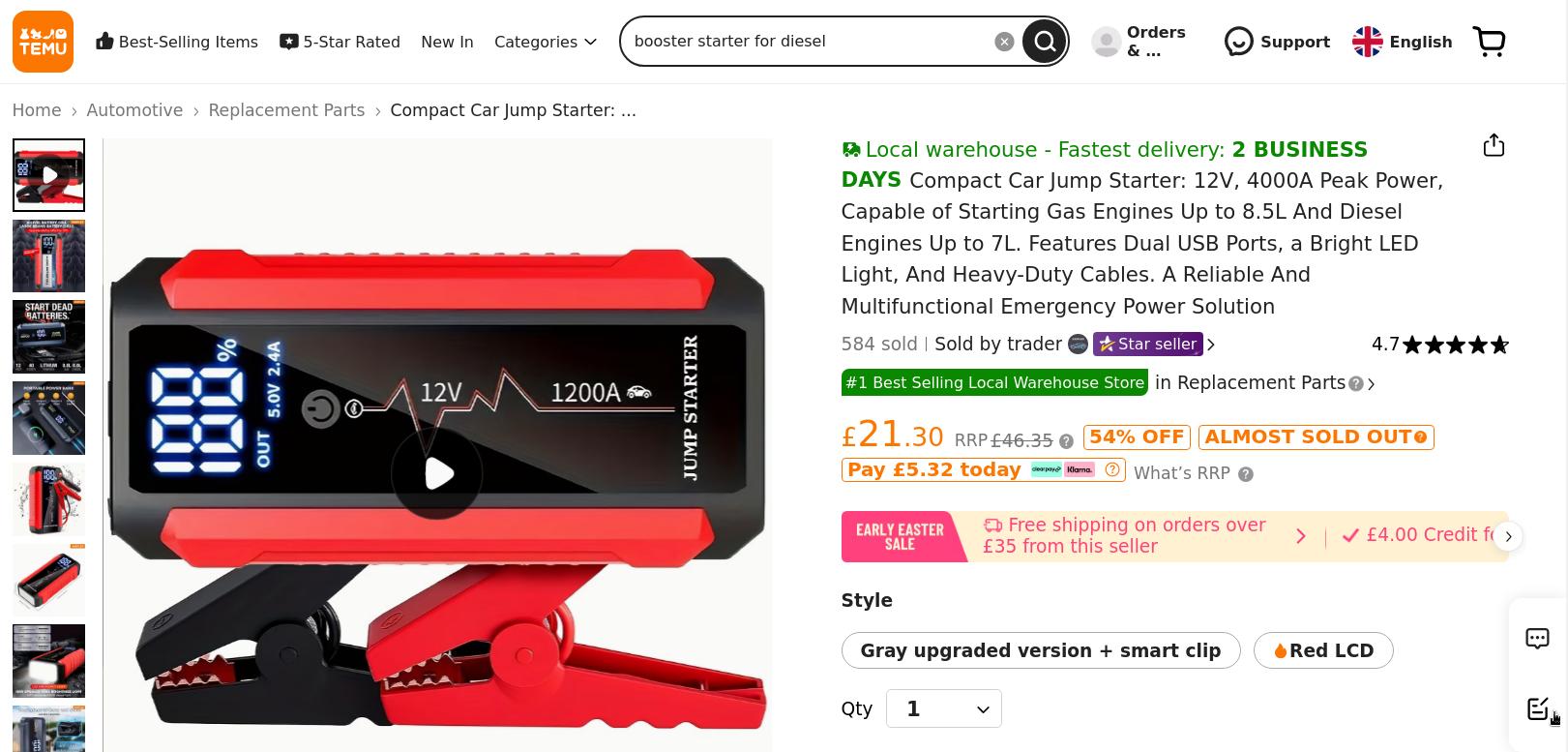

One of these is handy for that, i carry one, good to kick a battery above voltage and start up.
