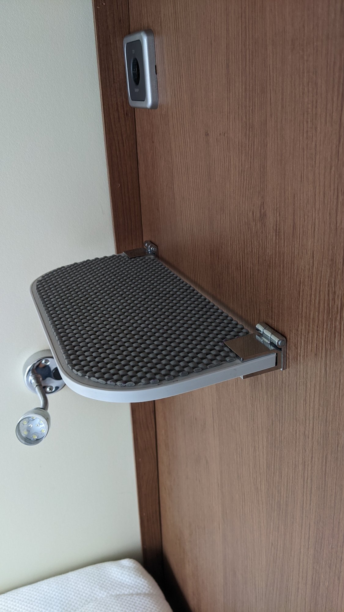

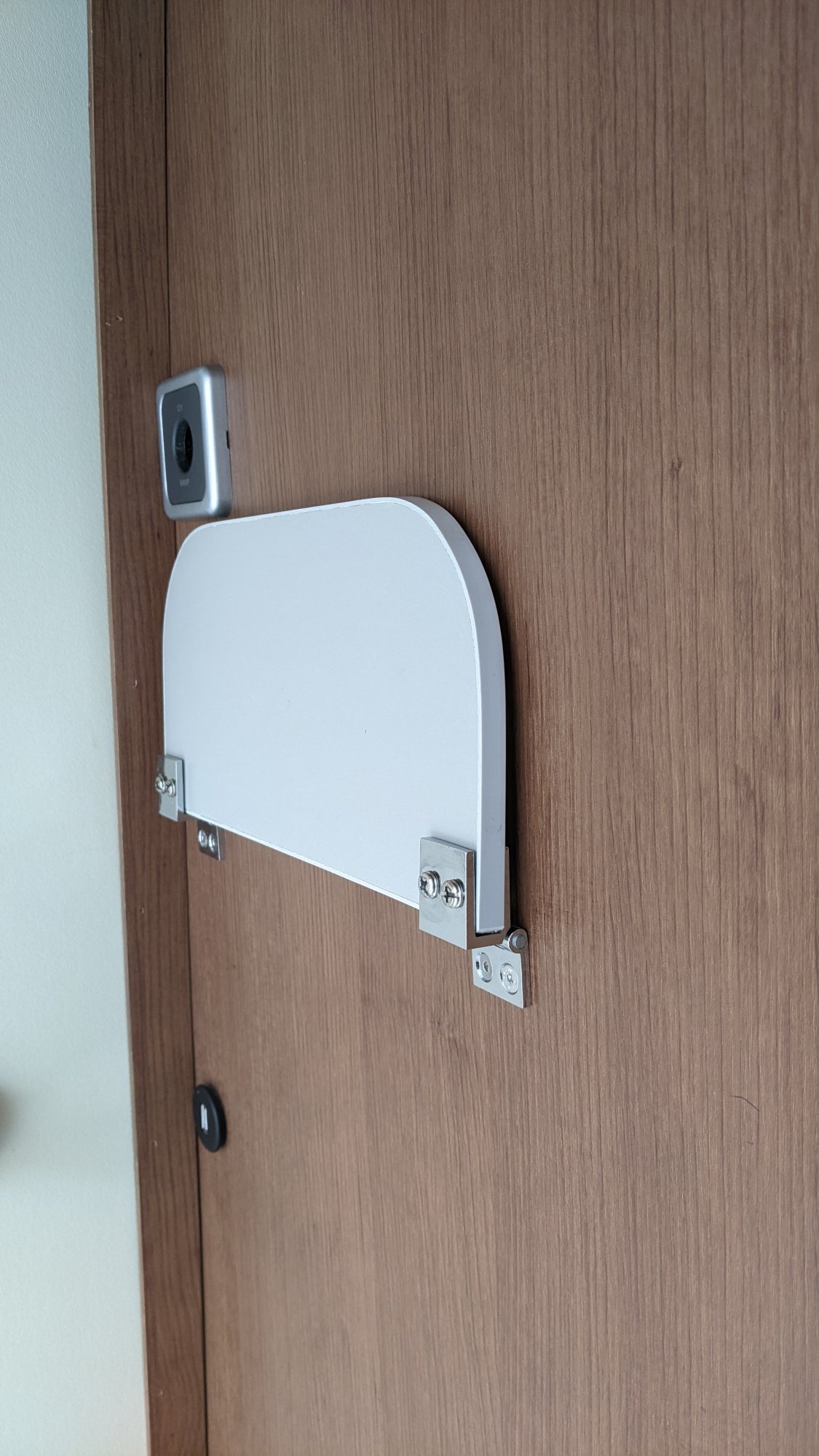

You can also do it without any lip at all, here's our fold down bedside 'tea shelf ' . No lip, just fix the plastic strip over size and then router it off flush with the 2 faces of the board. Obviously edges have to be 100% chip free though.

You can also do it without any lip at all, here's our fold down bedside 'tea shelf ' . No lip, just fix the plastic strip over size and then router it off flush with the 2 faces of the board. Obviously edges have to be 100% chip free though.View attachment 125170View attachment 125171

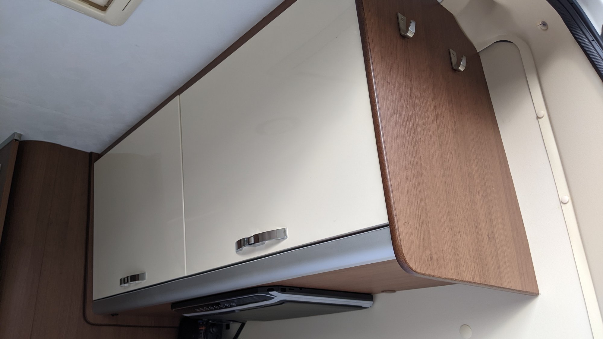

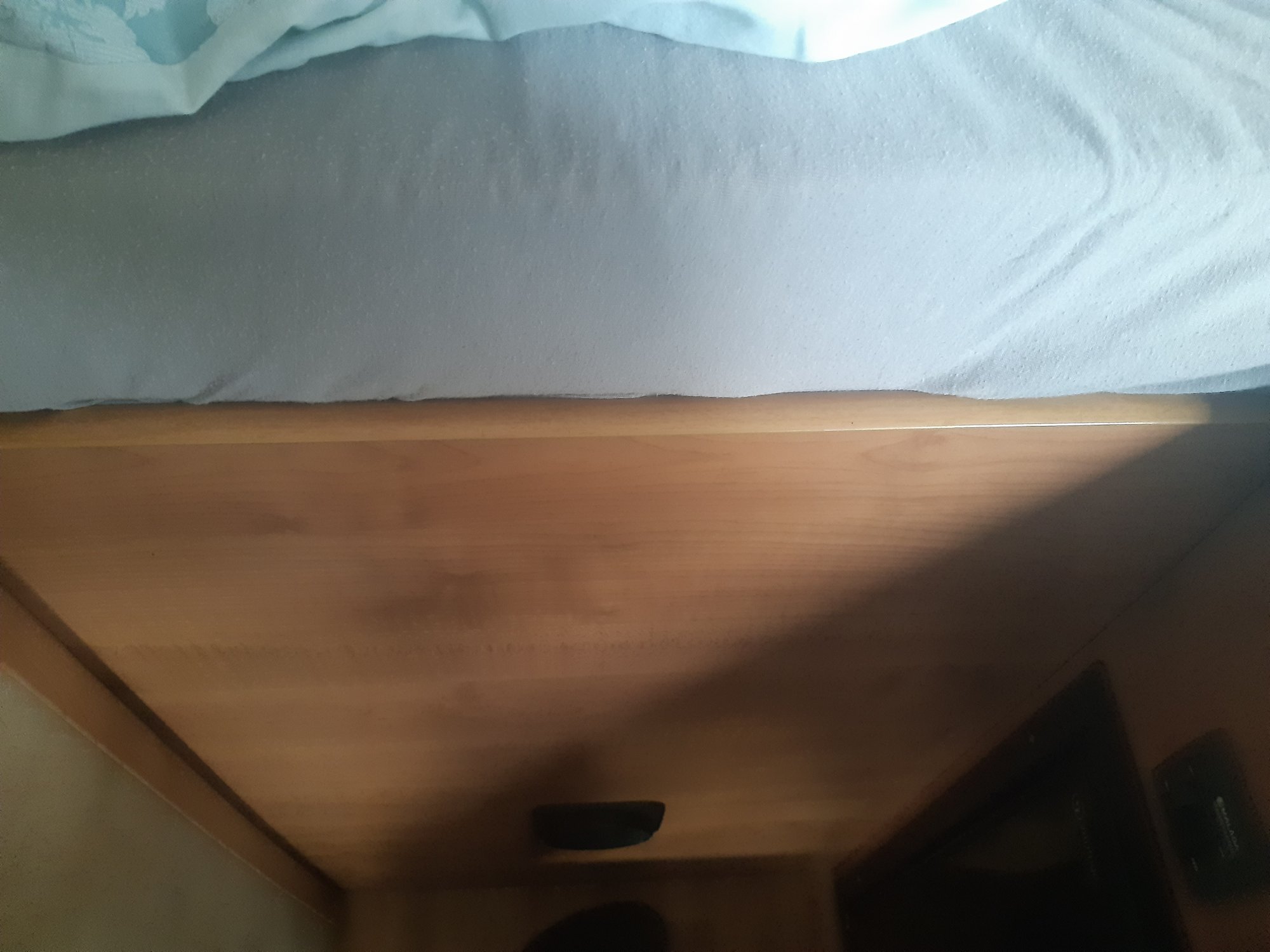

Some pretty crap photo's here as our van is full of 'stuff' at the moment but hopefully you can see the T-trim along the top of the panel on the side of our bed;

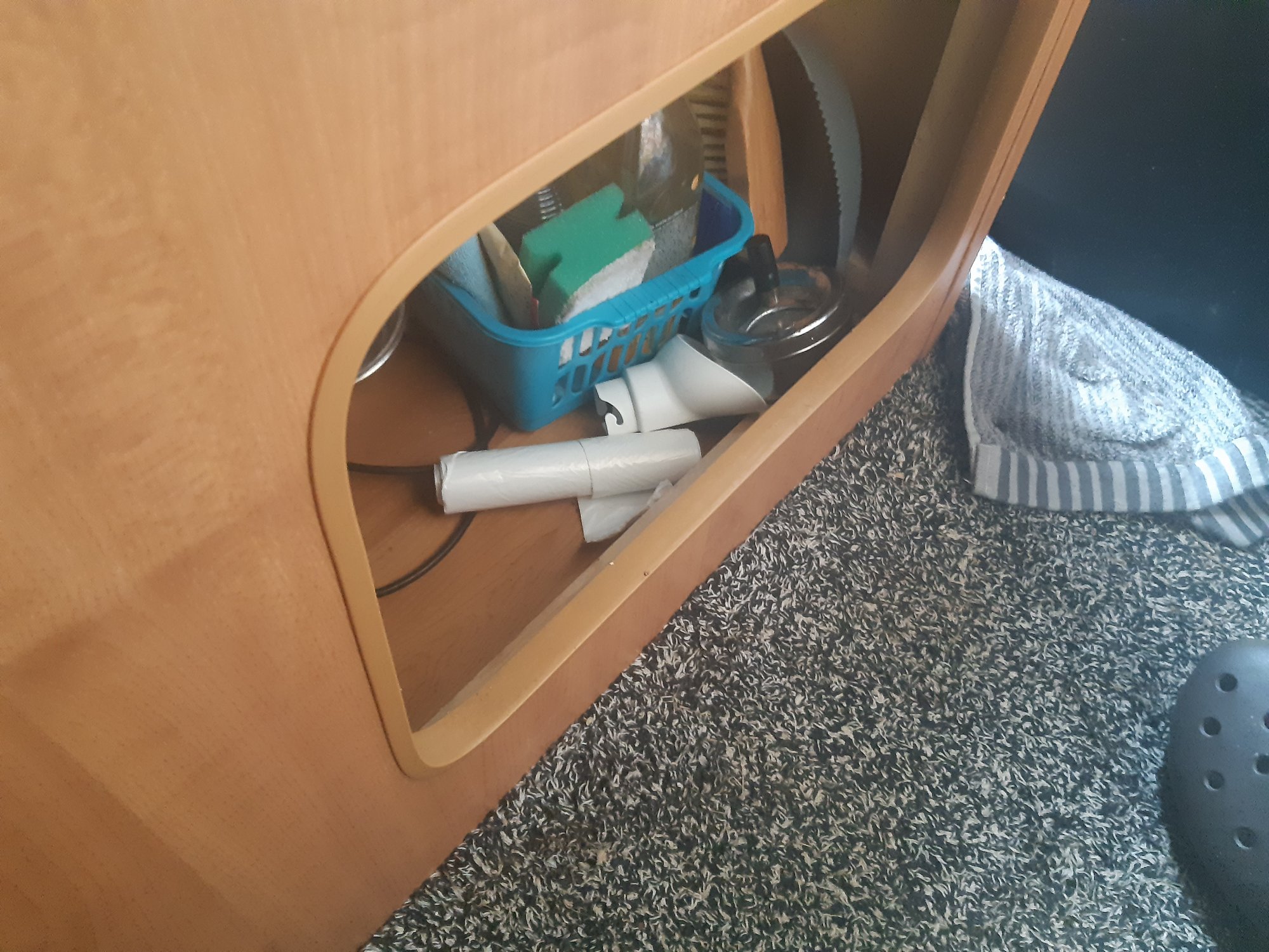

And in the small cupboard entrance under the cooker I have used the push on trim in the aperture for which no router is needed;
Can I ask where you got your shelf brackets from please?

Originally got them from ebay a while back but the seller doesnt exist now. I did an image search for you though and here's some on amazon.

Looking at the ad I can see (I think) what a 180° hinge would do but not what a 0° hinge would, I would have thought that the ones you have would be 90°?
Sure, My shelf only moves through 90deg but only because it gets stopped by the cupboard panel above, if that wasn't there then I guess theoretically it'd go through about 270deg until the hinge bottomed out on it's self again but I don't think mine were called 270 degree anyway!
I know how hard it was finding them, I knew exactly what I needed and after much downloading of images and contorting myself trying to imagine how they folded up I ended up with those. The pictures look right to me, as long as you get the ones with the 2 screw holes and not the double glass ones I think you'll be OK.

Thanks Merl, I've now seen them advertised elsewhere as 90° so I think it was just a typo in that ad. One last question before I stop hijacking Bill's thread. :giggle: In the up position what stops the shelf from flopping down?
