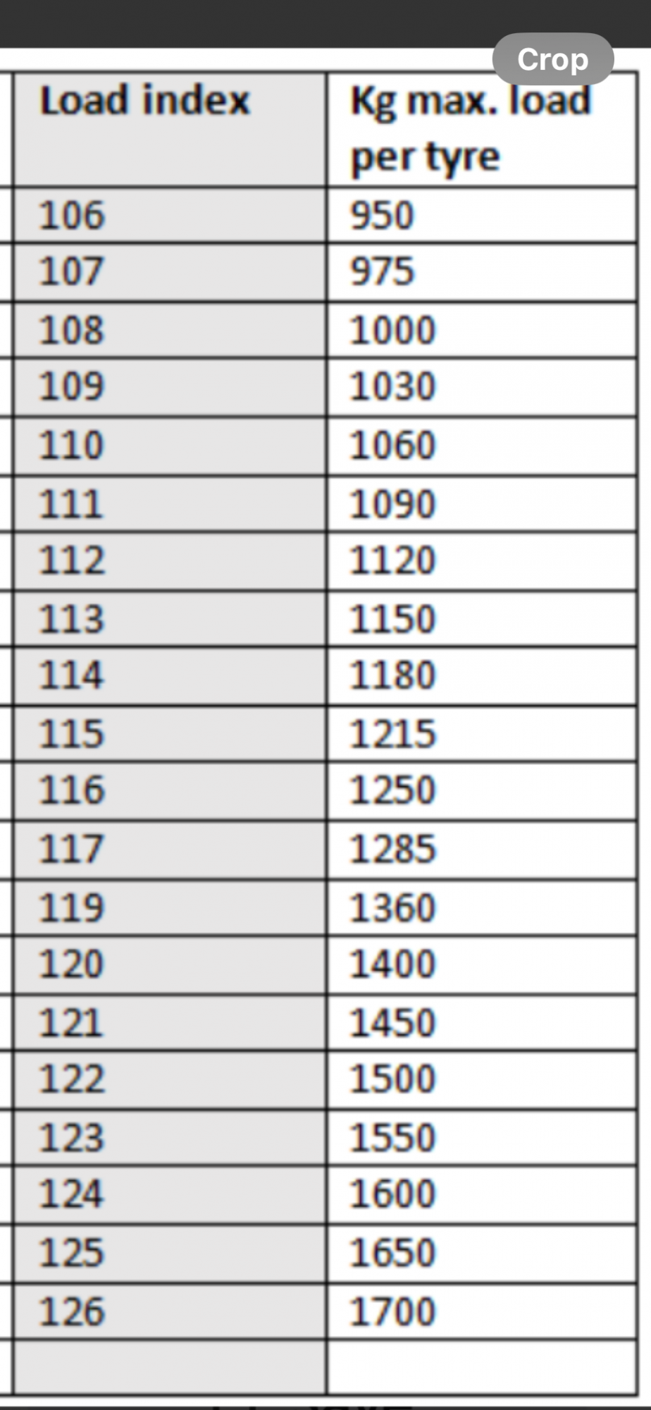

As ‘Mo’ has a fat arse coming in at around the 4000kg mark on the 4 tyres In my mind LOAD ratings have as much importance as All year round performance.

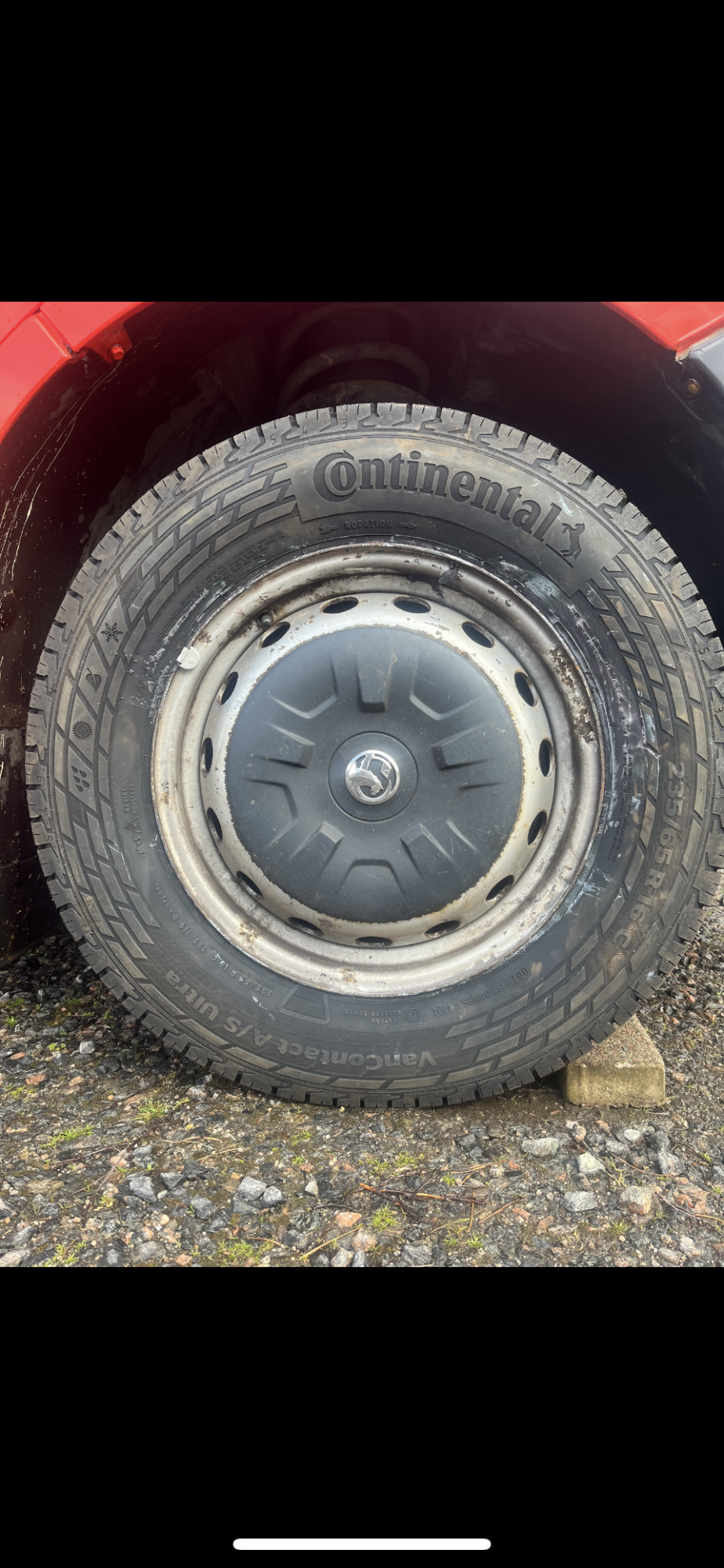

So I’ve gone for
Continental Tyers this time on 235/65/16 giving me a far greater max Load rating than the Aguilus Tyers of 121.
I have High pressure valves fitted run the tyres at 72psi on Front & 78psi on rear. That roughly gives me a load rating on the Front axle of 2300kg & the Rear axle of 2800kg ish on my 4000kg vehicle.
Had them on for a year or so now and are very happy
