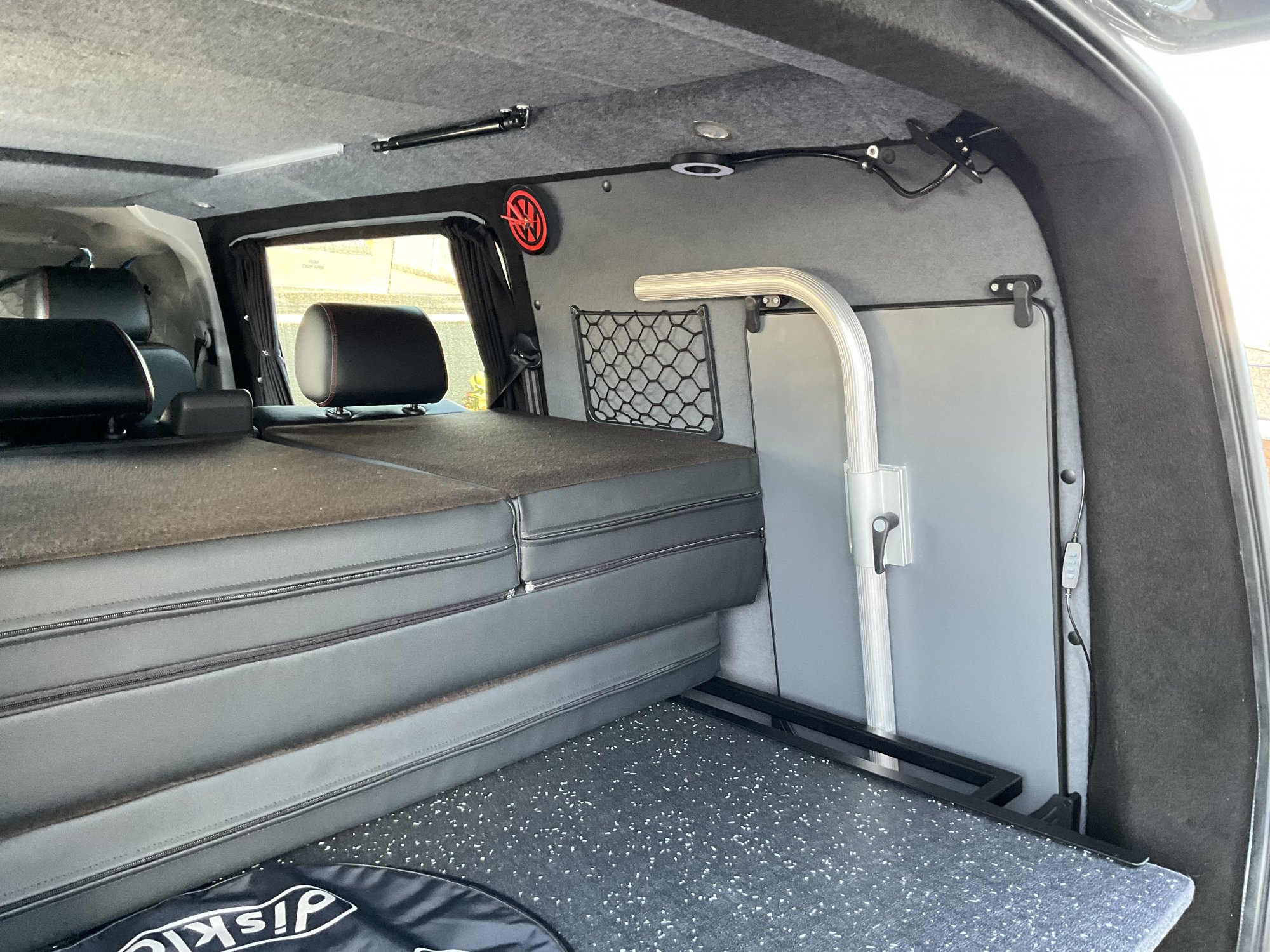

My new Transporter.

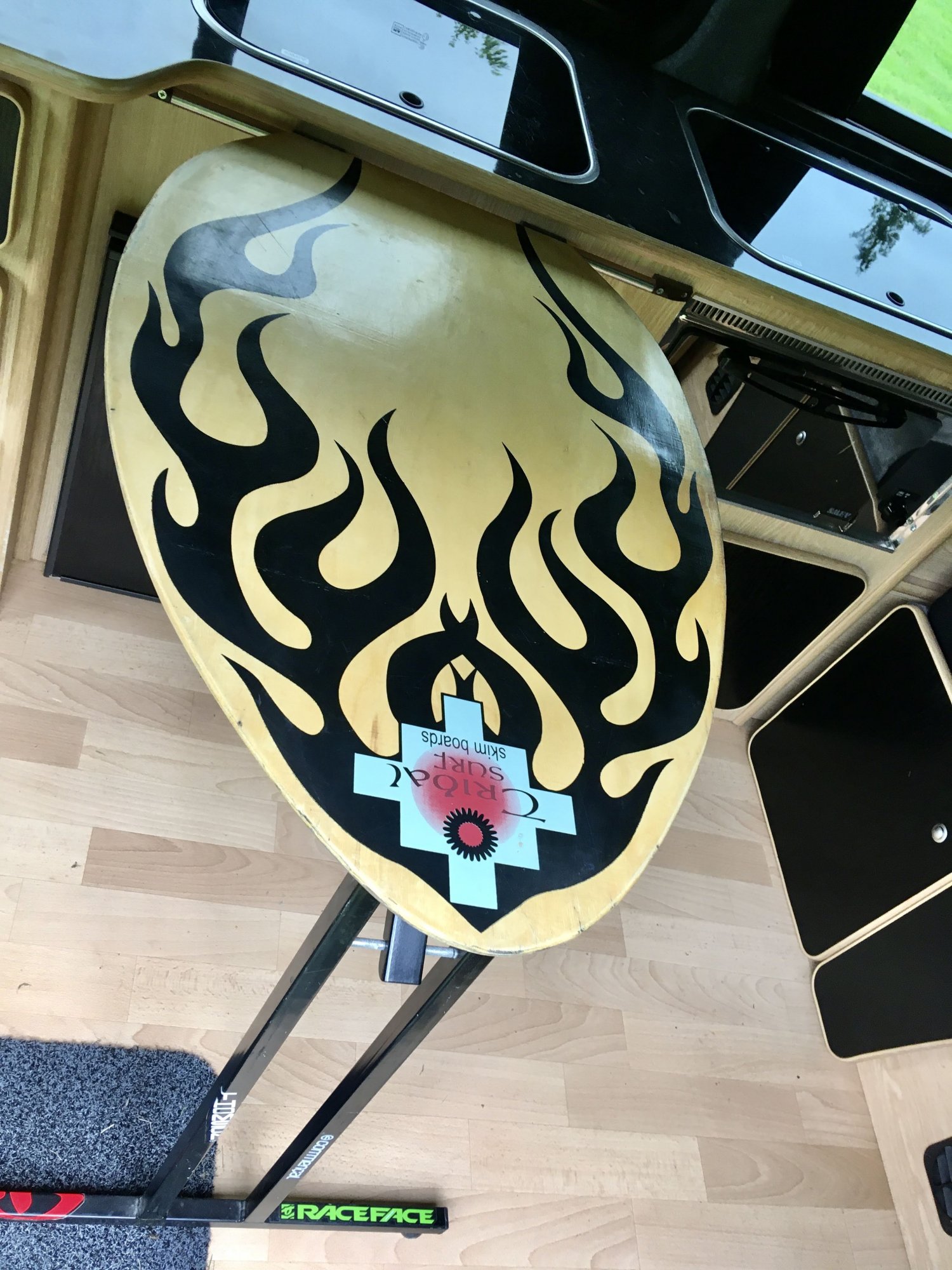

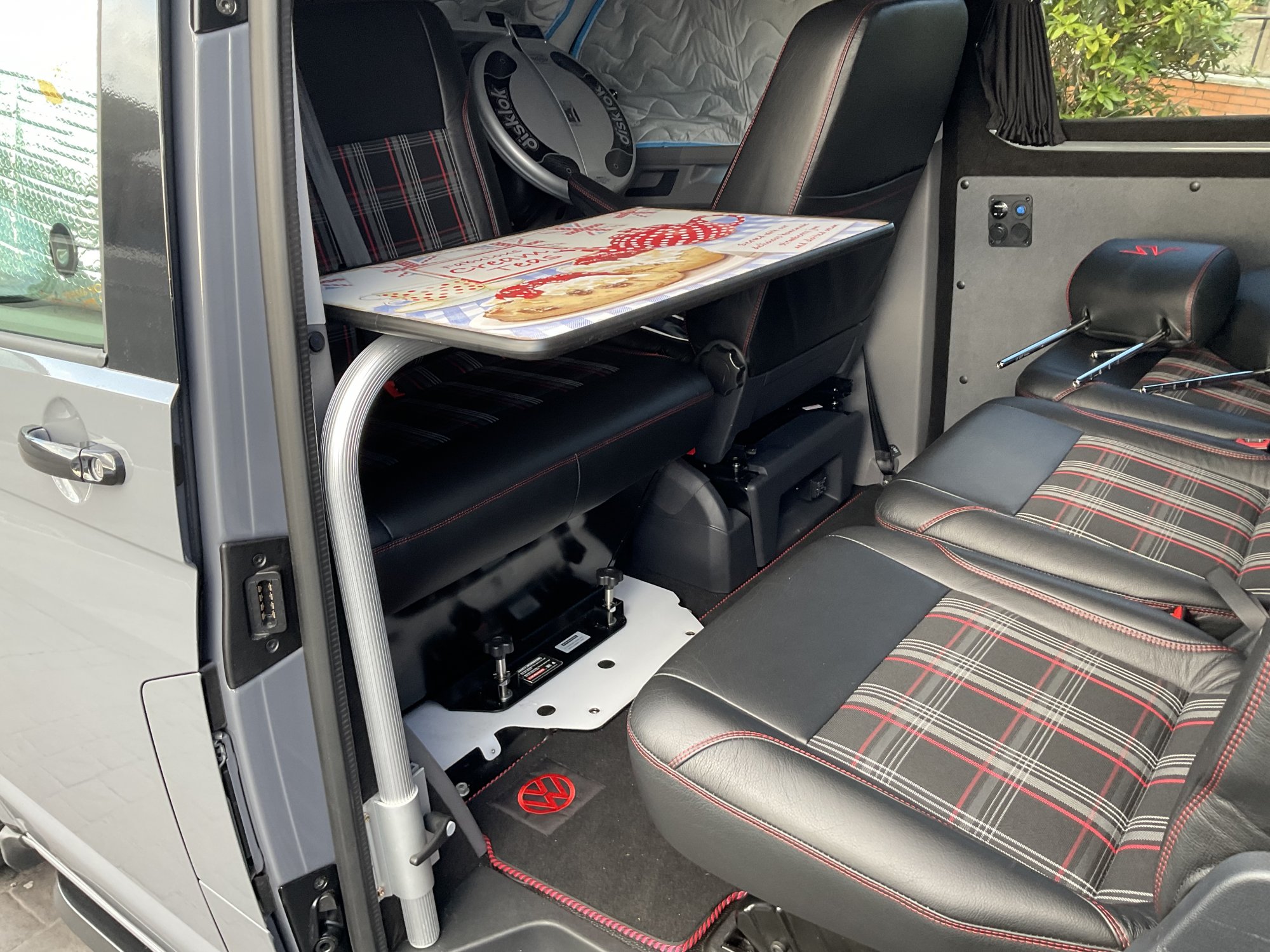

I’ve installed a cranked table leg with table top designed by Pat my wife and produced by Chippys workshop, also fitted table storage brackets in the rear.

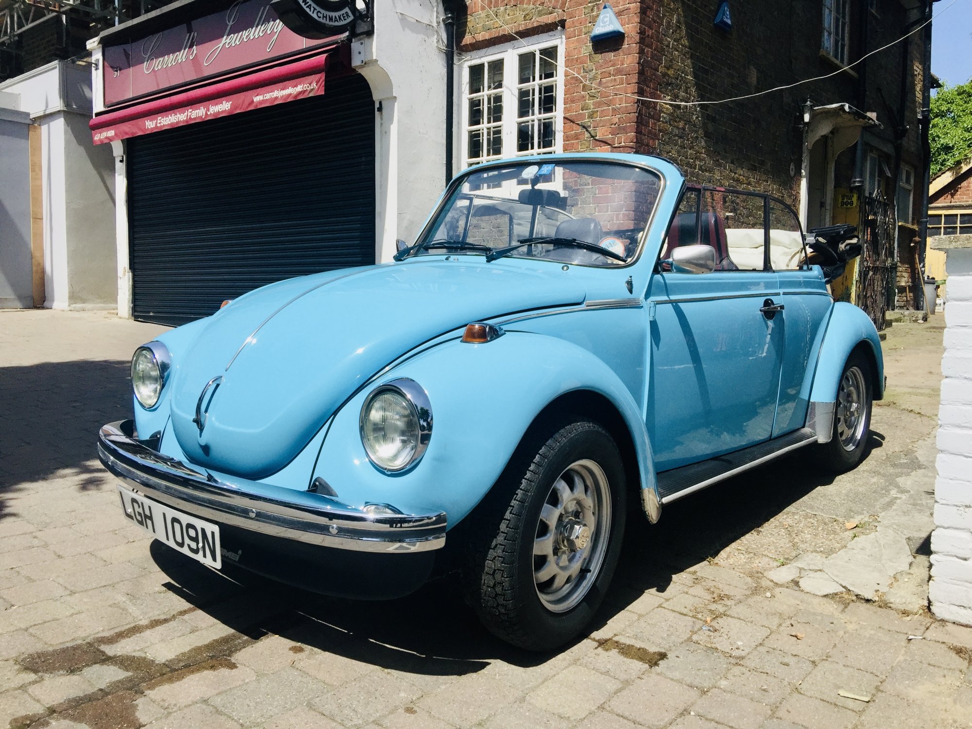

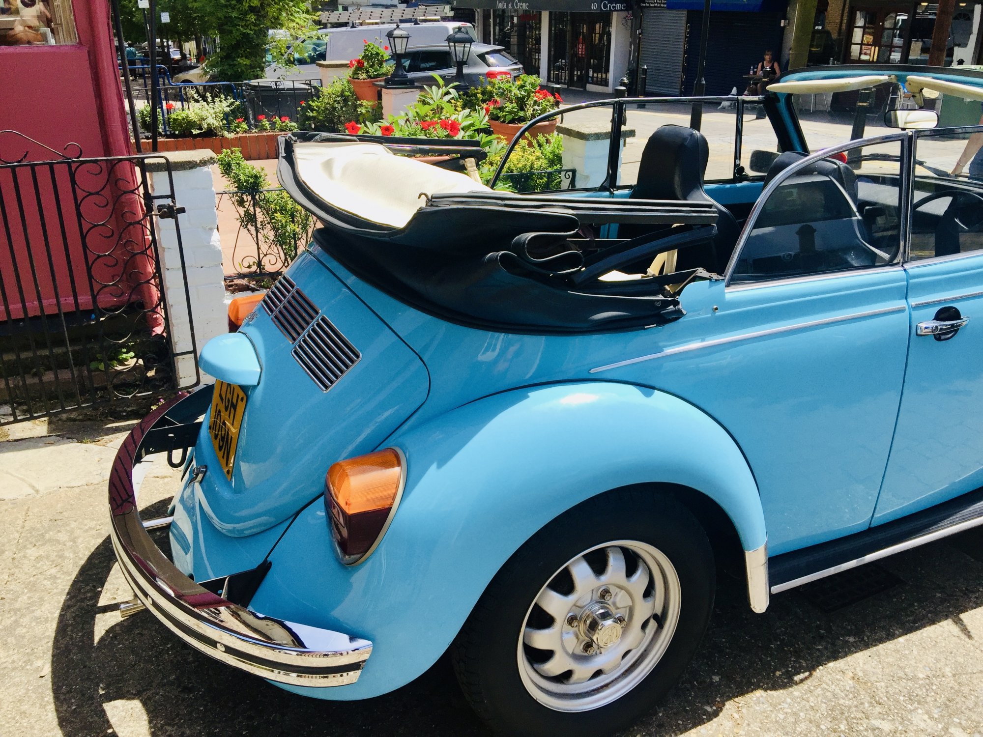

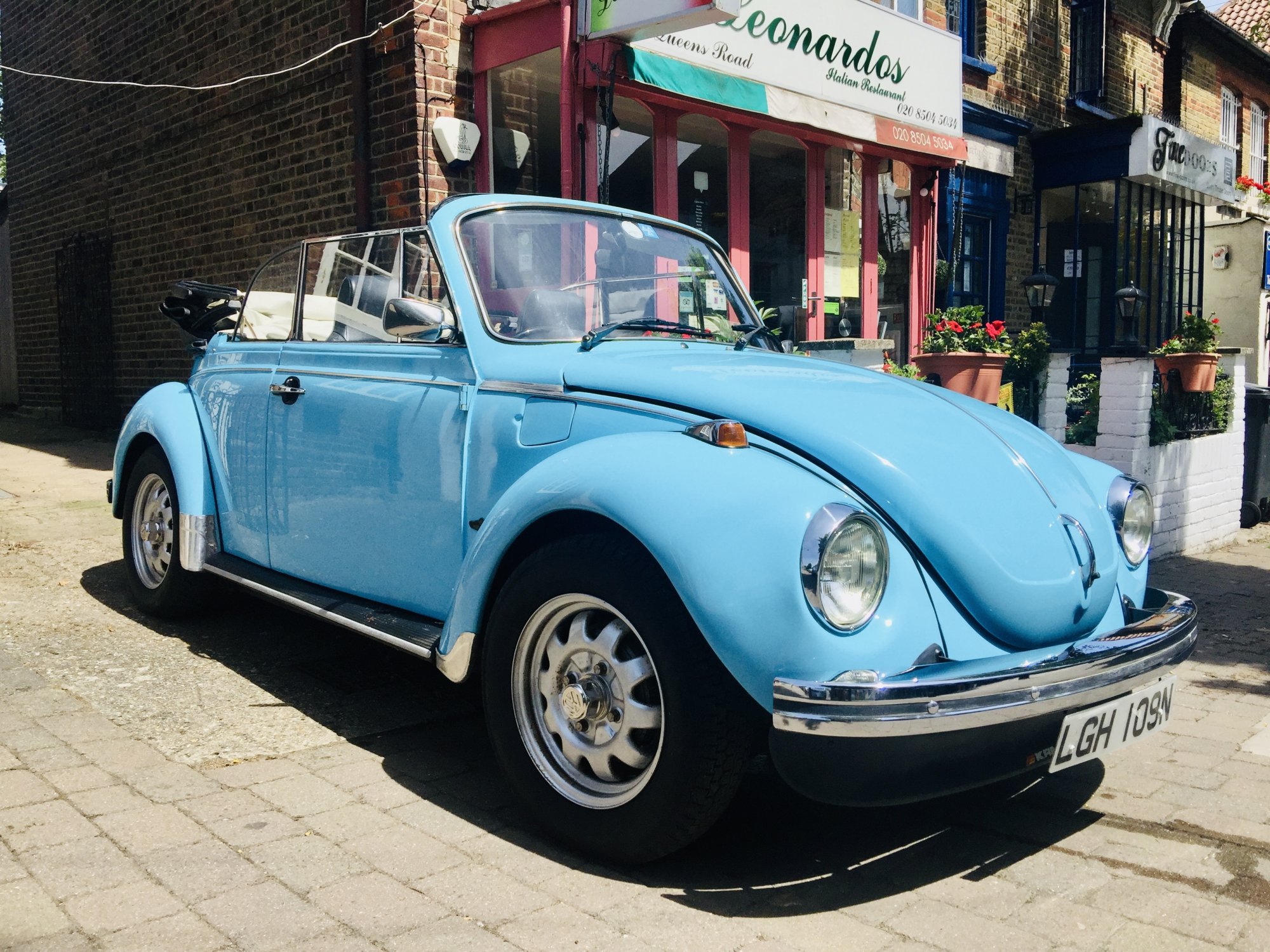

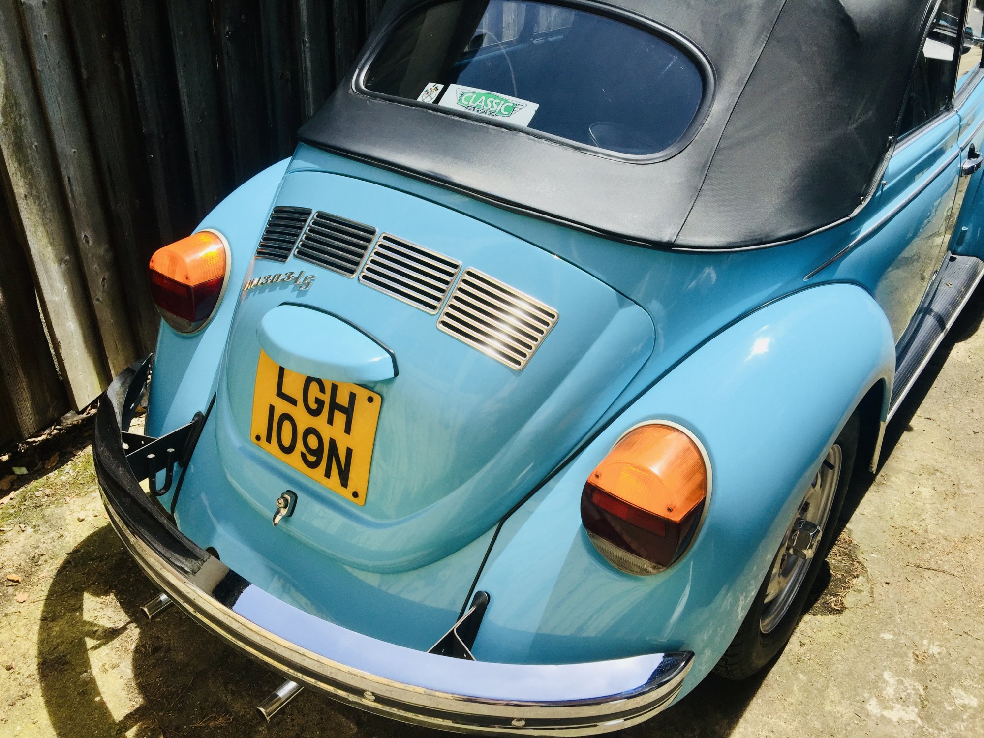

I have been a VW nut in the past but there's one I've had for 40 years which I can't bear to part with.

Outstanding example. Fantastic job!!👏🏼👏🏼👏🏼👏🏼
Those genuine VW stamped steel wheels which are as rare as rocking-horse £$%^ were made to commemorate something that I can’t remember. The small octagonal stainless steel hub caps are even rarer, they cost me £100 each at a “beetle bash” in 1985!

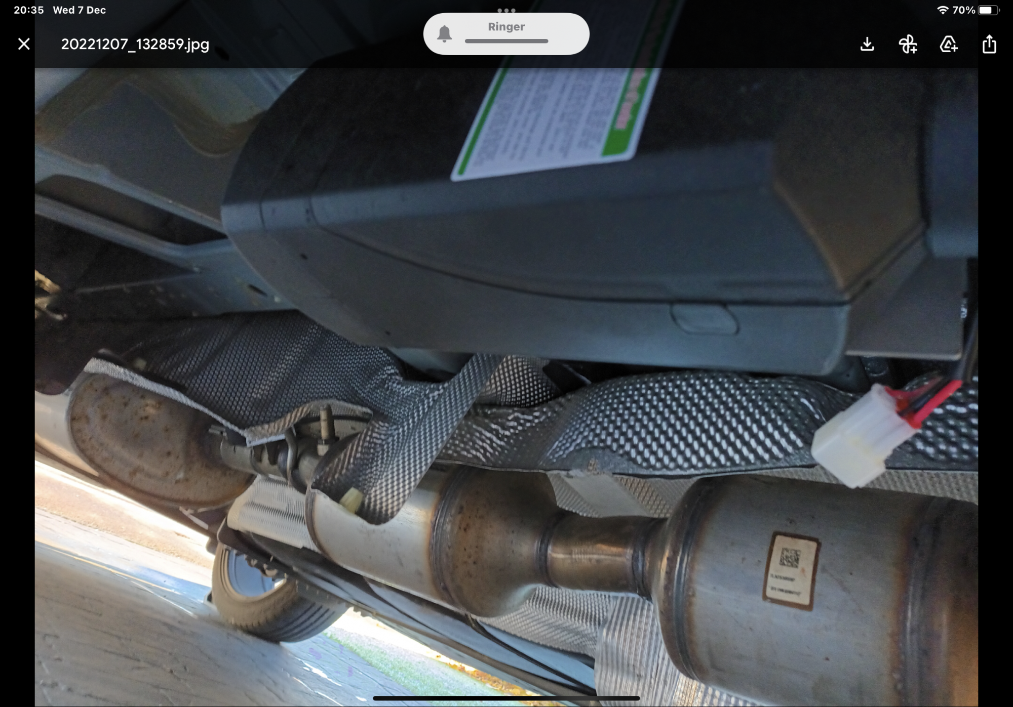

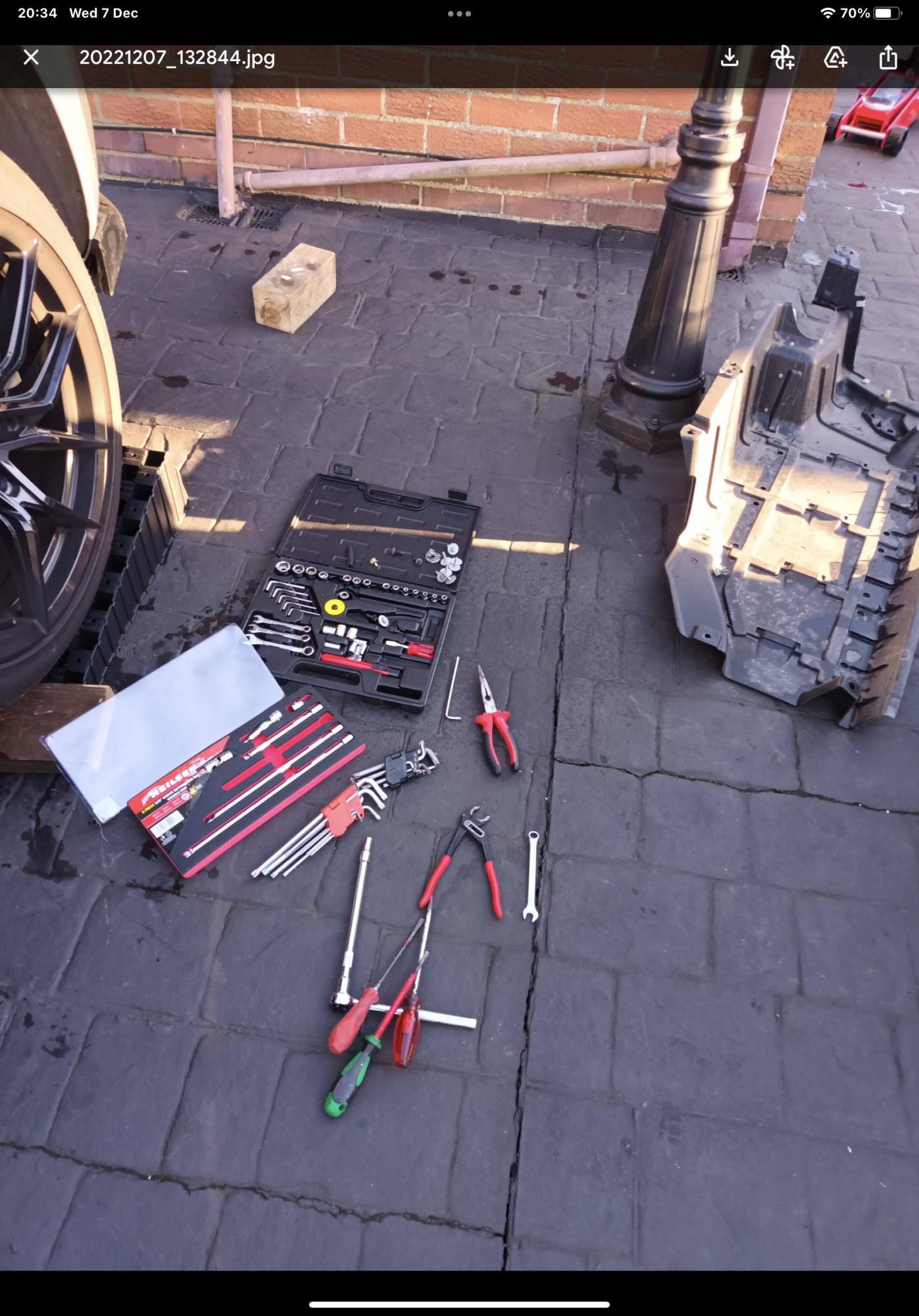

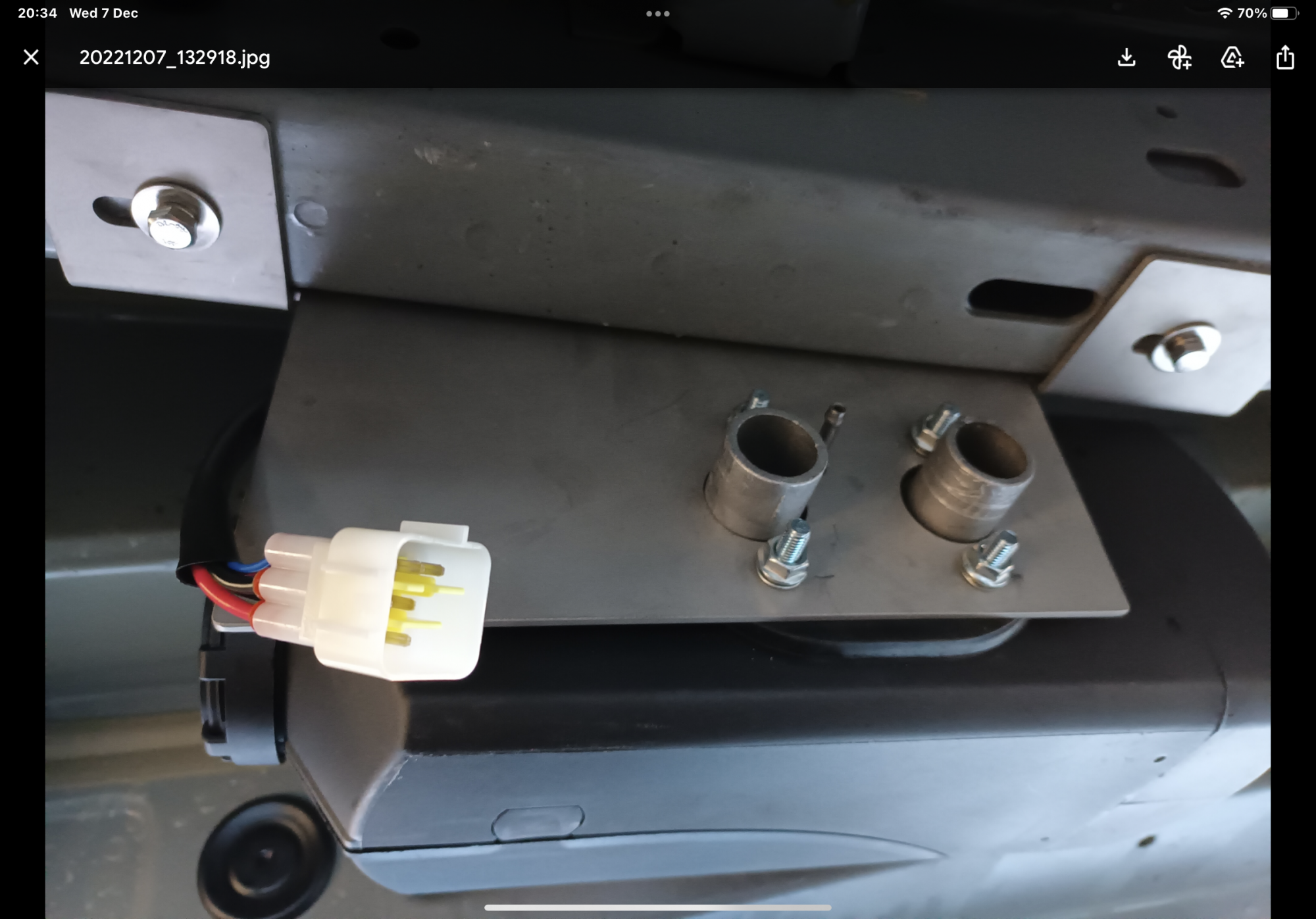

I started to fit my oriental diesel heater this afternoon, got the van front up on axle stands and levelling ramp, removed the plastic side under tray installed 6mm rivnuts and bolted the stainless steel plate up to chassis and mounted the heater. I bought the Eberspächer mounting plate and I had to elongate the bolt holes to marry up to my oriental heaters mounting threads. I have plenty of time so I’m not rushing the install will be doing it as and when the weather permits.
