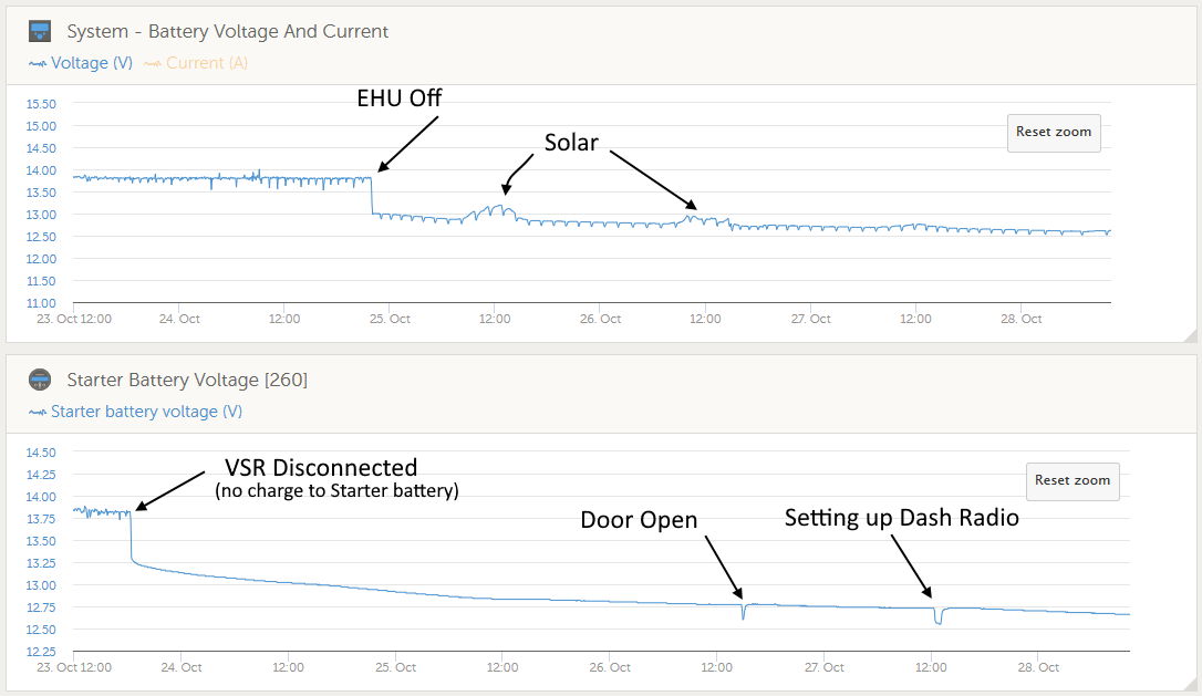

As it happens I am just prepping for another test on this area :D I've disconnected the bi-directional Cyrix-CT VSR and am keeping an eye on how the Starter Battery voltage is decaying.
A very smooth decline there (the Battery is new since around July this year and is a fairly nice unit). because it is so smooth it is possible to clearly specific events but there is certainly a constant power draw visible.
In the next day or so I will be fitting a prototype programmable Starter battery trickle charger (similar to a Battery Master, but with more features and capability) to see how that manages the starter.
