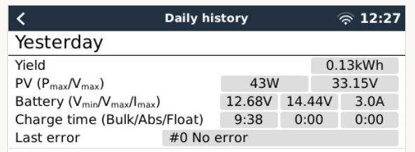

Since we are posting some history and yesterday was quite a dark day Vs Today (so far anyway)
Here is my yield yesterday
So from TODAY 27/10/2019 Yield will be less all over UK due to the clocks going back so would be interested to see Today's Yield Vs Yesterday's longer Day yield

.... So from TODAY 27/10/2019 Yield will be less all over UK due to the clocks going back so would be interested to see Today's Yield Vs Yesterday's longer Day yield
Interesting comment. not something I have thought of actually. clocks going back would actually mean today is 25 hours long so a longer day. but as the extra hour is in darkness, does it actually matter? intriging :)
