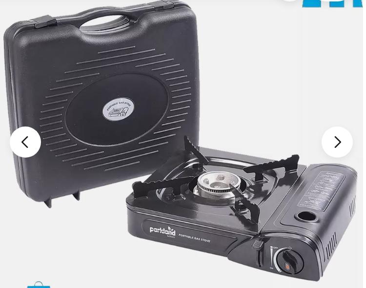

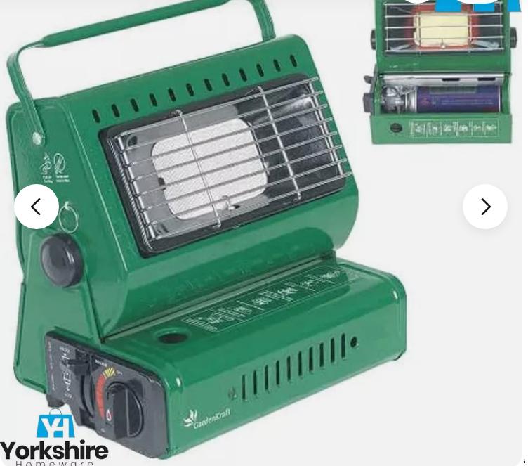

If you go all electric its handy to have a gas tabletop 2 ring cooker or a we gas oven that i have which runs on canisters.
I keep one of the camping stoves in the van as well.
I used it around 7 years ago one evening as the new chinese diesel heater failed (surprise surprise) so put that one for around 10 minutes to make a couple of drinks instead of using the induction hob to warm up the interior. (It just shows how inefficient gas hobs (and gas ovens) are compared to using electric when the wasted energy from boiling a kettle will warm a room up!).
I think the next time I used it was actually in the house when we were without electricity for a couple of days following Storm Arwen.
Always useful to have some kind of backup system, but it doesn't have to be a fully plumbed in system.
